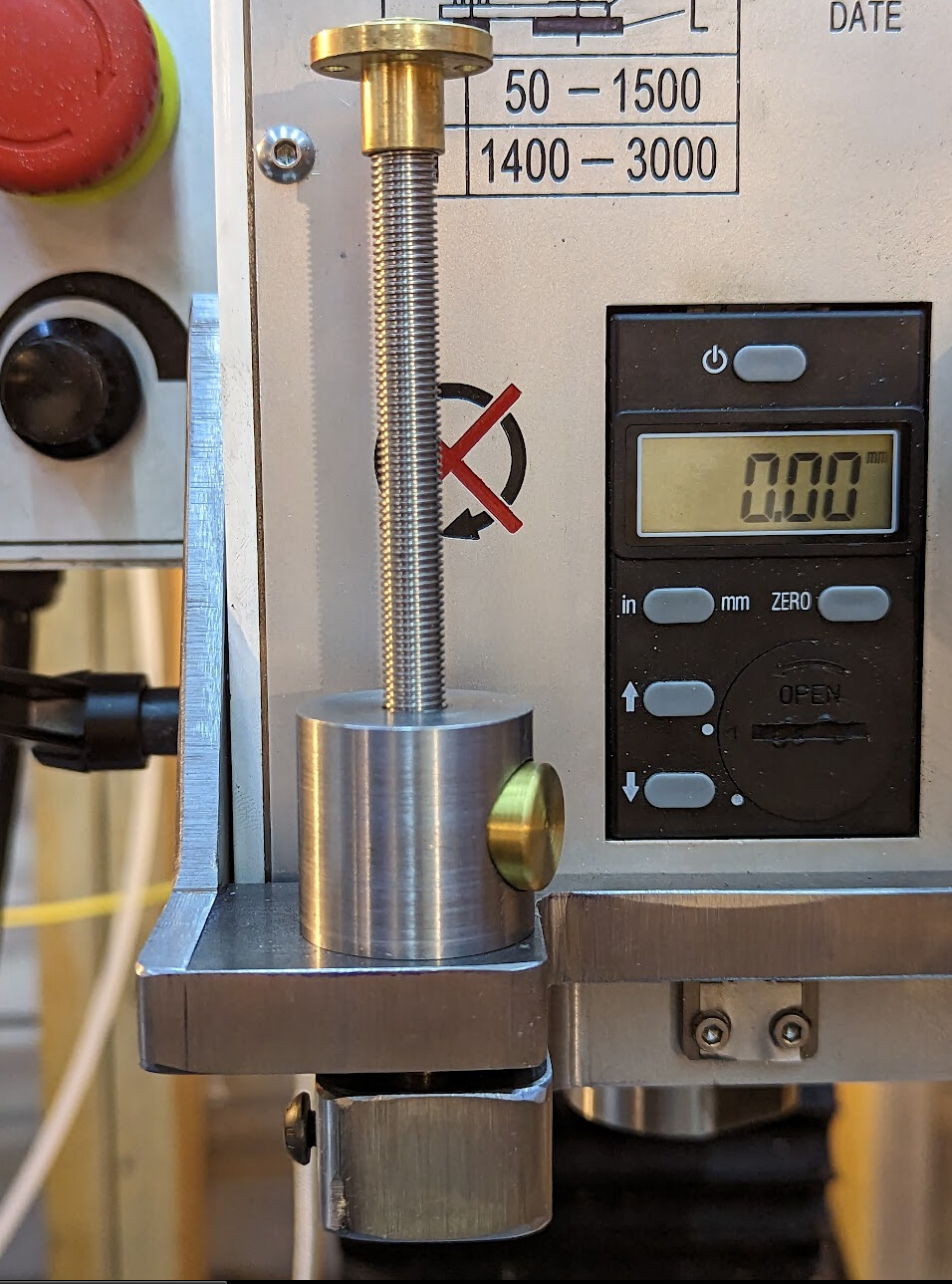

The more machining I learn, the more I wish I had a depth stop on my mill. Real Mills have a depth stop, usually with a graduated nut (“educated nut” har har) that has a push-button release to slide quickly to near the right place and then rotate for fine adjustment. (Many of them, though not mine, even have power downfeed and automatic return when they hit the depth stop!)
I spent a long time planning this, but it’s finally just about done.
When I lower the quill, a plate connected to the quill pulls down the screw until the nut with the button in it hits the plate connected to the mill head. Within the precision of the quill DRO (which reads 0.00mm in the picture above), depths are repeatable ±.01mm. The DRO is probably itself ±0.01mm so that’s a total range of perhaps as much as 40 microns in theory, and probably closer to 20 microns. Just locking the quill with the kipp handle on the side moves the quill down about 30 microns, so that’s pretty much as good as can be reasonably expected for this mill.
I started with the nut. I knew that nuts with buttons existed, but had no idea how they worked, so I came up with a really complicated design which I fixed when I learned how simple commercial ones really were.

I finally decided to graduate the nut with sharpie to begin with and see whether 10 graduations are actually enough. I’m just not ready to cut the metal until I see how I really use it in practice. I don’t have any references to line the graduations with anyway, so making it super fine just isn’t going to help. I think.
If a normal graduated nut is an “educated nut” I guess this one is still in elementary school?
I did make both the 1mm and 2mm lead versions, and I can swap back and forth if I want to:
I am putting the lead screw nuts that came with the screws on top just to keep the graduated nut in place. I’m not sure whether I’ll keep that up; it’s just an idea. The screws have brass round nuts at the bottom that register in a shoulder in the hole in the quill plate. They are held to the screws with loctite and are a pretty tight fit to start with. I can replace them if the fixing screw in the side chews up the brass too much, but honestly that will happen only if I actually end up swapping out lead screws, and at this point I’m expecting that the 1mm lead screw will get almost all the use, so probably it will just stay in place.

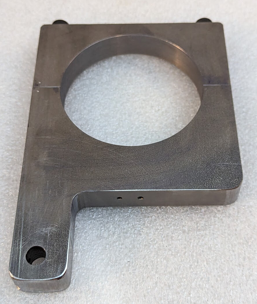

The quill plate was quite the job. I started out with a 6" wide piece of 3/4" cold rolled steel plate, not quite 8" long. Glad I wasn’t trying to cut that with a hacksaw!
I scribed some layout lines on the top and cut a chunk out.
If I were doing this over, I’d probably wait to cut that chunk out. It made it hard to drill the holes in the back for the M8 screws that clamp it around the quill.
I drilled the holes to tapping size in the back, sliced it through, cleaned up the sawed faces to dimension, tapped the bottoms of the holes, drilled out the tops of the holes to clearance diameter, bolted it back together, putting a few witness marks so I am not in danger of putting it together backwards, and started drilling out in the middle of the cut. Eventually, I switched to a boring head.
Sadly, I cracked the carbide face of the boring bar. I wasn’t going to get a precision finish that way. I mounted it in the four-jaw chuck in the lathe and finished boring out. The jaws that clamped side to side across the split were quite light to avoid boring the hole out of round; the jaws that clamped front to back were tighter.
I had to buy a 4" micrometer to measure the quill, and then I used the micrometer to make the hole a location fit.
I drilled holes to attach the quill DRO, and then replaced the DRO quill collar that came with the mill with this new quill plate. It wasn’t done yet, but the mill was usable.

Update after a month of use, in which I’ve been overjoyed to have this new feature…
So far, the 36° lines have been enough; really I can interpolate in half reliably which is .05mm and that’s all I really need. Turning the nut has been the hardest thing because of the smooth surface, so I think that putting engraved graduations on one side and knurling on the other will probably be what I want to do.
Then I’ll want to add an index line somehow. Still thinking about how to do that.
The top picture in the original post shows the nut that came with the rod on top. I put it there to keep from snagging my hand on the top of the rod while working the nearby controls, but it kept running down the rod from vibrations while the mill was running. I rashly put some thread locker on it to keep it in place, and now realize it’s going to be quite the pain to remove when I want to do the engraving and knurling. I guess I’ll get out the torch!
