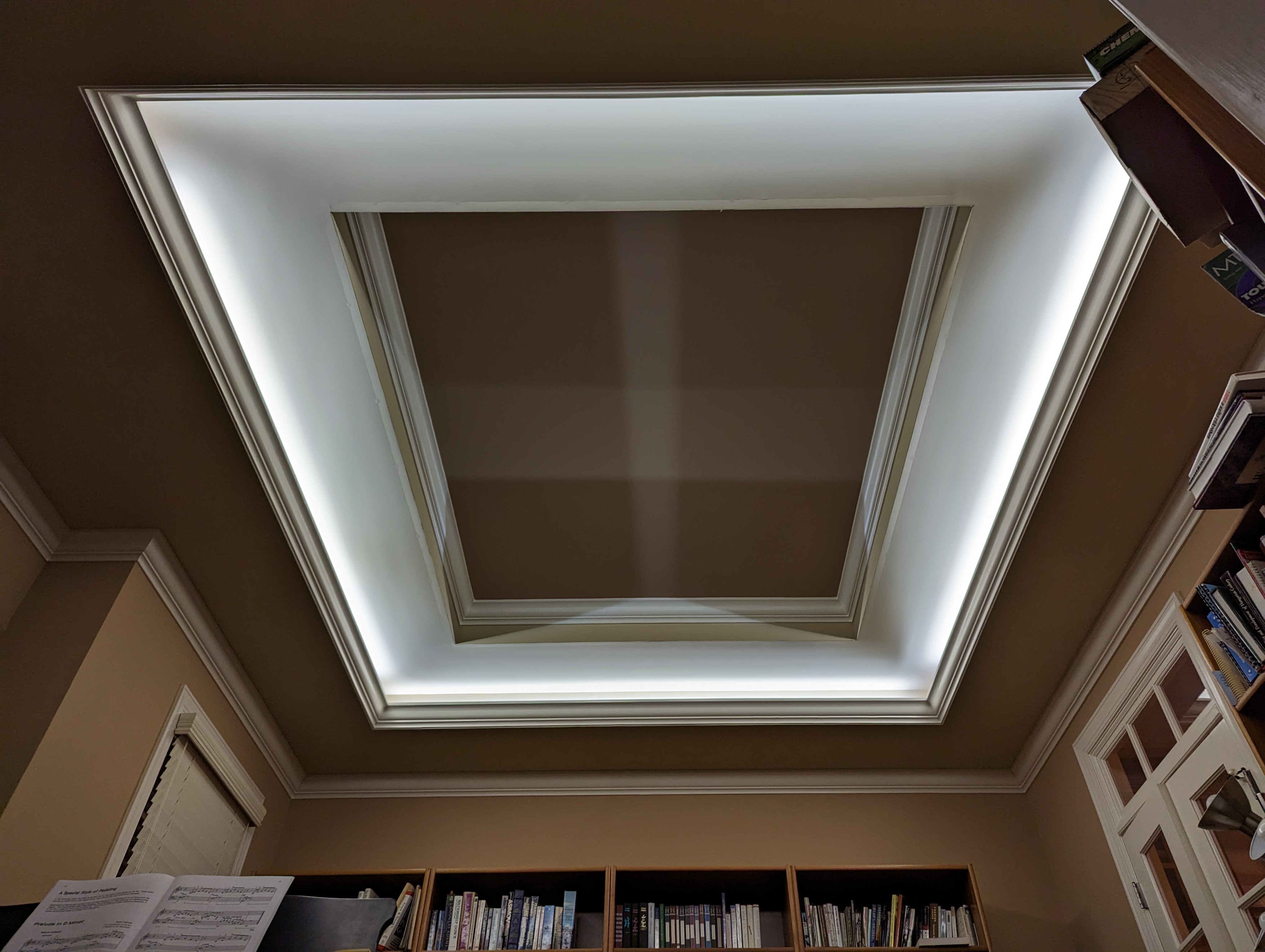

We have two rooms in our house with tray ceilings; our dining room and music room. (I’m sure the “music room” was intended as a formal sitting room, but for us it’s a piano surrounded by bookshelves.) The builder installed incandescent rope lights in both as accent lighting, but the tiny bulbs in the rope die out over time, and the light starts to look blotchy.
Years ago, I bought some LED rope light for the dining room, and it was really ugly. Not just greenish tint, but also irregular patterns of light. It looked worse than the partially-failed incandescent rope light I’d already thrown out. So that wasn’t what I really wanted when the music room lights started to fail.
A couple years ago, I impulse-bought 10 1-meter sections of aluminum channel + diffusers for LED strips, but then didn’t use them. When I decided to fix the lighting in the music room, I measured and realized that I needed about 10 meters of light. So I bought a 10-meter reel of 24V 8mm wide white LED strip with a power supply and some extra connection fixtures, and today I went to put them together.
I thought I was going to have to 3D print some supports to sit inside the crown molding that holds the lighting, but there were already supports holding the crown molding in place, and they provided a sufficient flat surface for the LED channel.
But what I did need to do was make four 2.5 meter sections of light out of 10 1-meter pieces of extrusion and one 10-meter section of LED strip. I cut two pieces of extrusion in half before I realized that I hadn’t measured the cut pitch of the LED strip. Fortunately, the cut pitch was 10cm, so it was a perfect fit. I 3D printed 8 joiners to hold the extrusion together, and started assembly.
The switched outlet is near one corner, and I fed them from the center, so two 2.5-meter sections on each of two legs, to reduce voltage drop (the same reason I chose a 24V system to start with).
It took all afternoon, but now just the indirect tray light is bright enough to read a book by.
Now all I have to do is clean up all the detritus from my project.
If there had been more room for a power supply — say, a recessed alcove behind the crown molding, I could have used some far more powerful LED strip. There’s some that draws 1A per meter and would have been extremely bright. This is less than 2A. And the power supply is a little weak; when I hooked up the second leg, the first leg got a little dimmer. But my wife is satisfied with the result, so I’m going to call it a success and order some more to update the dining room.
I used 6000°K light for the music room, but I think I’ll use 3-4000°K light for the dining room; I think this cool white light would be less pleasant while eating.
