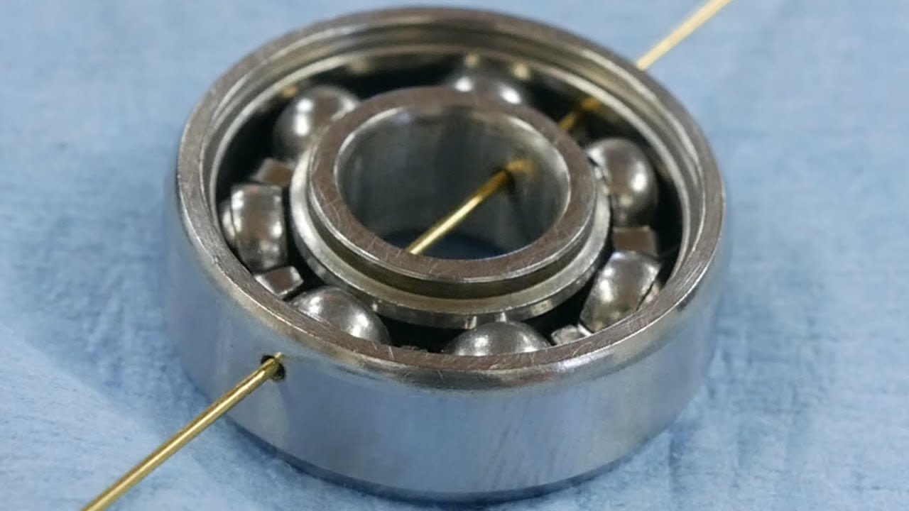

I’ve seen some stunningly precise edms on youtube based on BaxEDM power supplies.
Appled Science is one of the people I follow on YouTube that does lots of fantastic DIY equipment projects.
