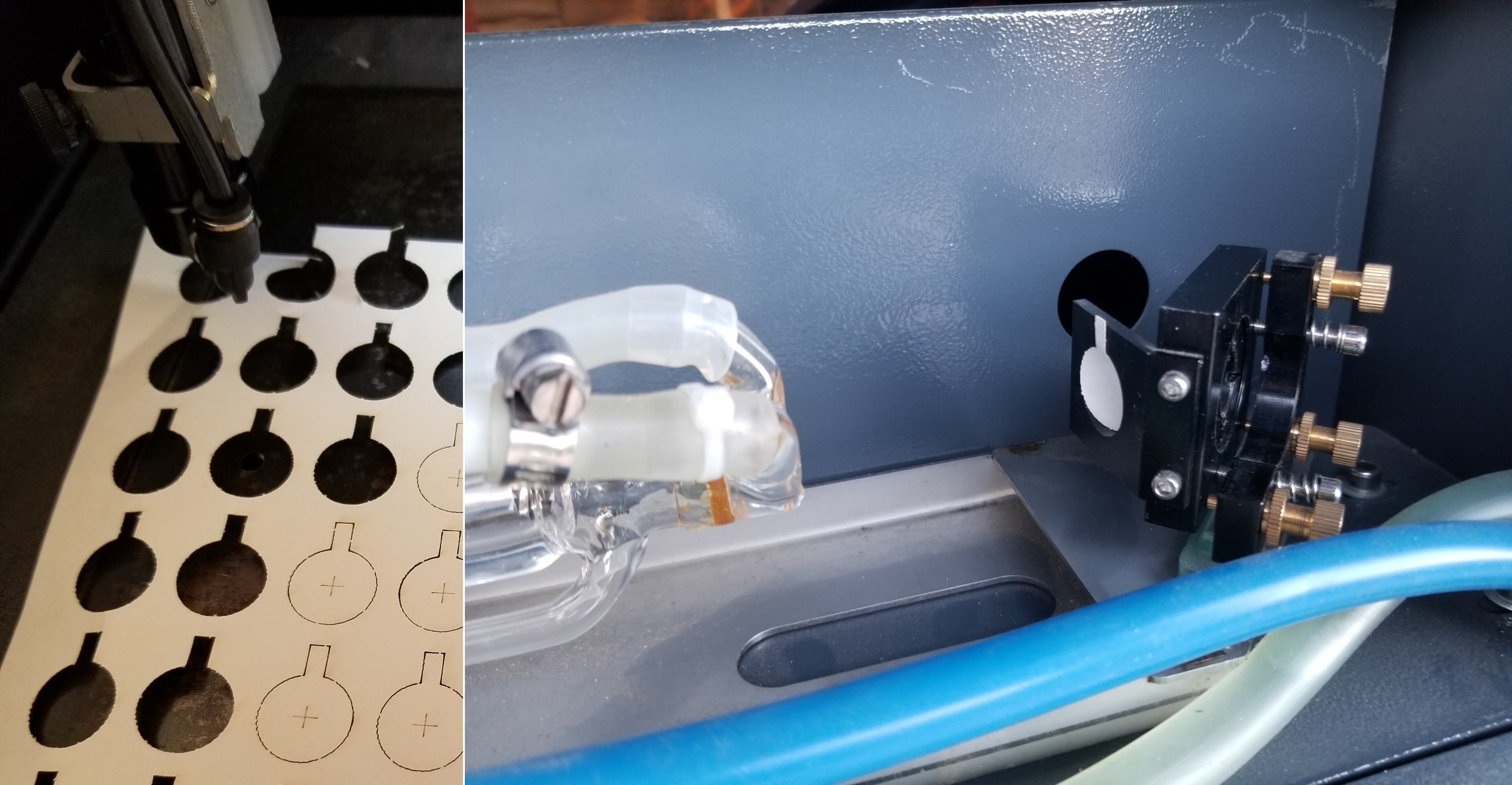

First thing I’d suggest is to ensure that the tube is working properly. Look at tubes output at M1 to ensure the tube is in TEM00 mode or resonance.
I use targets I’ve cut out for alignment… and how I test the beam at M1

There is a rather large bubble in the photograph that I would think should have flowed out of the tube… Were you running coolant when the video was shot? If so, doesn’t look like much is moving.

Blockquote First thing I’d suggest is to ensure that the tube is working properly. Look at tubes output at M1 to ensure the tube is in TEM00 mode or resonance.
Have never user this graph for TEM00 from what i understood i just fire at 1st mirror and see the marking to witch TEM they respond ?
