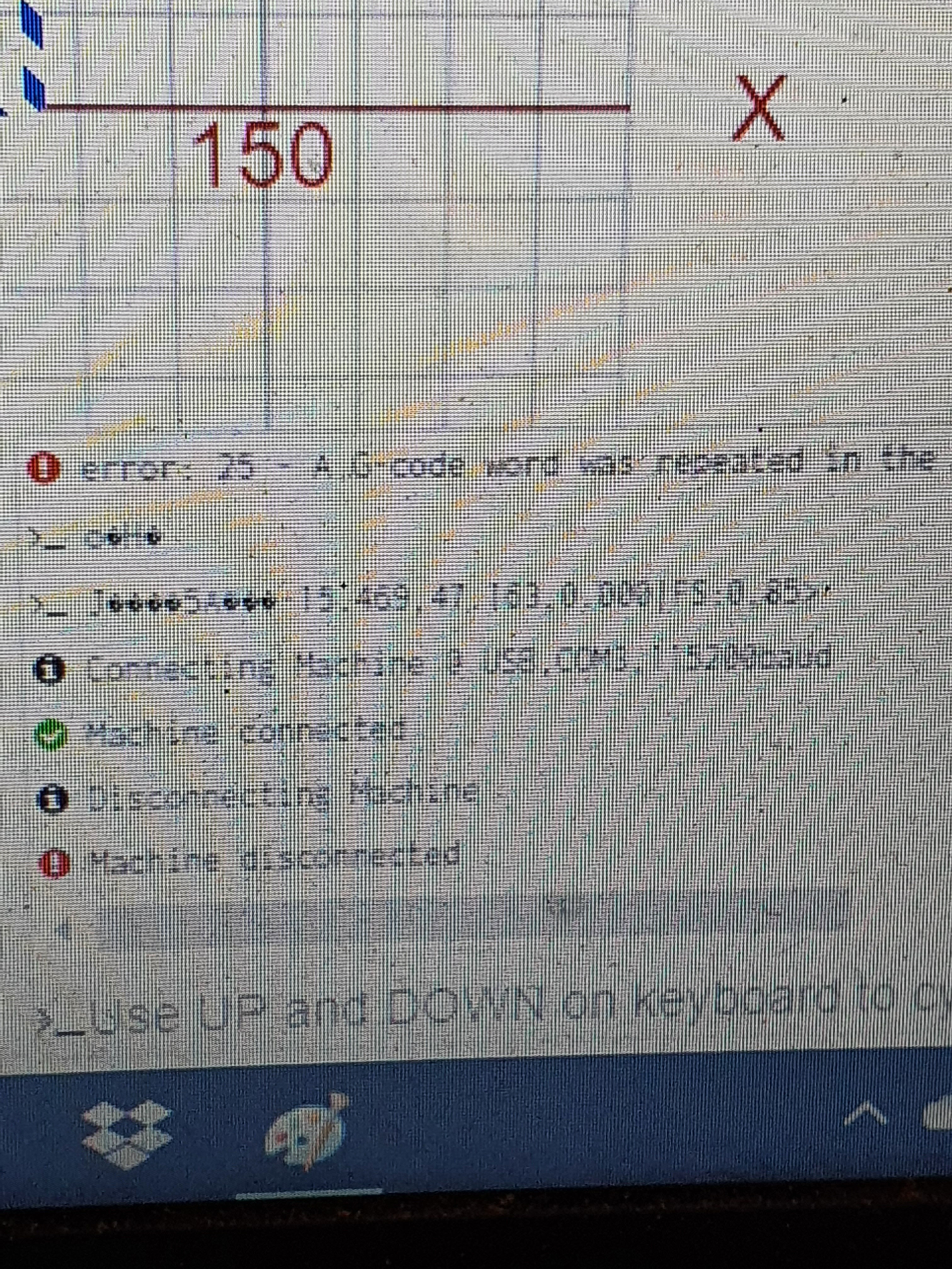

After all this months, i came across with a LW4 problem when i lasering a image. Some how, my laser stops working in the middle of the job and LW4 crashes. Its something didnt happen before, is anyone have a idea that could provoque this?

What exactly do you mean by “LW4 crashes”? Do you get a bluescreen, or is LW unresponsive? Does it always happen or just with that one file? How big is the image you try to engrave?
Hi @cprezzi
Has been happening with a lot of files, yesterday i was trying do 4 PNG files and all fail. When i look to the g code window in LW4, show up a weird characters
. The machine just stop working, and i need to reboot the machine and LW, because LW4 takes to long to become responsive again. I already uninstall everthing incluiding drivers and install again and i keep with the same problem. Do think could be from the laser machine? Not from LW4?
Thank you
That looks like an unstable USB connection or bad machine controller.

More thoughts along the same lines: An intermittent bad connection on the device could cause this too; it doesn’t have to be directly part of the USB connection. Could be a bad ground connection. Or an intermittently-failing power supply. Noise that starts showing up without any software changes can easily be from a physical source. These diode lasers have wires that have to move to get to the laser head. This can end up with broken wires inside a cable that almost always connect except when the flex a certain way, or (more likely) an imperfect electrical connection; lots of ways things can go wrong. In any case, I agree that this looks like electrical noise of some sort.

And in meantime, @cprezzi and @mcdanlj, for the first time, i down the S: Value (i dont have a sure what S: value mean, but seems be the PWM max S value??? I dont get), from 100% to 80%, and so far that weird letters in GCode Window i said before, doesnt show anymore and looks the laser machine its working without any problem…

Yes, the S value is relatet to the laser power. In GRBL you set the maximum PWM value by $30=1000 (default is 1000), which represents 100% power. The set maximum also needs to be configured in LW.
Now when you reduce the S value from 100% to 80% your laser draws less power from the power supply. This could mean that @mcdanlj was right and your power supply might be unstable at maximum power.
Thank you @mcdanlj and @cprezzi, you were right is the power supply is not working very well, i need to order a new one.
