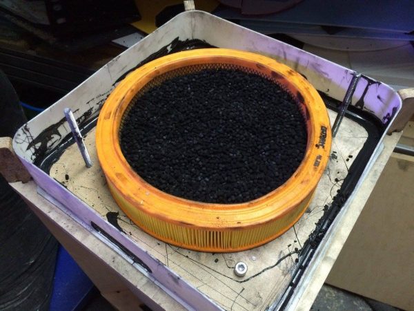

I you search “diy laser cutter exhaust filter” you will find a number of builds that people have done. Like these:
The big downside is that depending on the material you are lazing, you might have to replace the filter often which as stated above can be a couple of hundred dollars.
Yes, it would certainly depend on what filters you are using. You would definitely want some kind of pre filter to prevent the activated carbon from becoming clogged to fast with particulates. Could be as cheap as a car air filter. Bulk activated carbon would probably be the cheapest option for chemical adsorption of vaporized products. Then you would want a post filter to prevent blowing out carbon dust. You would also need a fan with enough CFM to get adequate air flow through the whole filter.
It’s also technically possible to regenerate activated carbon by heating it up hot enough to have adsorbed impurities desorp. Of course this would require about 500 - 900C to bake everything out. Probably some kind of propane powered furnace. It would also definitely need to be done outside because all those impurities will be venting off.
