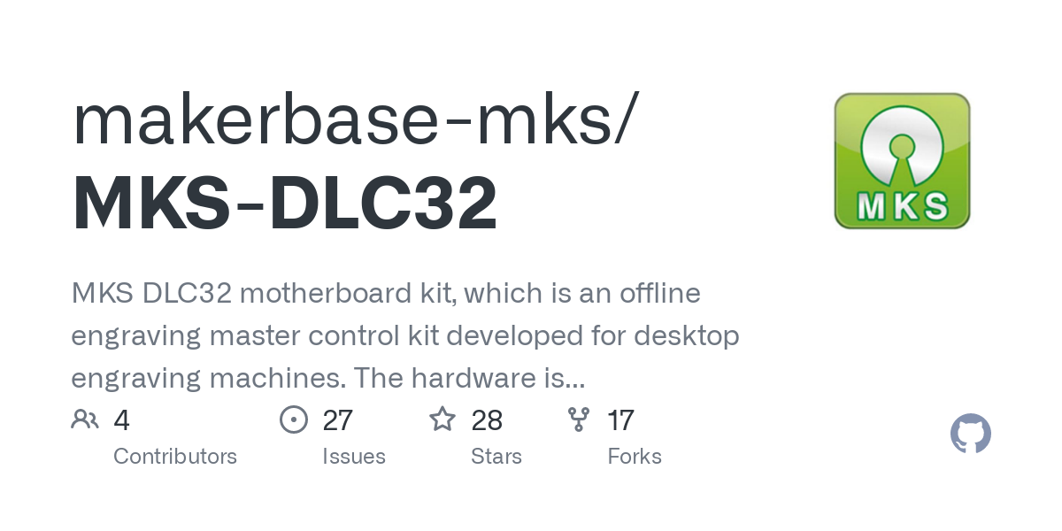

Ah that’s the new 32-bit DLC32, not the 8-bit DLCV2.0 or DLCV2.1

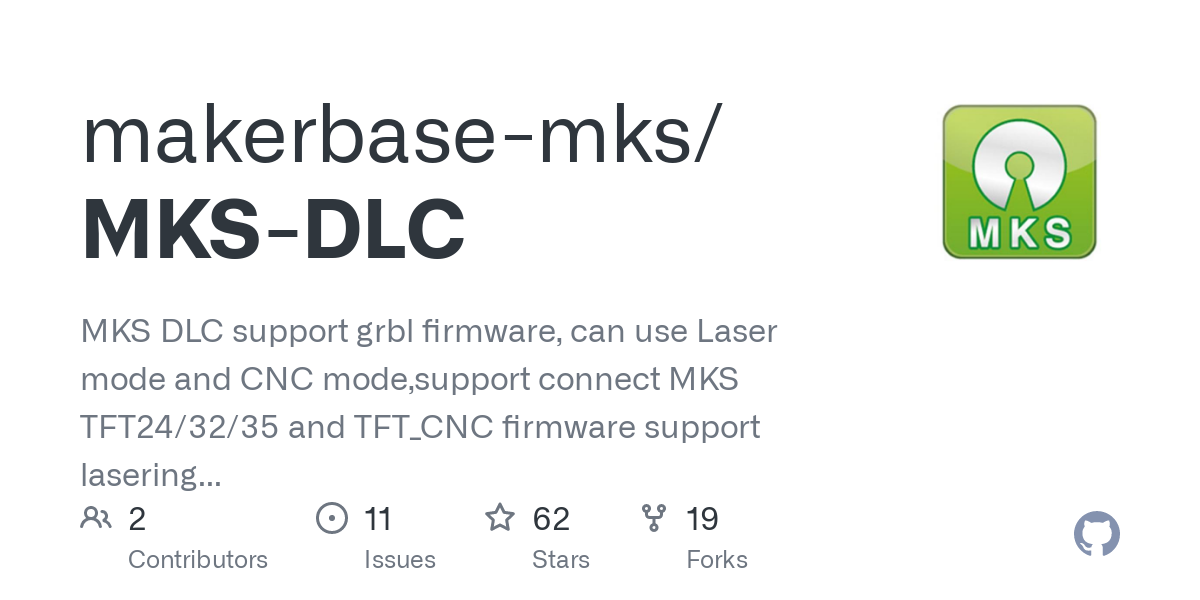

The equivalent for the 8-bit controllers is here:
The hardware folder has folders for V2.0 and V2.1 that have schematics and pinouts.
Thank You. This is the board I have…
