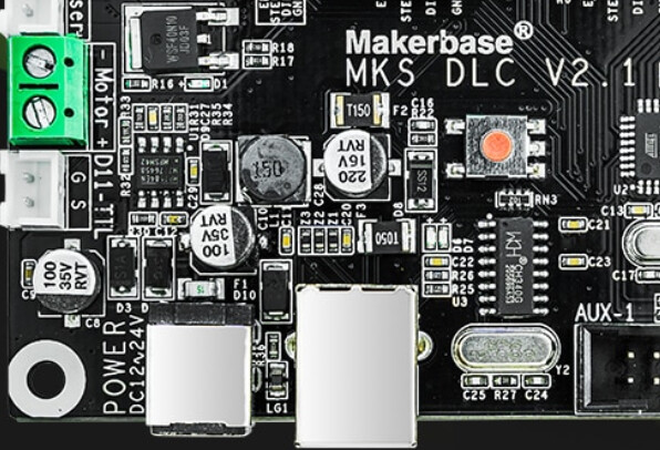

Does anybody know whether the DLC v2 can handle 24 DC volts (i think they suggest to run 12 DC volts for this board)? I think i would need 24 volts for the NEMA 23 motors…

Pretty sure the board only supports 12V…

I’m running my MKS DLCv2.0 at 24V just fine.

At least the MKS DLC V2.1 (current production) says that it can take 24V:
The “user manual” has almost nothing in it, but the 2.0 image says only 12V, so I think @donkjr was right about the 2.0. This might in fact be the difference between V2.0 and V2.1?
If you have the V2.1, 24V should be fine.

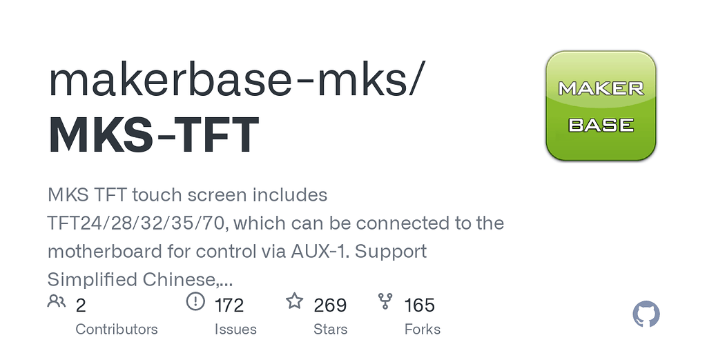

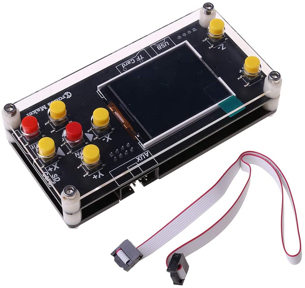

Michael, what i mean with offline controller is this touchscreen:
My workshop is split into 2 sections (one where i do the wood milling, one where i have a music studio with my iMac). I was thinking to link my iMac through a long USB cable with the CNC machine to carve out guitar bodies. On the other hand, i also want to leverage this CNC machine for some more basic routing stuff, hence the reason why I would buy this ‘offline controller’. Do you think this would work together with the MKS DLC?

@SB_1987 I have no idea about that controller board, I’m sorry. The general name for such things in CNC is a “pendant” I presume because they are usually hanging by a cord near the station. Sometimes “MPG” for “Manual Pulse Generator” as well.

On the offline controller: I basically go to the MKS DLC, because it allows me to hook up an additional device/screen, which allows me to jog with the spindle (easily and without computer). Are you aware that the Arduino Uno + CNC shield has this option somehow? I thought not…

The MKS DLC is basically an Arduino Uno and CNC shield all-in-one board. The TFT connector (AUX1) on the DLC is the same TX and RX pins that are on the top right corner of the Protoneer (and clones) CNC Shield. They both will support a touchscreen or other offline controller that speaks GRBL. That being said, these connectors are not a second serial port. You can use the “offline controller” OR the USB connector, but not both at the same time. They share the same serial line on the AVR. If you try to use them at the same time, you will end up with communication errors. Just something to consider while planning your setup.
Here is a link to another forum I belong too where I and others tested various controllers and TFT touchscreens.
