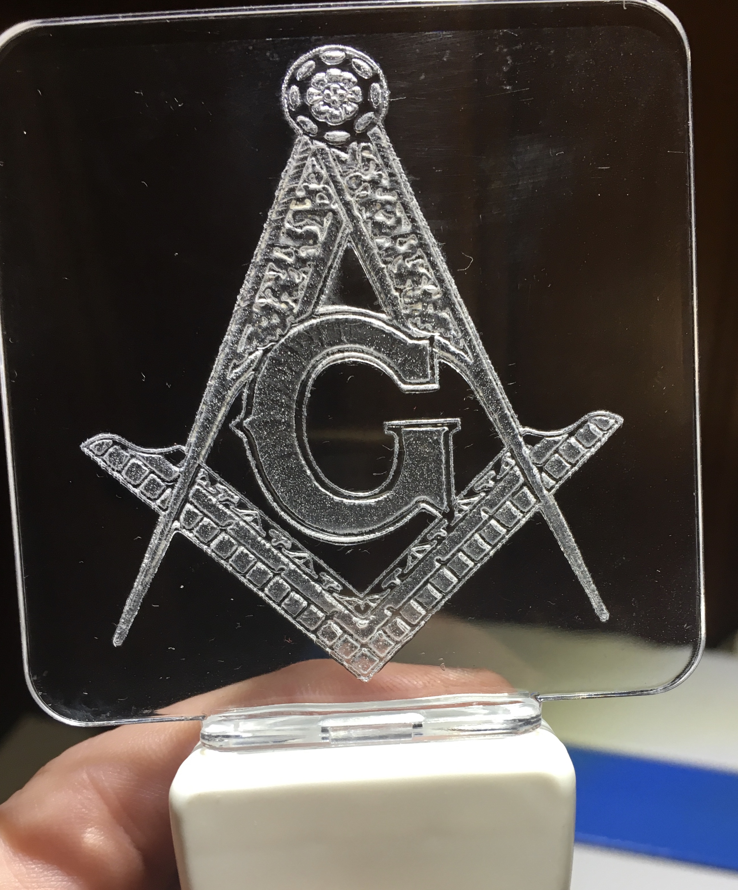

Made this for my son and his wife.
Nice. I assume it had a different piece of acrylic in it to start with and you replaced it with your own?

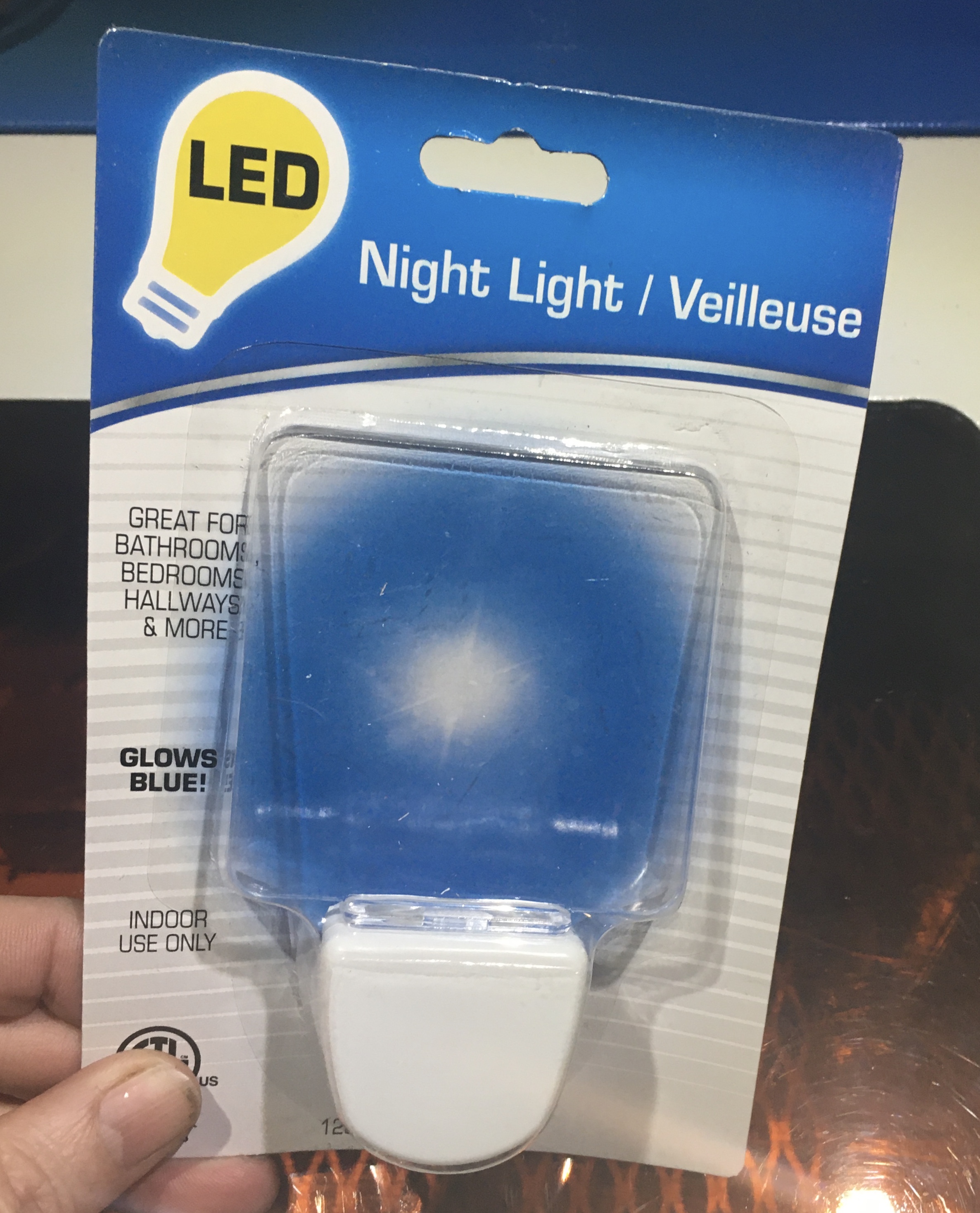

The night-light actually has just a plain blank acrylic that lights up.
https://www.dollartree.com/blue-light-led-night-lights/195860
Well isn’t that handy. Nice find.

I was driving and setting at a light earlier when I saw this additional talk on the topic. Looked up and realized I was literally like 2 blocks from a Dollar Tree. So I stopped in and grabbed one. :slight_smile:

I just used low power, fast engrave and got lucky!

Gave this a try. Removed the panel and engraved it from the back with the image reversed. Because of the base on the panel I used a scrap piece of 3mm ply to support the front so that it was mostly level. Masked and engraved. Got some of that Rust-Oleum glass frosting spray I mentioned above and gave it several light coats. The spray defiently seemed to help make the engraving show up better.
I think it is the best $1 item I have bought to use in the laser.
