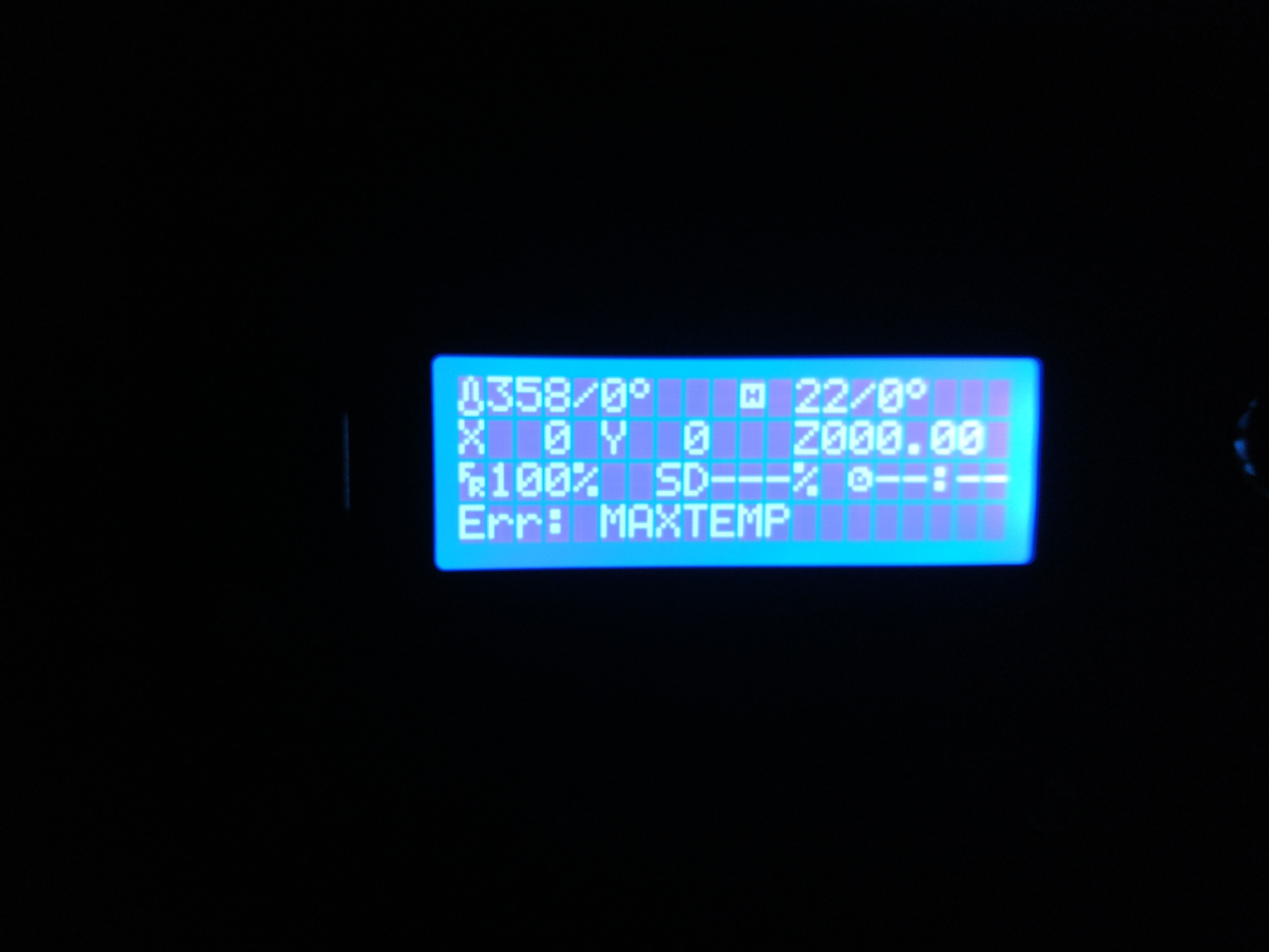

Any idea why this is happening? Is the temp sensor bad? If I unplug it, it says 0 and mintemp. Either way I get an error. I’m not quite sure what the issue is.
And now it just says 0 and min temp. If I swap temp sensors with the bed, the 22 switched from one side to the other. Looks like a bad temp sensor. I guess it’s time to order a new one. Lame.
Bad thermocouple possibly
Could be a short in the temp sensor wire

Typically a thermistor short will trigger maxtemp, while a thermistor disconnection will trigger mintemp. Alternating between the two is odd.

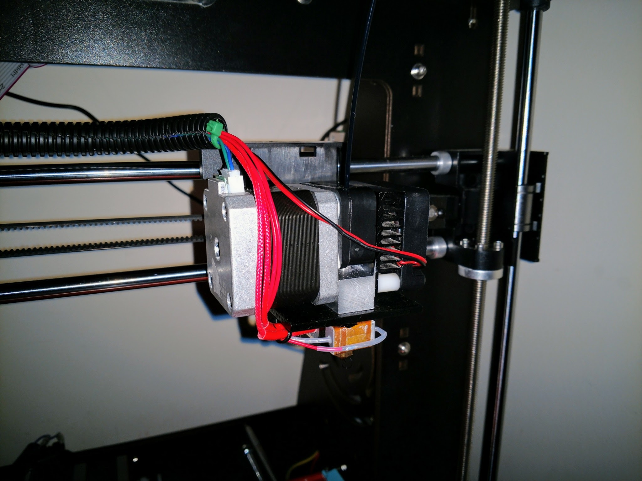

Send me a better picture
@Joseph_Ronie any better?
You would need to print a new X carriage and a Boden assembly which you currently cannot do because you don’t have a working thermistor. You can probably order the parts off the internet. Or if you’re in the Seattle area I can print whatever you need

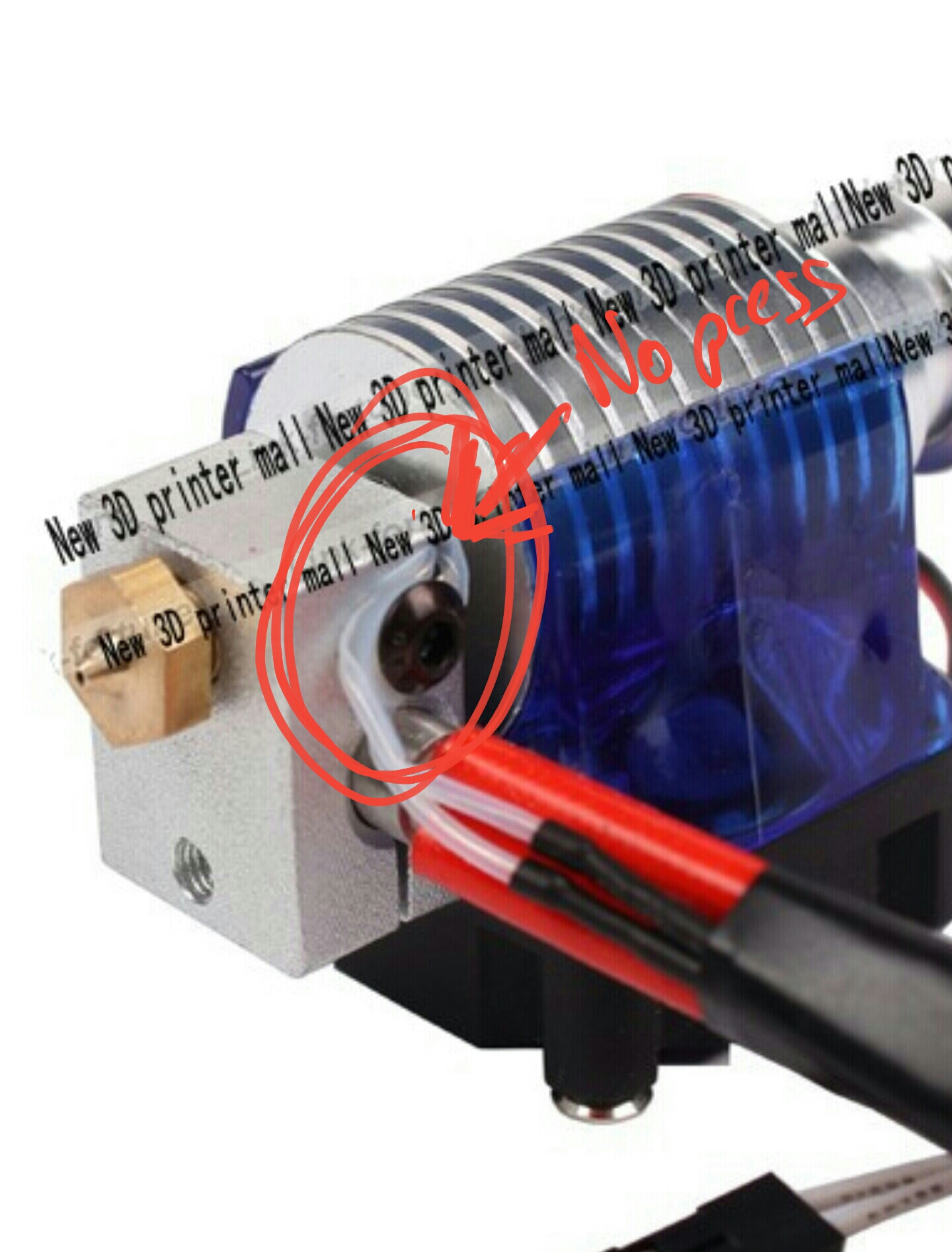

Many problems are with the nut. Press the sensor short circuit. Loosen the nut a little and check
That should work.
