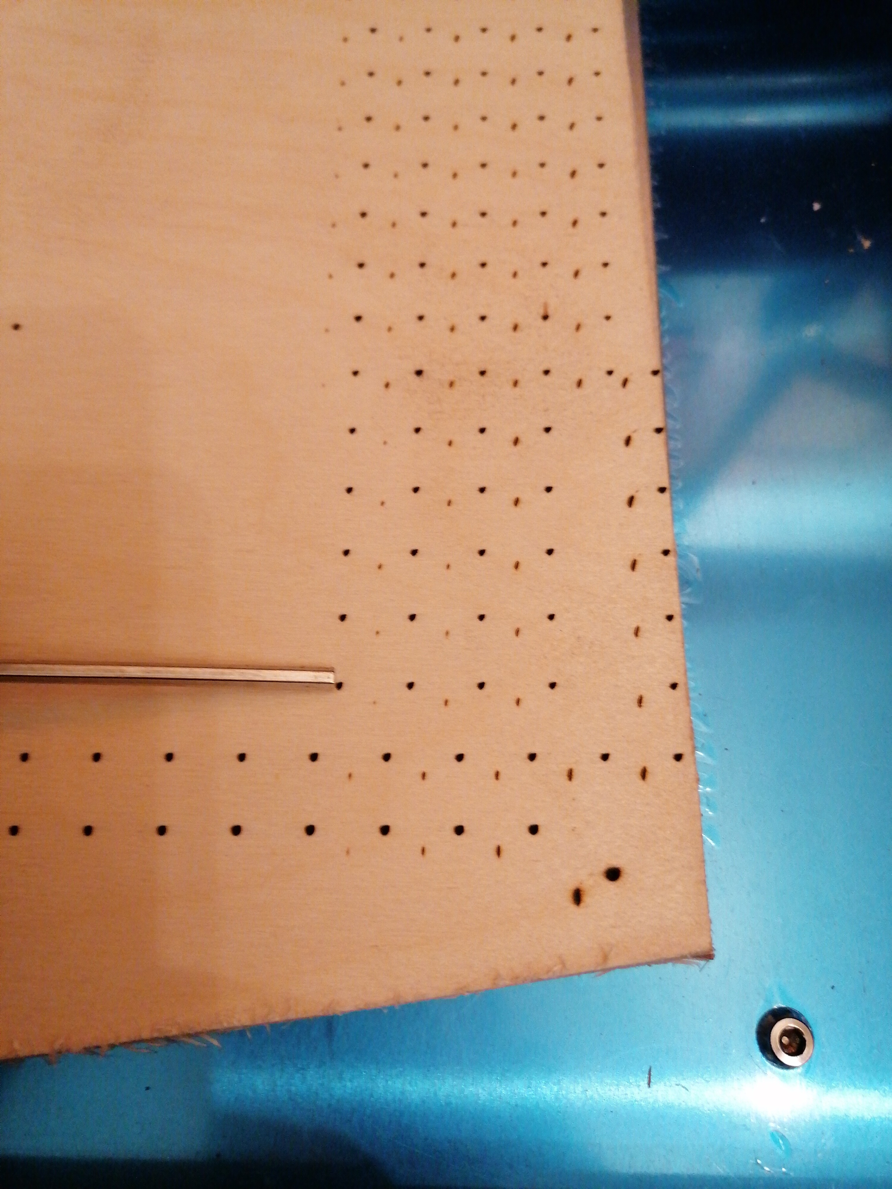

had an attempt at aligning but then noticed when the tube u is during I can see a yellow circle on the frame of mirror 2 and the same circle appears just down wind of the spot on my wood…
I hope this shows, i didnt want to leave my phone in the enclosure too long…
this pictures shows it too, i used the 10mm jog on k40 whisp to manually step out a grid and fired single dots onto the board as shown by the allen key end… you can see the “ghosts”
Ghosts are often caused by mirror contamination, cracks etc.
Also reflection inside the objective lens from the beam hitting the side of the enclosure, contamination cracks, etc.
hope not machine has only a few minutes of use on it. I guess I need to pull the mirrors and check them… thank for your reply
These machines rarely come with proper optical alignment so I suggest you perform one :slight_smile:
was hoping to avoid it as all the mirror adjustment screws are locked in place with some weird white crap, but guess I know what I’m up to over Christmas

did an alignment to the best of j Jr ability and all seemed well but on higher settings in still getting the ghost spot, so will try again and report back, it was working well f though to complete a couple of jobs though

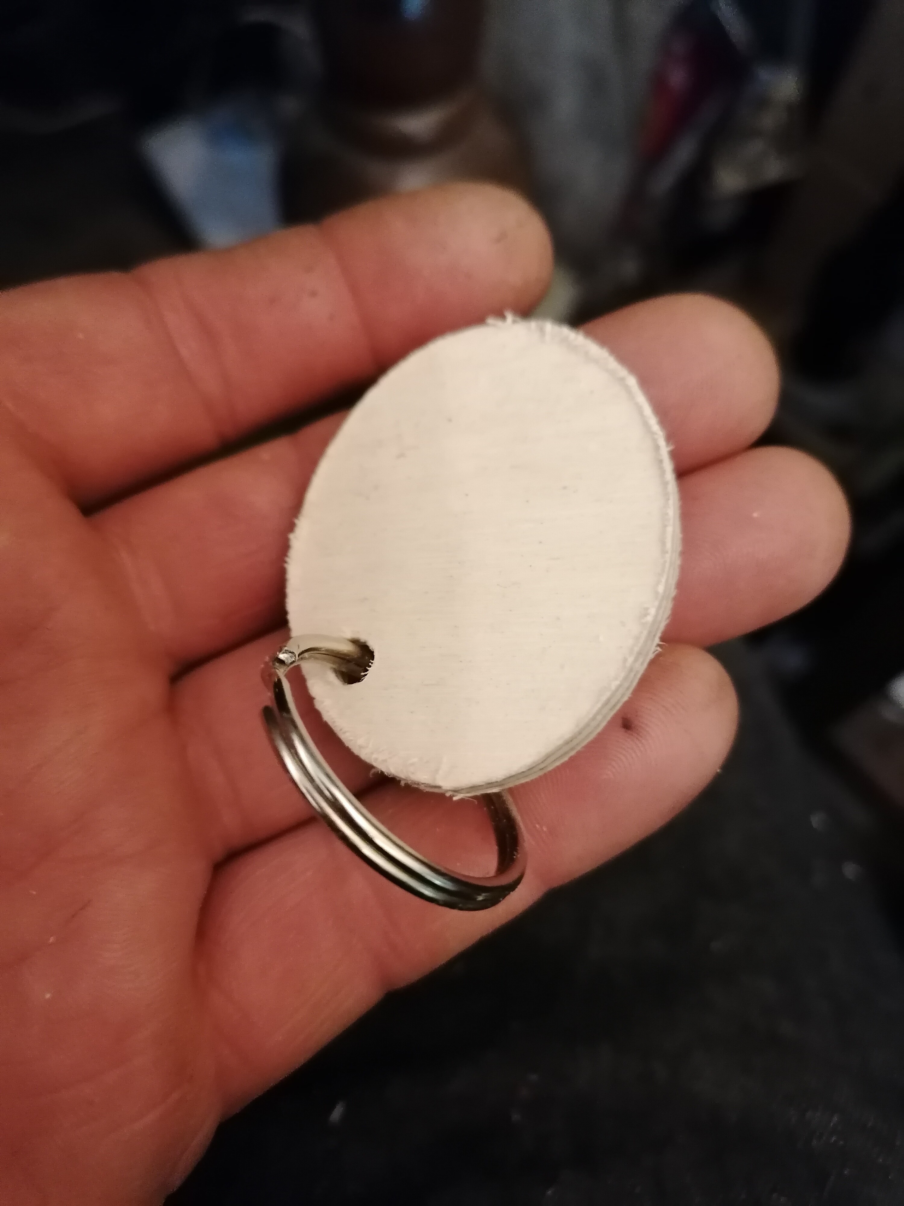

i cut the blanks with my little cnc as the 5mm birch won’t cut as I’ve not got air assist yet, i can get it through with multiple passes but they are blackened edges

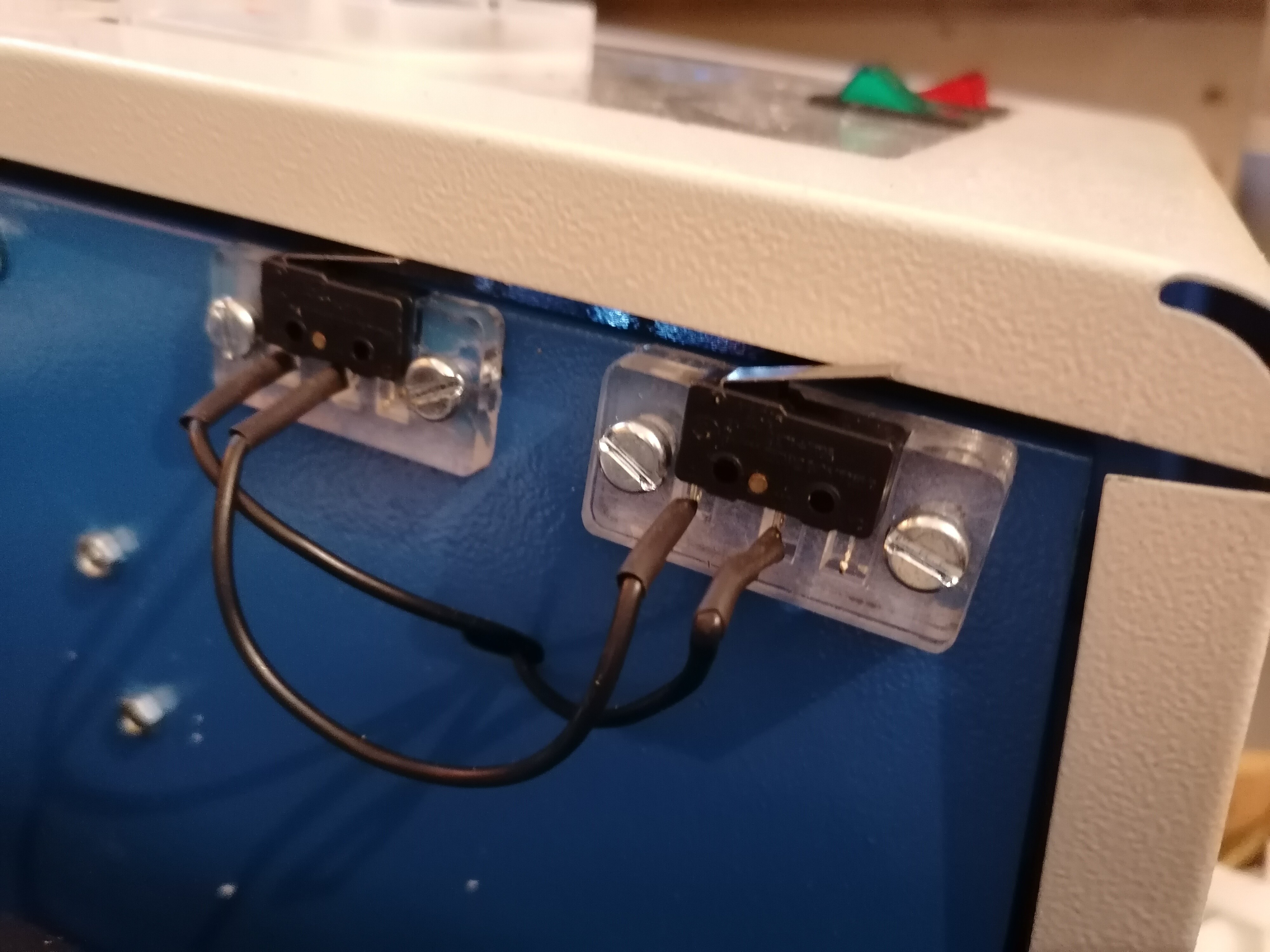

still got alignment issues but had to do some paying work so addressed some of the safety issues… interlock microswitches made and mounted
then added a defeat inside to enable me to fire the laser during alignments etc
this involves an actual piece i have to remove to disable the microswitches.
