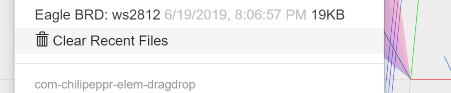

Drag/Drop Out of Local Storage Space
You are out of local storage space, so ChiliPeppr can’t save your Gcode file for the next load. Please delete all of your local storage files for ChiliPeppr using the in the workspace.
You can also ignore this error and proceed since ChiliPeppr will simply load your file into RAM and function perfectly fine. The only downside is if you reload ChiliPeppr, it won’t have your most recent file loaded.
Browsers typically only allow for 5MB of local storage, which isn’t muc
I am new to this forum, and just discovered as a new user to get around the three reply limit I can edit a previous reply.
Thank you, I found the clear files button. I then tried to drag the gcode file into chilipeppr again and it appears to have tried to load it then it looks like it just gave up and put the chilipeppr screen back up. I am going out to the garage to connect back to tinyg and try it again.
First off, you can ignore this error and everything works fine.
Second, in the File menu you can delete all of your imported files to empty out your local storage to get rid of that dialog box by clicking on “Clear Recent Files”
