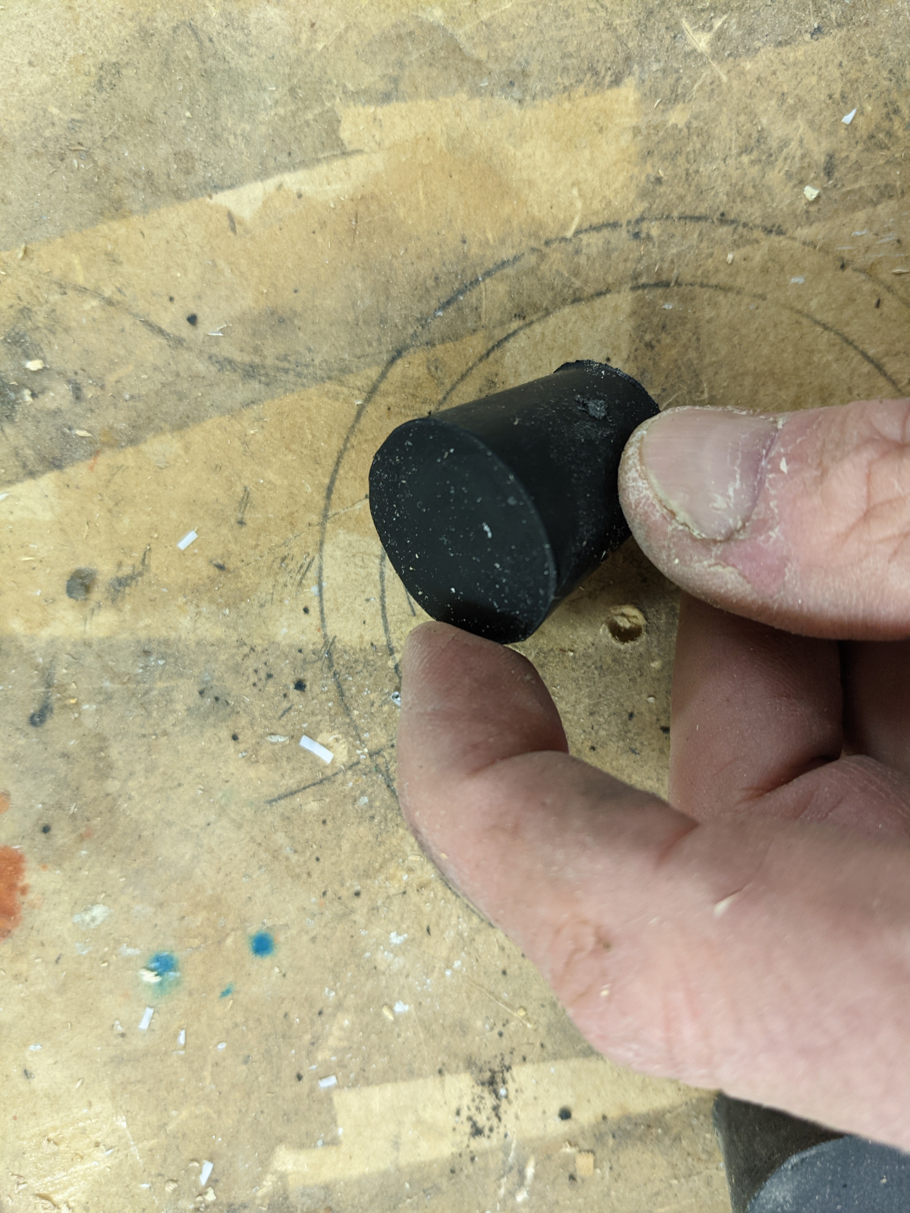

How do you drill a 1/4 inch hole directly through the center of a common rubber stopper?
I need this for a woodturning tool I am making, thus the reason it is posted here.
The challenge:
…describe the fabrication method and tools needed to drill a near-perfectly centered and formed 1/4" hole through a rubber plug whose large end is 1" in diameter and the small end is 7/8" in diameter.

The top is 1" and the bottom is 7/8".
I learned the following:
  • A twist drill will not drill cleanly, very grabby.
  • A Forstner bit cuts extremely well.
  • If any part of the wall of the plug is unsupported it will distort and not drill straight.
My solution after a few attempts at other methods. On the lathe with a tapered hole in a jam chuck drilled with a Forstner bit in a jacobs chuck.
