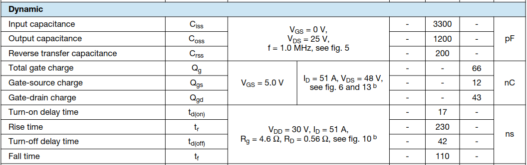

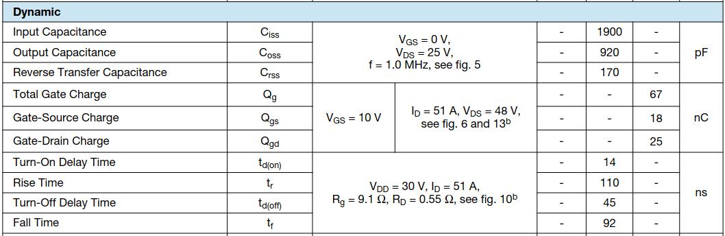

Amazon has deceived me and instead of IRLZ44 I have bought IRFZ44. I have looked at the datasheets and it seems valid even though I haven’t done anything electronics for years. When you say compatible with TTL voltage, do you mean Vgd (th) <= 5V? Thanks
I went looking for the relevant bits in the Vishay data sheets.
As I read it, the IRLZ44 is slower (230ns rise time, 110ns fall time) but works with 3.3V logic as well as 5V logic; IRFZ44 is faster (110 ns rise time, 45ns fall time) but needs 5V logic. I am guessing this difference is immaterial. Basically, as long as you have 5V, IRFZ44 with Vgd(th) max 4V should actually be better for you because it has faster response. For anyone who is using these instructions for a board with only 3.3V logic (many modern ARM-based boards), you’ll want an IRLZ44 due to lower max Vgd(th) of 2V.

https://www.vishay.com/docs/91291/91291.pdf

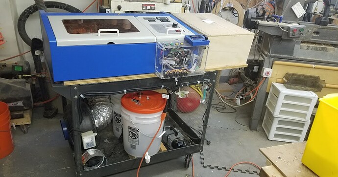

The board I use is MKS DLC 2.1 with GRBL 1.1f (not the best, I know, but I was already at home for another project), which is basically an Arduino UNO fused with CNC Shield 3.1. The PWM pin works in 0v - 5v, so IRFZ44 should work correctly, as it seemed to me when I saw the datasheets and as you confirm. When I have all the concepts clear, I will go to a 32bit: Cohesion3D, Smoothieboard, MKS SBase, … I will have to see which one interests me the most, depending on the use I’m going to give it (hobby), how easy it is to get them in Spain, etc.
My current installation is this:
My intention is, next weekend, to get to have this:
Why?
With the current configuration:
1.- When the machine is turned on, the laser activates itself, for a time of about 5 seconds.
2.- The change of electronics is to be able to use K40 CO2 with Lightburn. With my current mount, I have no physical “Test Fire”, and the virtual Lightburn activates the laser, but does not turn it off.
Basically what I want is to avoid problems.
For the rest, the current configuration works well, although I still have not gotten the point to the settings: Speed ​​/ Power.
Thanks!!

I’d like to warn that the CW-3000, which I see in your illustration, will generally not maintain cold enough temperatures to keep a laser tube in good shape. We have an article just about this:

I have mounted the CW-3000 because a failure of the aquarium pump has already made me buy a tube, and in the few Spanish forums that there are they recommended it. Although it does not appear in the image, I also have a temperature sensor direct to the tube, which if it goes above 32ºC (I think I remember) cuts the job.

32°C is way too hot. We recommend 18-20°C as the target. The only place a CW-3000 is appropriate for a CO2 laser is if your ambient temperature is in the 15-20°C range. Your new laser tube will again die young if your coolant is too warm. This will show up as a loss of effective power, and likely a higher TEM (search this site for “tem01” to see pictures). If you can reprogram the alarm for 22°C that might work, if you can keep it cold enough.
It is frustrating that the CW-3000 continues to be marketed as appropriate for lasers. I’m sorry that you have received bad advice.

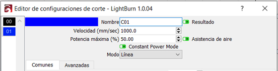

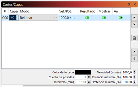

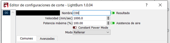

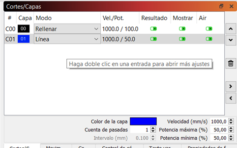

For variable jobs I have (or I think I have) clear how it works. For example:
Sin título-1
Power MAX = 100 and Power MIN = 10, Power range from: 10% to 100%
Sin título-2
“Constant Power Mode = OFF”
Sin título-3
100% power scale, to indicate that this shape goes to the maximum 100%. But in the case of having more shapes, I can give each one a different value within the 10-100 scale. Correct?
But if I want all the shapes to be done at 50%, I don’t know if I indicate it correctly
Sin título-4
By giving the same value as MAX and MIN, I understand that with that it should be valid, however, I do not know if it should also be indicated in the following window (Constant Power Mode: ON):
Sin título-5

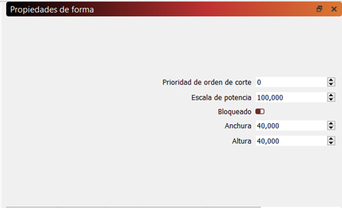

And if the properties window of the shape, in this case, is useful for something?
(I can´t upload more pictures in the post, sorry)
Or on the contrary, the first method must always be used:
1.- MAX = 100, MIN = 0
2.- Constant Power Mode = OFF
3.- In Power Scale indicate the power really desired for de shape or shapes.
Thanks

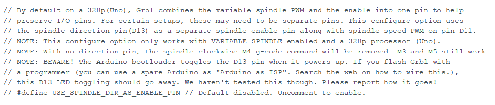

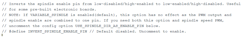

I had thought about the same thing, when I read that in smoothieboard and the like you could manage whether PWM is + or -. Looking at the GRBL firmware that MKS recommends for its DLC 2.1 board I find:
So I think uncommenting both lines should work. Surely I will try it, but if @cprezzi could confirm it or not before, it would give me more security :grinning:.

The problem with the laser activation at bootup is caused by the arduino (floating pins until they get configured from GRBL). If the MOSFET on the board is correctly built with a pulldown resistor from gate to source, this should not cause any laser activation. This sould be ok on the DLC 2.1.
