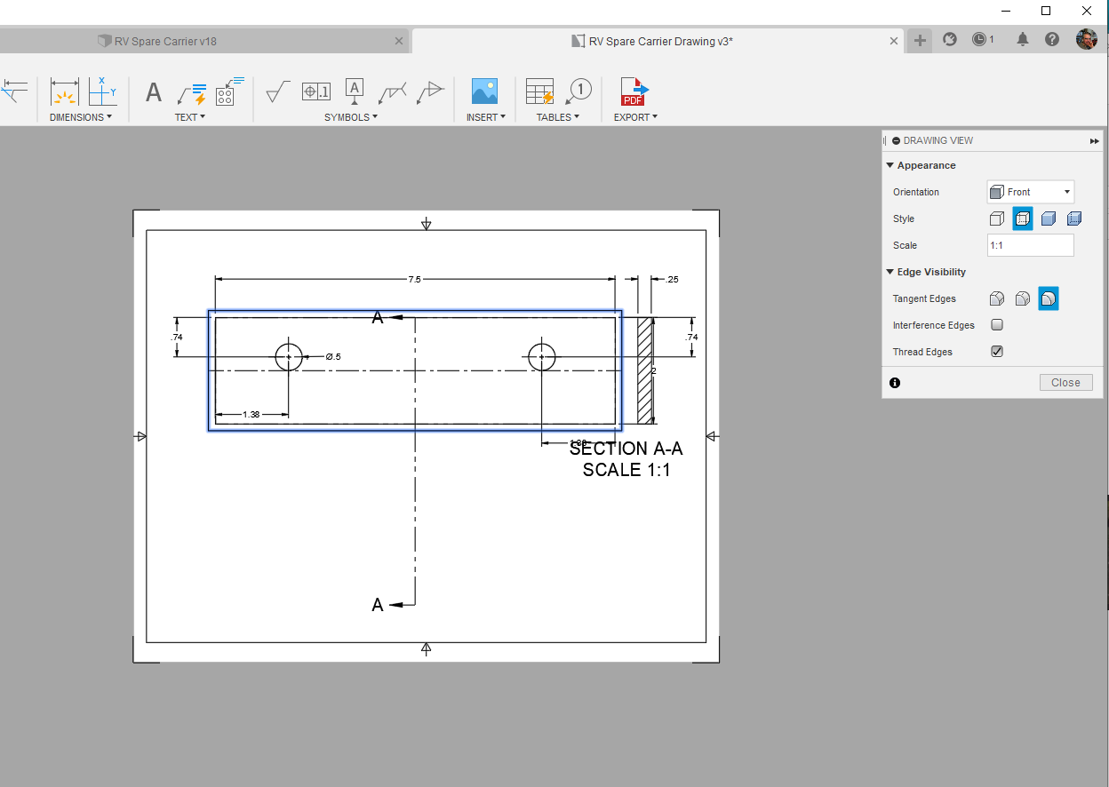

As long as you’ve got a solid part, you can switch to the “Drawing” mode. :slight_smile:
I thought that I had done this before!
I did, no need for viewer.
Thanks for the suggestions though
  1. Enter the drawing workspace and configure part as a drawing
  2. Set the scale to 1:1 in the drawing view menu.
  3. Export as PDF and open document
  4. Print with these settings in the printer properties screen:
  • Actual size
  • Paper size 8.5 x 14
