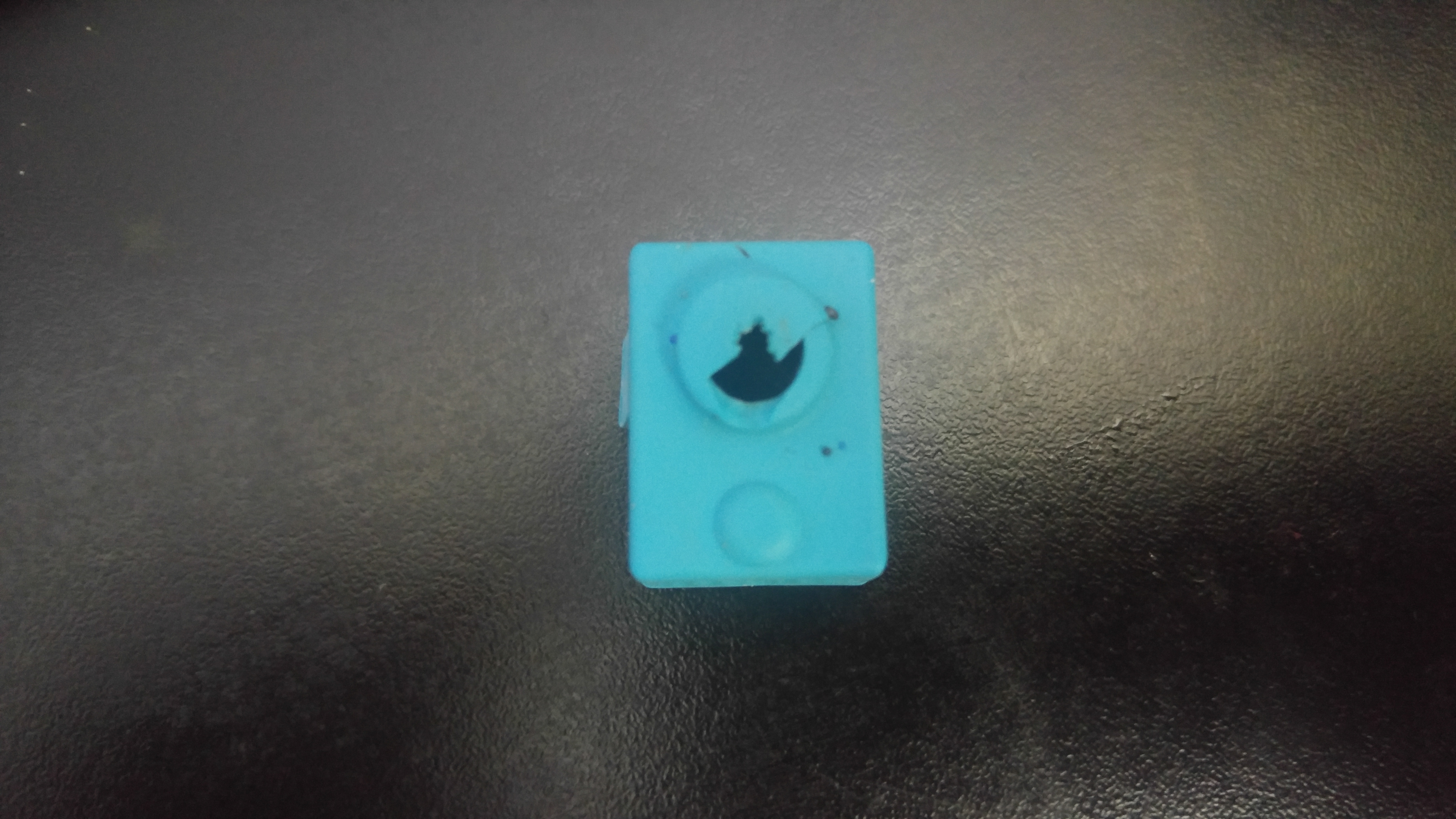

E3D Sock v Bulldog Clip - Bulldog clip wins. Have now killed 2 socks this way. I really need to find a better way to clip the glass bed in place that won’t ruin a Sock…

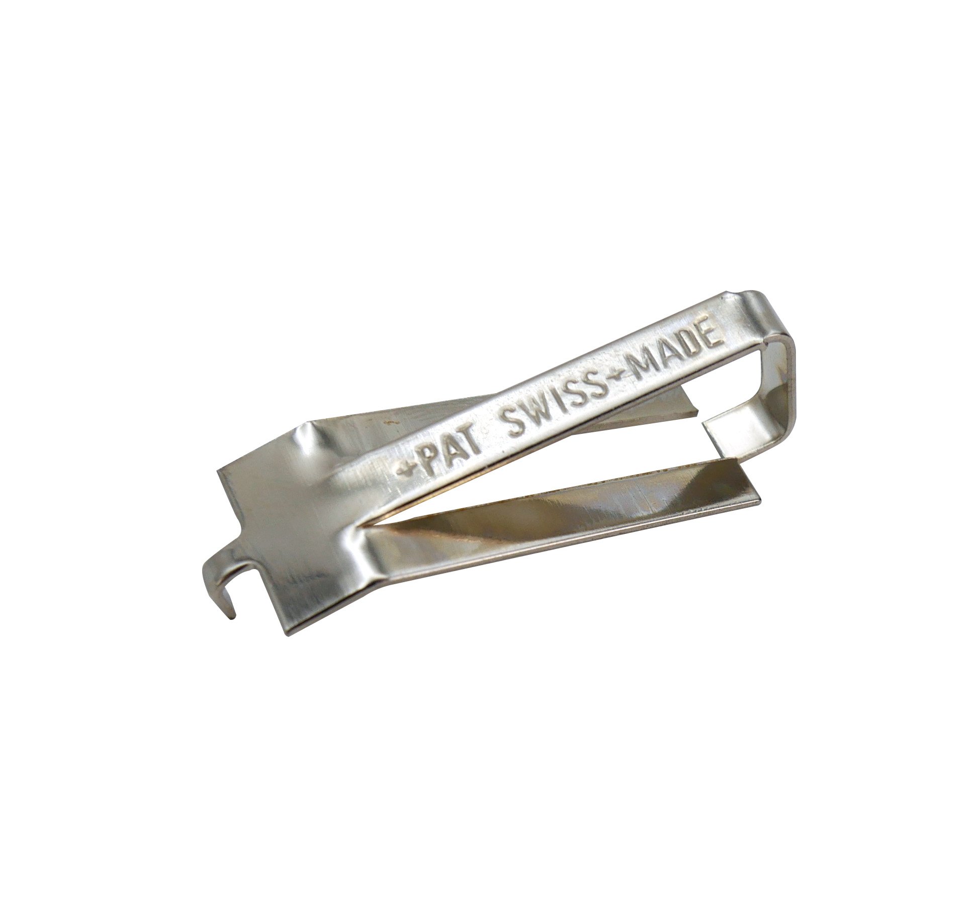

You can use something swiss clips to hold the glass to the plate…
@Benoit_Miller - Aye, had looked at them, they are the lesser of 2 evils with being low profile…

http://e3d-online.com/Mechanical/SwissClips
