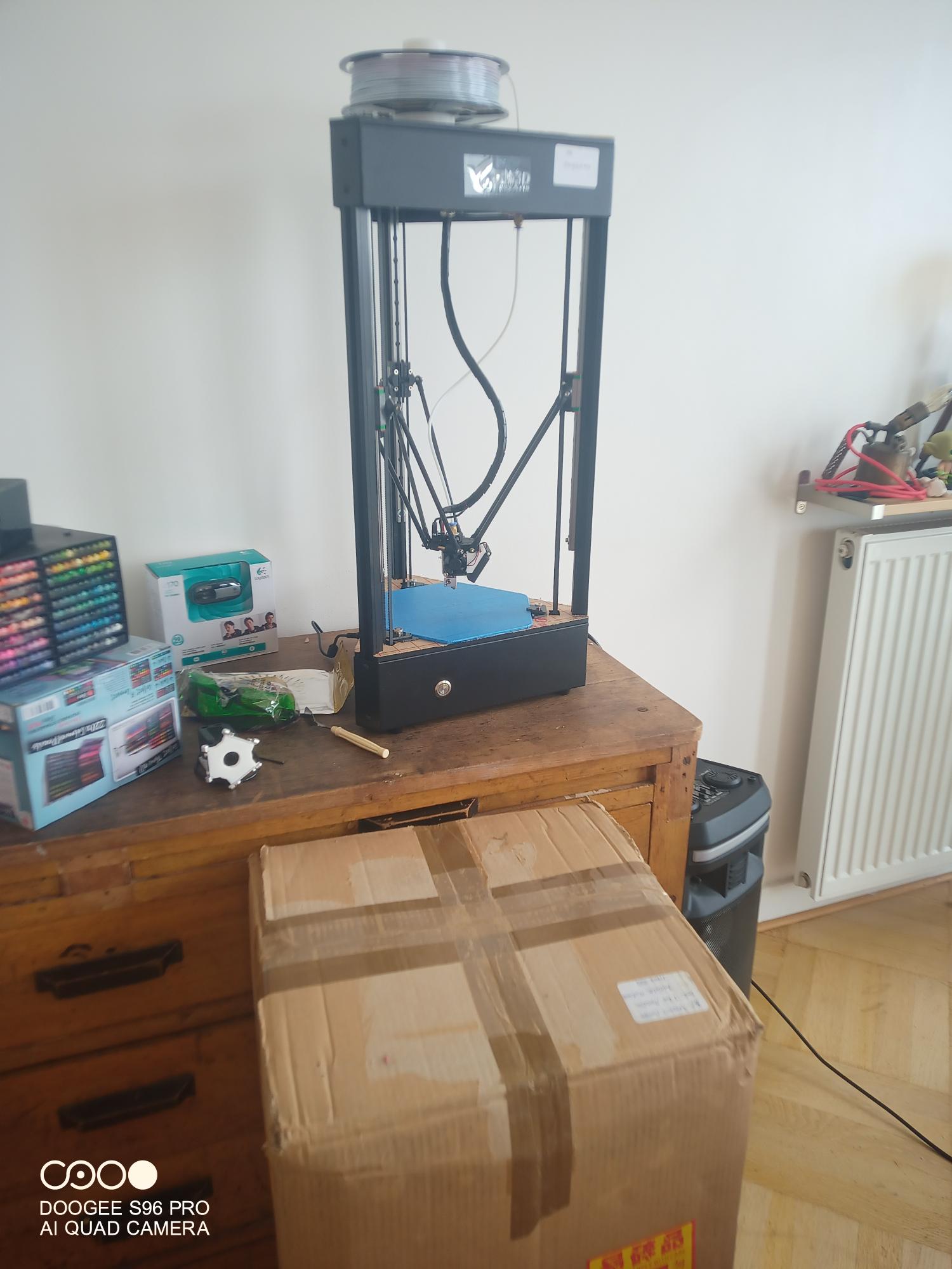

Hello peoples! Quite new member humbly asking for assistance…Many years ago I bought the above mentioned 3D printer through Indiegogo, and once I received it, I checked the contents of the box and then said to myself “I’ll get to the printing later”. “Later” turned out to be 8 yrs later. I finally got the thing out of the box, put it together and since there are no instructions on how to use it I’ve searched online but unfortunately I can’t find anything useful.
Apparently the manufacturers closed up shop, and removed their website. That’s why I’m reaching out to you all, maybe you know how to set it up with the computer, the software to use, etc, etc? Or know someone who knows? I’d be forever grateful for ANY help you can throw my way. I found a post with the contact info for someone who apparently used to work at Easy Arts, i’ll give that a try as well.

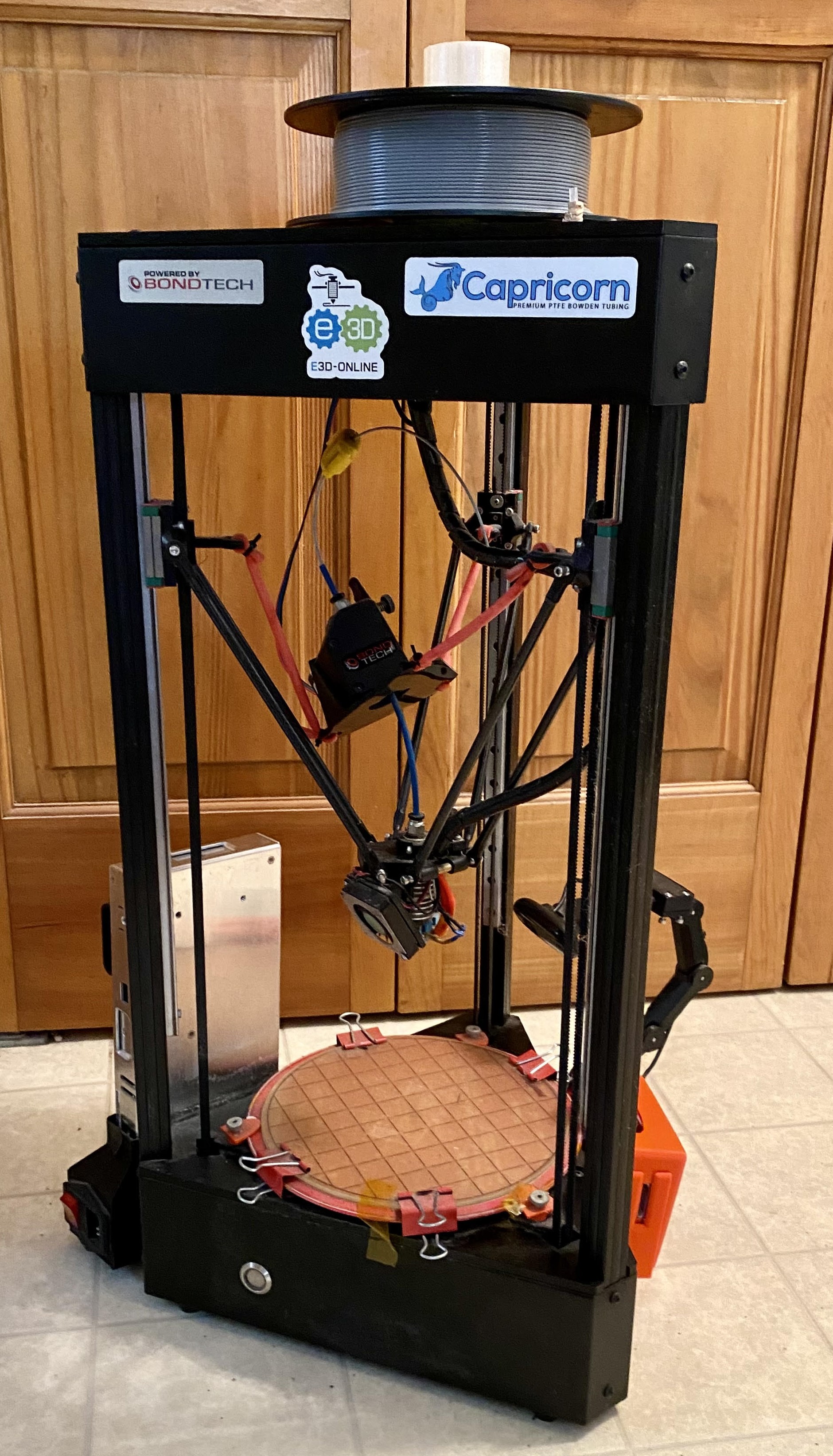

It looks like you did a great job assembling it! Don’t worry about being a noob; we all started from the same place… you will do just fine.
I had about as much fun playing with the printer itself as I did printing from it; this is what my Ares looks like today after adding many different parts. I added a new extruder, thermal plate, power supply, control screen, and other parts. I love seeing the contrast between an out-of-the-box Ares and one that has been through hell and back!
