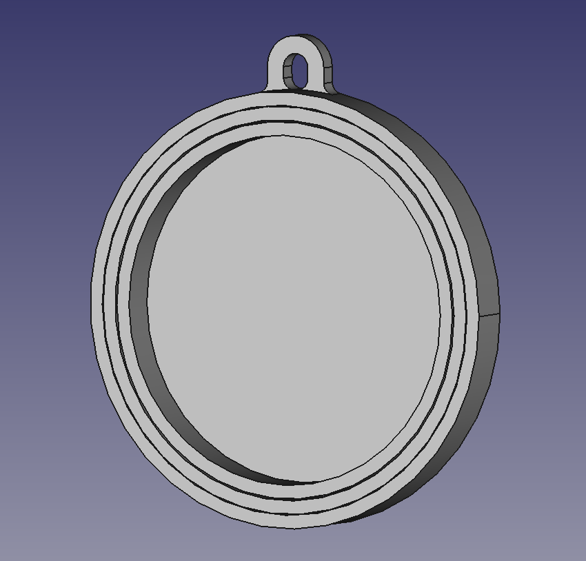

My daughter has been learning needlework, and wanted custom sizes of embroidery hoops to display her handiwork. So we sat down with FreeCAD and made a parametric design to 3D print that snaps together around the fabric and has a hoop to hang it from the wall. It has an outer ring with a hole for a hook, a middle plain ring that holds the fabric in place, and a plate that tuck the fabric around the back and holds it neatly out of the way.
The pieces print in place but slightly separated; the fabric occupies that space when they are snapped together.
The innermost part can be installed either as printed or inverted so that it bears against the fabric.
