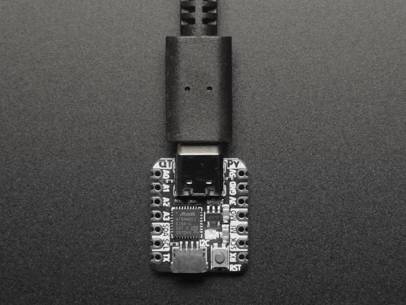

The idea is to use an Adafruit QT Py - SAMD21 Dev Board
with a Adafruit MCP2221A Breakout - General Purpose USB to GPIO ADC I2C
to provide a keyboard and mouse pass through to another computer.
