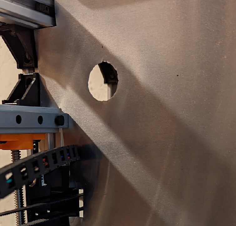

I have learned that one way to cut the aluminum flashing is to score it deeply with a utility knife, and then start a tear (with pliers, or scissors, or a chisel, or something), and if I hold one edge down and pull gently up on the other side, it will tear nicely along the score. It also cuts easily with kitchen shears, and is thick enough to cut holes with a forstner bit in which to install grommets. Sadly, I thought of my forstner bits after I had used a chisel to cut the hole for the laser beam! :roll_eyes:
Getting the measurements right for fitting the back in place around all the bits it had to fit around was rewarding where it worked well:
I had to slide the bed frame out the pass-through door to get the back installed:
I will probably use some aluminum tape and aluminum scraps to reduce airflow around where the Z belt goes back to the Z motor; that’s a big hole:

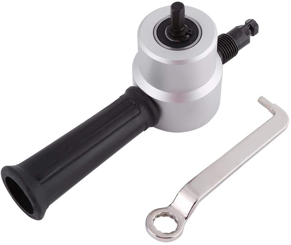

I ended up buying a rexbeti variant that includes a replacement cutting blade and head, as well as a jig for circle cutting and line following. Still not super expensive. I’ll get to use it soon…
Let us know your experiences with it.
…wish they sold those attachments separately, may have to DIY them.
