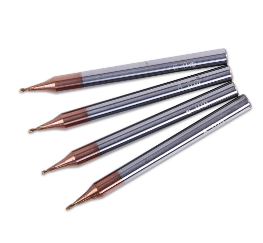

this is the endmill we are using right now,
endmill-china ,
the tool diameter is 0.8mm, is it too much?

The drill tool is made of Tungsten, and it is 2 Flutes Carbide Flat Square,
Thanks for your information
“Tungsten Carbide” would be the material. Carbides are stiff (and brittle) and the material won’t matter for chocolate, honestly, though the coating might. But anything optimized for plastic will have a polished surface, I think.
Here’s an example of what I would suggest instead:
https://www.harveytool.com/products/tool-details-52431
That’s a 1/32" end mill, which is almost exactly .8mm
Here’s the family it comes from:
https://www.harveytool.com/products/end-mills-for-plastics---square-upcut---single-flute/?creative=272770386416
Here are things you care about from the feature list:
  • High rake, high relief design produces sharper edge for improved shearing action while transferring heat into the chip
  • Large flute valley creates room for the chip and aids in chip evacuation
  • High flute finish resists chip welding
However,
  • Slower helix reduces lifting forces
If I were specifying a custom-ground endmill for chocolate, I would probably choose a faster helix to promote chip evacuation. But this is not a mainstream use of endmills, so you just get the best you can. :smiling_face:
If twice the diameter (about 1.6mm) would work for your application, I would consider this bit instead, optimized for soft plastics (not available in the .8mm bit):
https://www.harveytool.com/products/tool-details-51862
