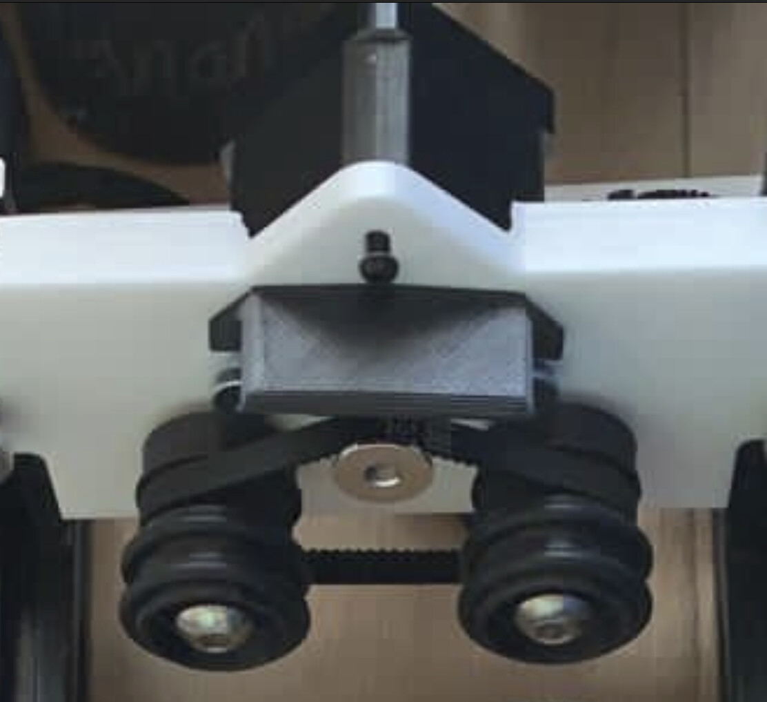

What stepper motor is your rotary using and what type of belt pulleys?
I looked for motor information but nothing attached to it.
Usually the stepper motor will have a part number somewhere on it, and that can almost always be decoded. It’s usually on the back.
It could be that this is simply rotating further than it should for each step due to the choice of stepper motor and gear ratio on the pulleys.
Engrave two lines a substantial distance apart (say 50 mm) and then measure the distance between them with a flexible tape wrapped around the object. If it’s longer than it should be, then that’s where your problem is.
From zooming in on your picture earlier, it looks like a GT2 belt with a 20 tooth drive pulley on the stepper and a larger — but I don’t know how much larger — pulley on each rotary wheel:
It also looks like it’s at least partially a 3d printed kit. Share with us all the information you have on your rotary kit. Don’t hold back and make us guess.

If you’re already using a scanline step of 0.001", you could replace the (presumably) 1.8° stepper motor with a 0.9° one or add some gear reduction if it’s a DIY rotary.
If you replace the M2 Nano with another controller, you could change the micro stepping.
And there is also the option to defocus the beam a bit, but I’m not sure if a K40 has enough power for that. You need more power if you want to remove paint with a wider less focused beam.
