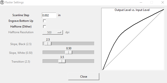

I’m not a K40 whisperer user, but if you go to Settings—>Raster Settings you can change the “Scanline Step”. You need to make it smaller so there is overlap between each step of the raster engraving.
Perfect! Is there like a formula to calculate that number? Or just try-error method?
Do you recommend another software to work with the machine?
Hmmm…So if you are using the 0.002 as a scanline step that should actually be fine as the laser beam should be around 0.0055". Are you using a rotary setup? If you are then it’s probably related to that actually.

What is your scanline step set to?
Hi Ned
It is set at .002in
Have read through this, maybe your rotary needs adjusting. Perhaps check the nema 17 stepper is 400 steps like the others.
You can trying lower it to 0.001" which is the lowest it can go in K40 whisperer. Just to check, are the lines in that star part of the actual graphic?
