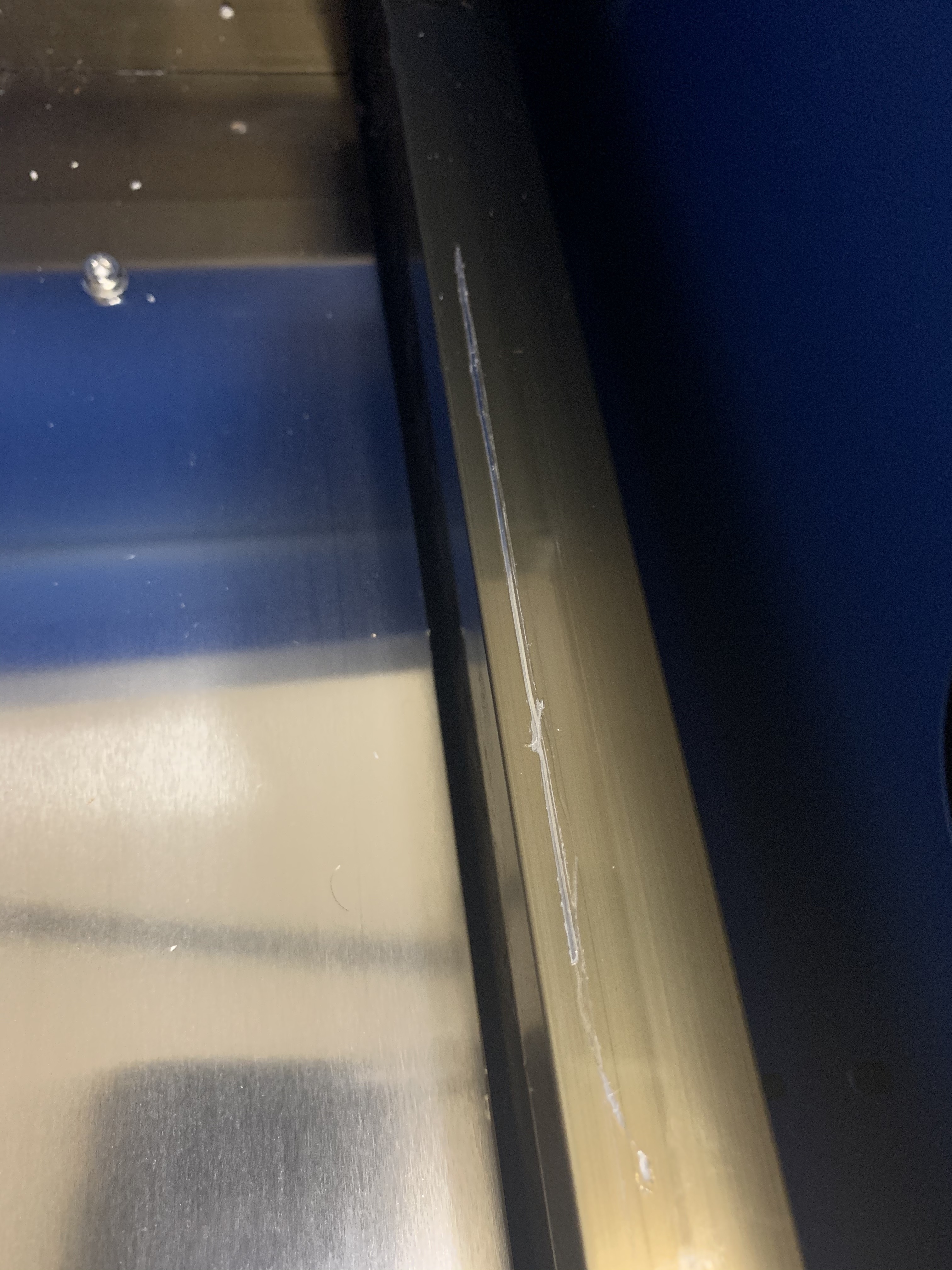

My K40 did arrive, but has a rather nasty gouge in one of the Y-axis rails though. Looks like a chunk of metal got stuck under their in transit, and scratched the bejaysus out of it. Don’t think it’ll “buff out.”
