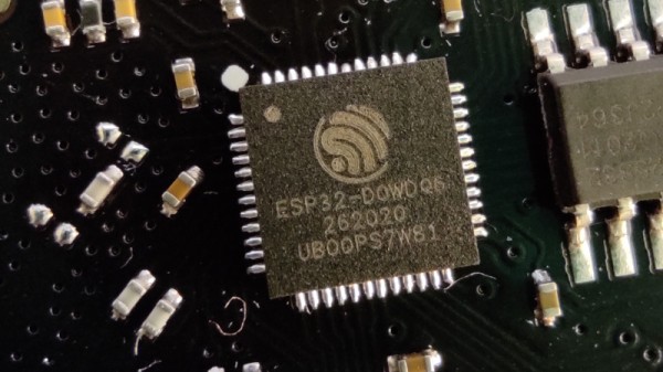

These esp32 variants are usually less costly than a PI… I think they are much like the @Ernests_Brigis board…
