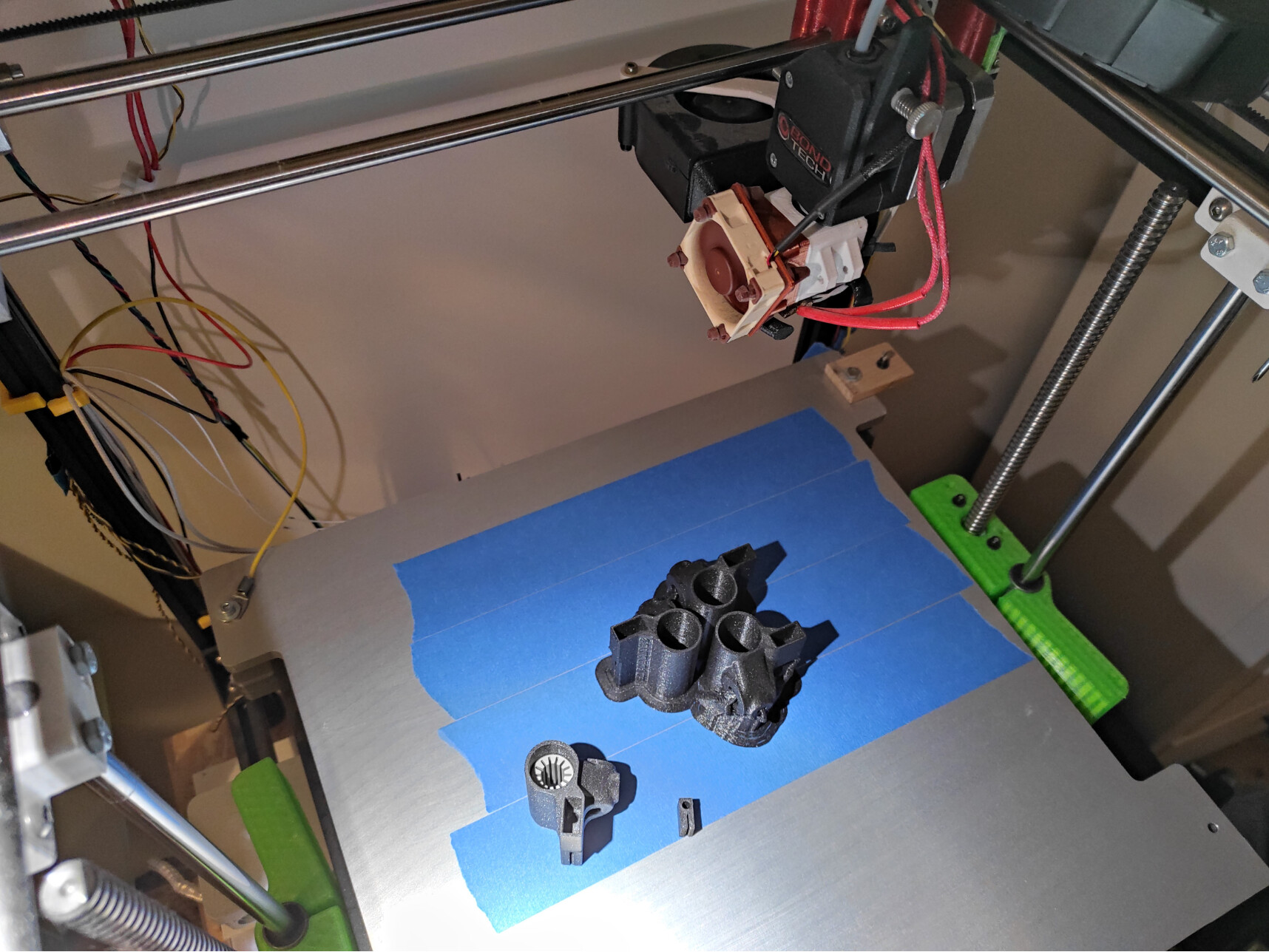

How do you print those complex parts like XY Side Carriage Zane? I am trying to adjust them for igus bearings but its a pain.
The side carriages print standing up (circular bearing opening on the build plate). I was able to print mine with no supports in this orientation. But if you printed with supports it wouldn’t hurt it.
Hey Eric, thanks for the reply! A couple of days ago I would have considered these more or less unprintable but they actually came out pretty much perfect. I did use some support though.
