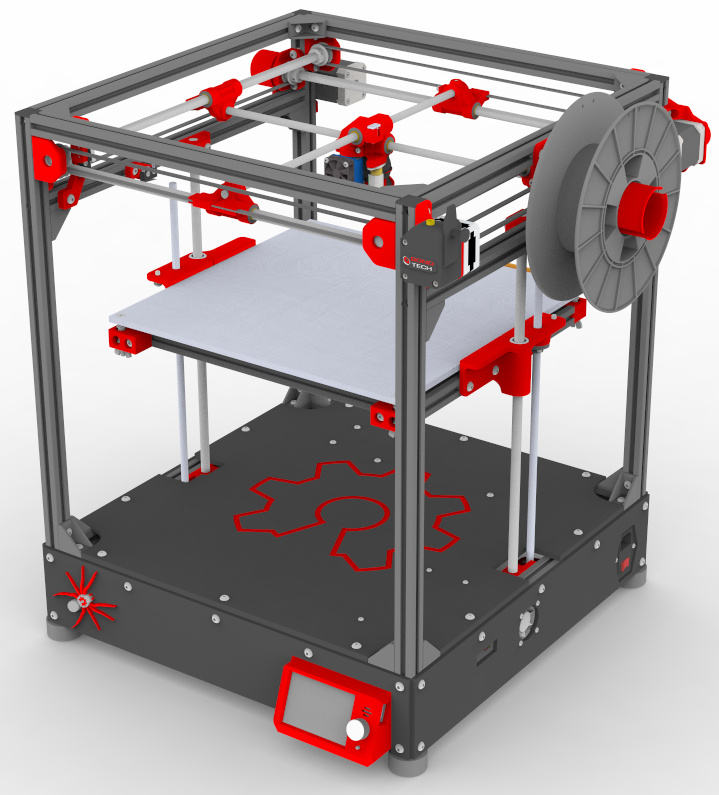

Hey Everyone. A member of the community decided they wanted to build a Eustathios Spider V2. So it was finally the kick in the teeth I needed to update the model, documentation, and BOM for the most recent community upgrades and the most recent parts people tend to be using. I call it V2.5. It just went live today, and I am sure there are issues in the documentation, Github, and models. But I think it is a vast improvement over the last model and drawings. If you see something that needs correction let me know.
Hopefully it can be useful to people, and even if they don’t plan to build one perhaps it can act as an inspiration. Similar feel free to cannibalize the model if you find bits useful for your own project.
Here is the link: https://github.com/eclsnowman/Eustathios-Spider-V2.5

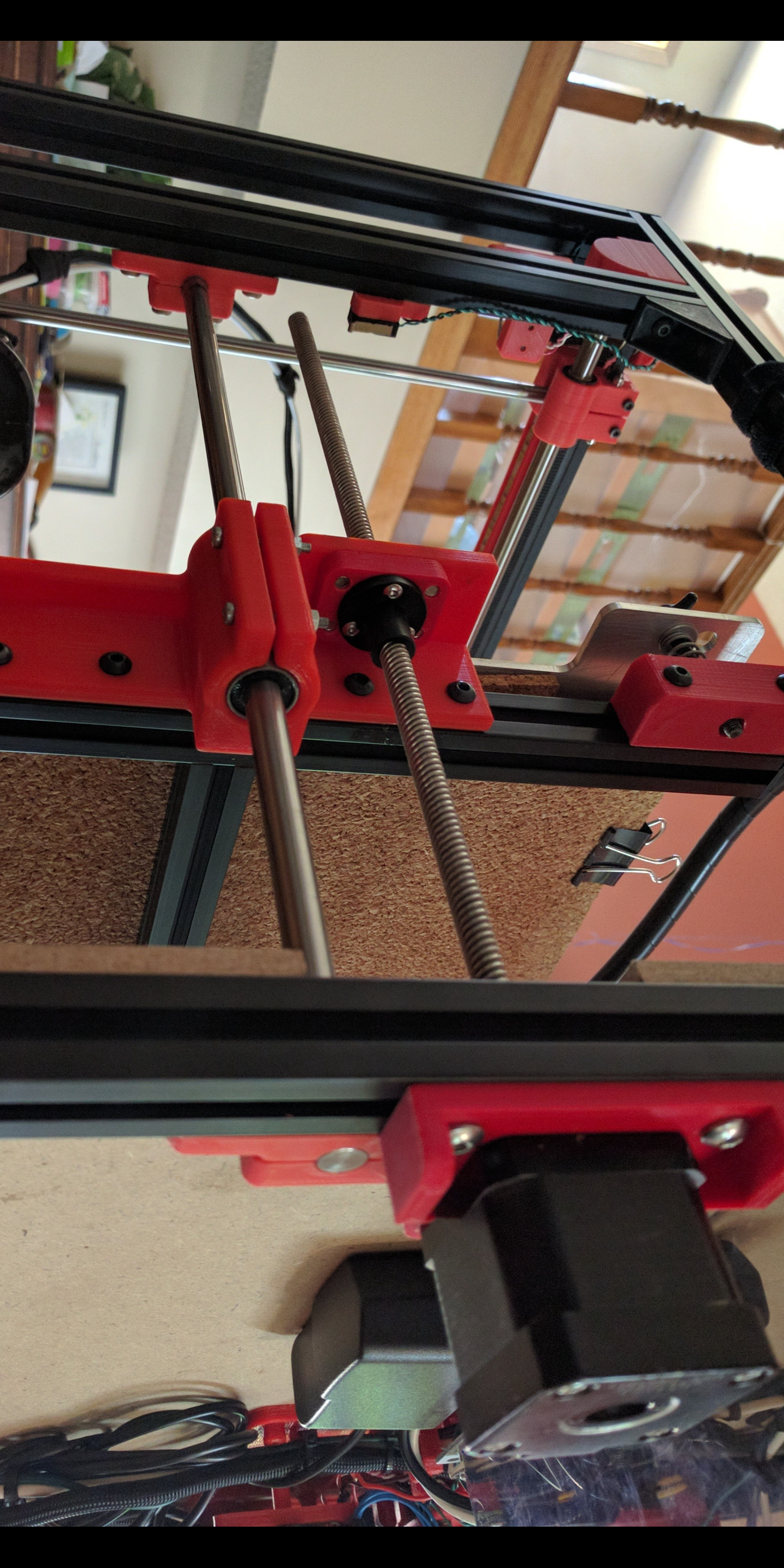

Looking at switching the z axis on my v2 to the 2.5 setup with dual motors. Do you know if the spacing on the original z axis bed supports changed between versions? Would be great to not have to reprint those parts and just swap out the motor mounts.
Bed support rod locations didn’t change. The only two things that changed are adding the independent motor mounts for the two z motors and those even kept center line with the old lead screw locations. And another z rod mount below that is identical to the top one. On mine I didn’t even originally change the bed side supports, I just printed an adapter from the misumi lead nut, to the new style lead nut.
I also changed the bed extrusion supports to add an extrusion on the front and back, versus one in the middle which locks the dimension side to side. I wanted the adjustability on the front and back in case extrusion cuts or printed parts weren’t perfect. Don’t want things over constrained. Along with that I switched to just a square cut quarter inch thick cast plate for the bed. Easier for people to source and manufacture themselves.
Nice ok should be an easy upgrade then. I’m hoping having the direct motor mounts for the acme rod will give me a bit more adjustability and I can finally iron out the z ribbing I’m getting.
Go with tr8x8 on the z motors. Makes zhop fast and there’s plenty of the resolution still. And in Marlin you can do independency z motor leveling now. So you can either put an endstop switch on each side, or just use a BL touch and it will go up, then level on one side, then move to the other side and then level there so you can have it trammed side to side and then you can do mesh leveling on top of that.
I have whatever was in the original v2 bom. I think that was a tr8x8?
Oh, on the new design it uses integrated leadscrew steppers. So the leadscrew is the motor shaft.
