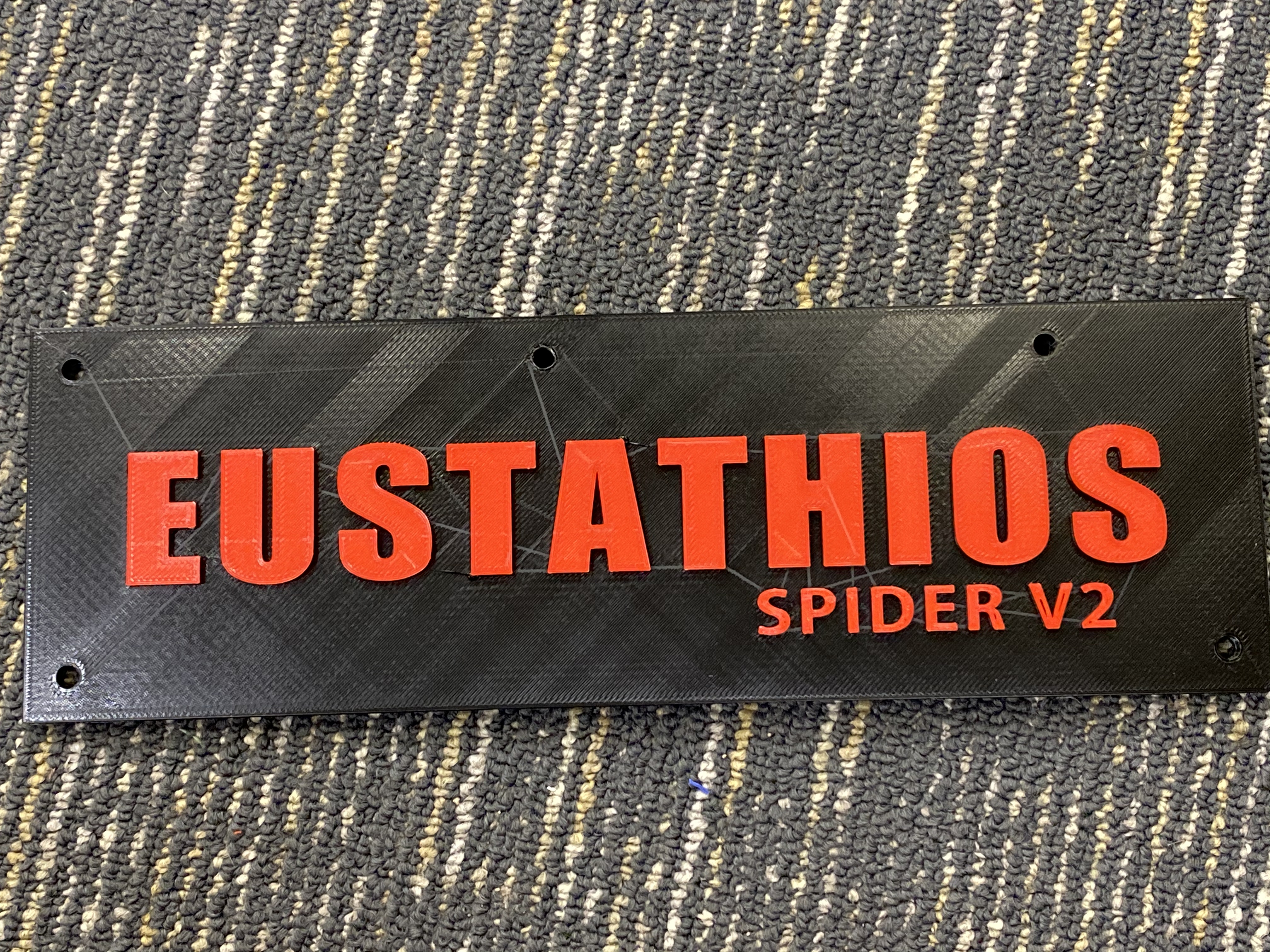

I’m changing the front a little. Instead of the acrylic, If this works out it will have these letters on a black 3d printed back.
E3D Hemera Bowden Style

This turned out ok. I’m going to mount it on the lower left next to the viki 2 display.
Looks slick! Are they glued on or did you do a filament change?

The red letters are from changing the filament mid print.

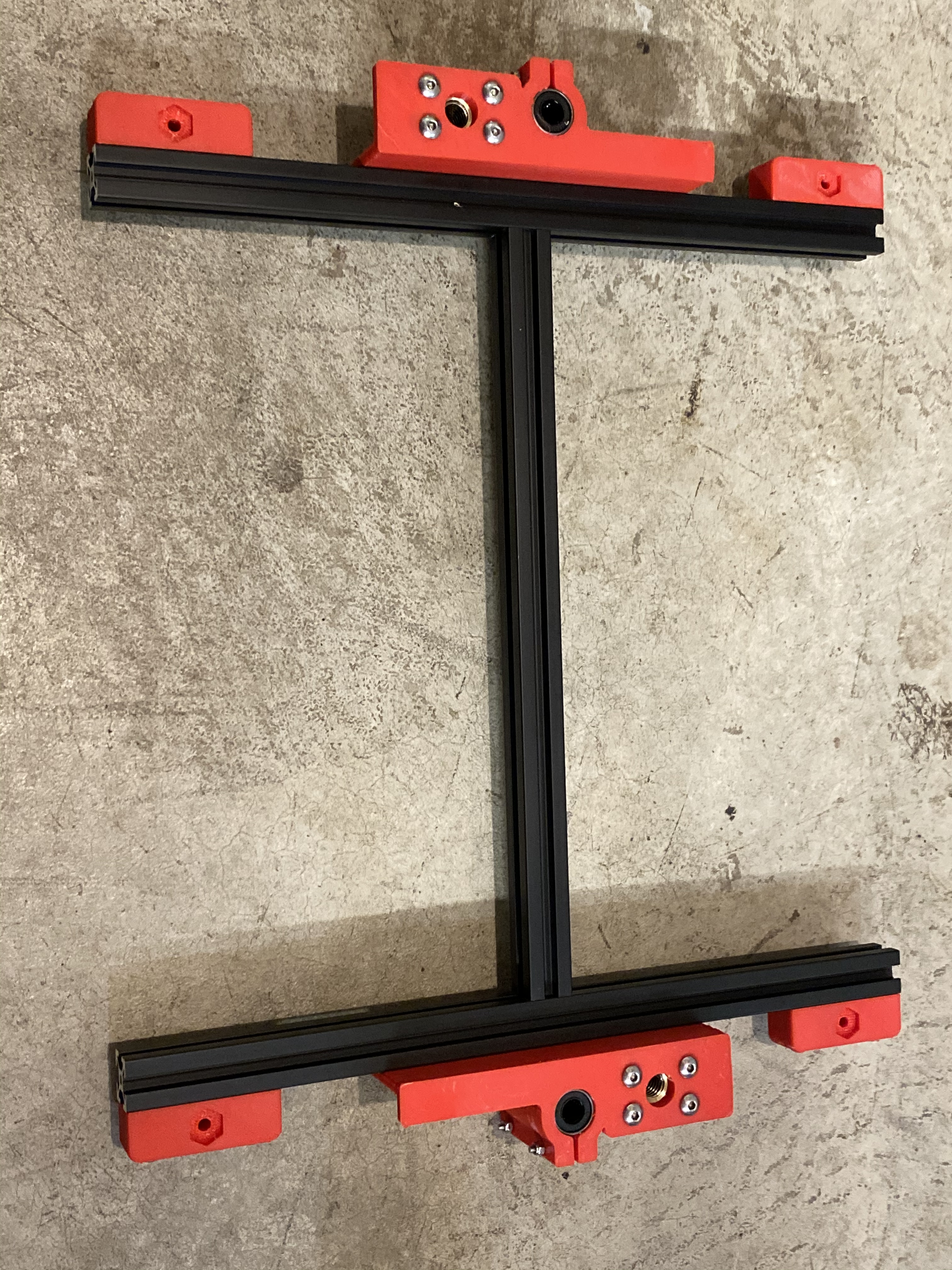

Why did you reprint the bed mounts?

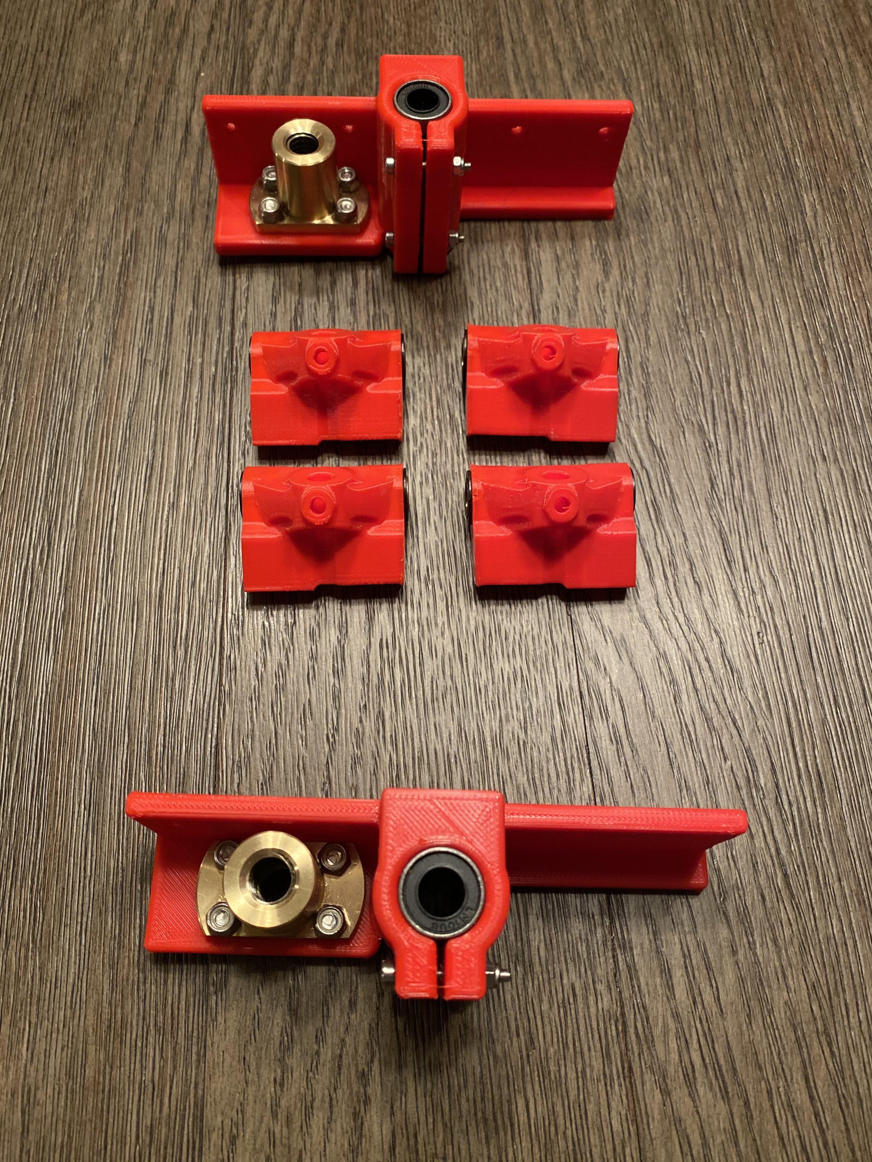

I reprinted the bed mounts because last time I printed them in PETG and they were cracking. This time I printed it in PLA again. I’m using the SKR 1.3 with sensorless homing.
