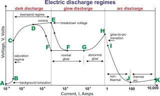

Co2 lasers require very high voltage power with simple to no control of the current. CO2 lasers are gas discharge (negative resistance) so they output very high voltages until the ionization potential is reached, then the device discharges and the voltage drops dramatically while the current ramps. These supplies are by no means standard power supply designs, are dangerous, and notoriously unreliable due to the high voltages.

Consider that every time the L signal is asserted by the controller the laser discharges in this fashion.
The importance of the laser current VS pot setting cannot be understated. This is the characteristic curve for the laser tube.
