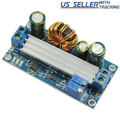

I’m trying to convert dead DeWalt XRP+ battery packs from nicad to Li-Ion using 5 18650 batteries, a 5S BMS, and a CC/CV charging circuit. I could very cheaply feed in 24V to charge through CC/CV buck converters (about $2.50 each), or for $6 I could almost not care about the input voltage and charge from practically anything in the 12V-30V range, if I can fit it in the pack with the BMS and cells:
The larger, more expensive, more flexible board is also less efficient, it seems. But the idea of having the flexibility to be able to charge this straight off a car, or more efficiently from a 24V power supply, is attractive.
It says it uses a “single-ended primary-inductor converter (SEPIC)” topology, which isn’t something I know about. Any experience/advice?
Edit: As best as I can tell from pictures and advertised size, neither unit will fit with the BMS and 18650 cells into the existing packs. On to plan C.
