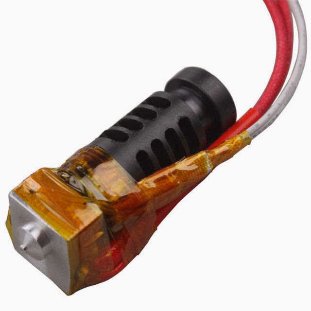

I’m not very happy with the experience I’ve had this far with the K8200 stock extruder and hot-end and would appreciate some advice on what replacement hot-end OR extruder + hot-end I should buy because i’m not really up to date with what’s what.
Picture possibly related.

Is that the real J-head MkV in the picture?
+Denys Dmytriyenko: yes
