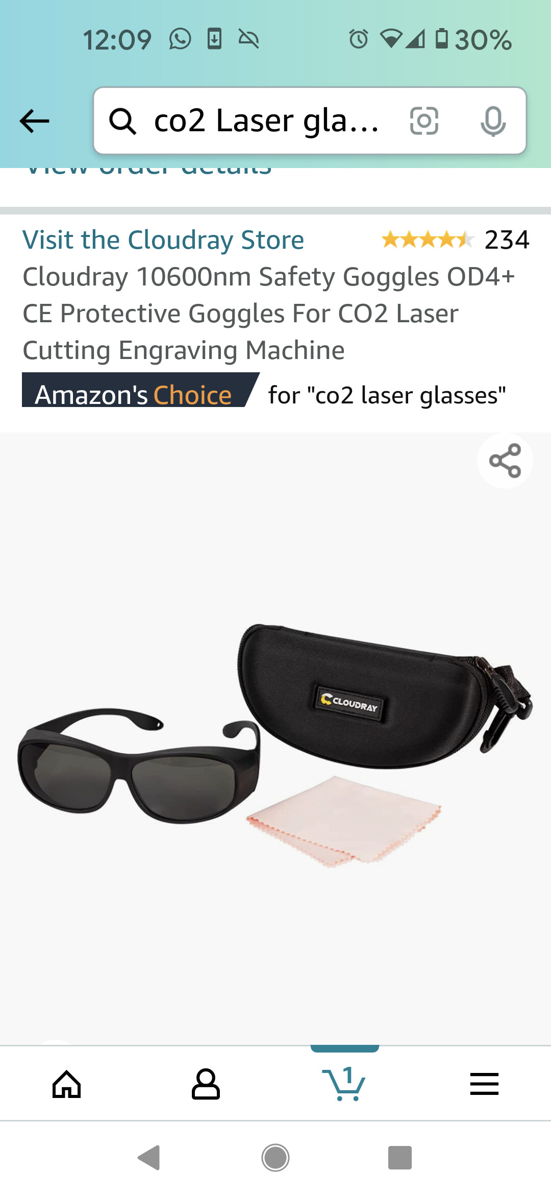

Hi guys - I bought these Cloudray laser glasses - they ticked all the boxes in the description but didn’t come with any certification / etched ratings on either lens or frames - should I replace them? If yes, does anybody have a good recommendation for a pair around £40? Thanks so much
Glass, acrylic, and polycarbonate are very opaque to far infrared, such as what a CO2 laser creates. The key for the glasses is the protection at the sides. These have that protection. The tint is to protect against bright flashes of visible light.

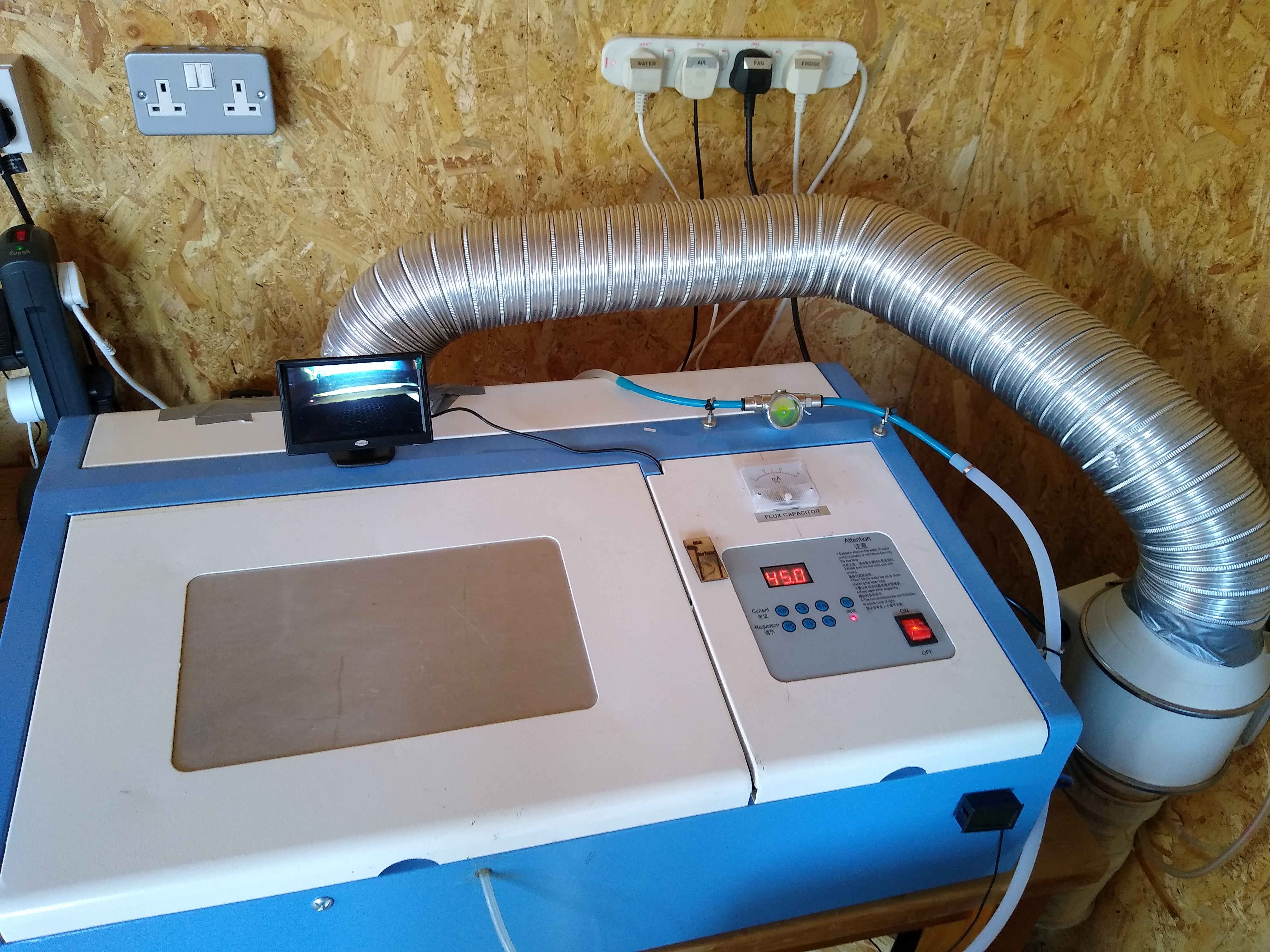

Mine caught fire once, due to using vinyl transfer tape to stop the wood being stained whilst cutting/ engraving. It melted the plexiglass, so I replaced it with aluminum sheet. I now have a reversing camera and screen to keep an eye on whats happening inside. NEVER leave the machine unattended, if I hadn’t been around my man cave would be a pile of ash!
