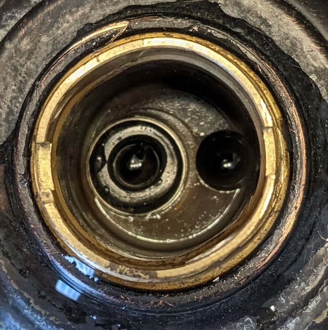

Turns out that the plumbers who installed my bathroom plumbing were not particularly gentle, and several of my faucets were damaged. Here you might be able to see that the portion of the faucet body at the upper left is a bit flat.
I measured undamaged areas below and above the seat, and determined that they were 20.5mm and 21.5mm respectively. The damaged side was bent in about 0.5mm at its worse. Not enough to leak (the leak is around the inner stem o-ring, not the outer o-ring that is against the bent part), but enough to make it really hard to run the retaining nut on.

Love it Michael! At first I’d thought you were talking about the o-ring/seat at the bottom of the hole but started to figure out it was the large threaded hole itself. I can see the ‘flat’ in the upper left of the first pic and how it’s mostly gone in the 2nd pic. Well done!
