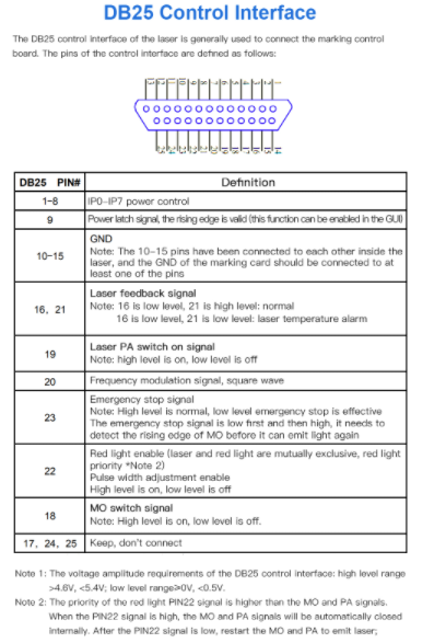

It may be easier to use the DB25 interface as it has discrete signal controls. Didn’t spend any time looking to see if the smoothie has enough programmable ports to drive it.
The biggest challenge it seems to me is what controller software is needed/available to create the needed fiber interface.

I don’t think that smoothieware has a module that would support breaking out the power level into pins 1-8 which are clearly an 8-bit power level. I might be wrong, and when @Arthur_Wolf is around he can certainly say for sure.
I was curious so did some more surfing …
This doc shows more detailed specs for serial Rs232 and parallel DB25 interfaces that closely matches the connector assignments shown in the above DB25 definitions above.
It seems there is a lot of functional and control signal conversion needed between a CO2 style laser control and a fiber one.
Yeah, one of the problems I wasn’t thinking about for the parallel port DB-25 interface is that it’s specified at 5V TTL and the smoothieboard (as you would expect for a modern device) runs at 3.3V. So level shifters I guess?
