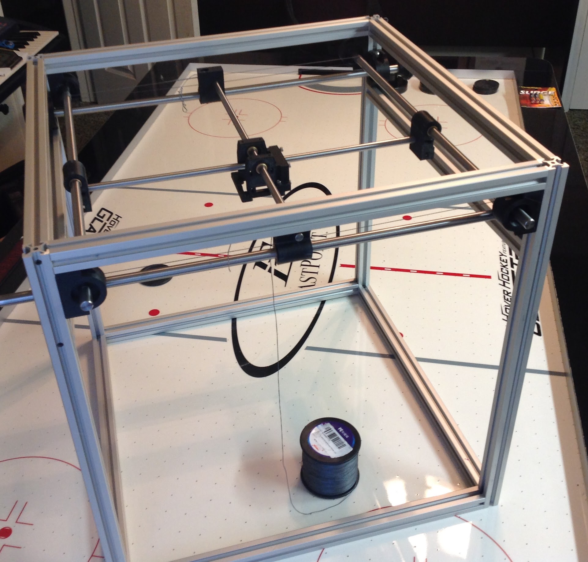

Figured I might as well show my progress on the Ingentis also.
Figured I might as well show my progress on the Ingentis also. Waiting on bearing for the 10mm shafts. Trying to figure out how to get the Spectra tight. @Tim_Rastall @ThantiK
Us Deltabot folks use zipties, wrap the spectra around the tie three or four times, then ratchet it up to take up the slack. There’s some dead space under each arm that you can use, dunno if there’s similar space to do so on the Ingentis.
guitar tuners seem the new go to way of tensioning spectra.
I’m going to be trying the guitar-tuner method - we’ll see how it goes. I’d be willing to bet there’s a knot you can tie at the ends of the spectra that would allow you to do the ziptie method that is commonly found on repraps, but I’m not that far yet.
Danger will Robinson. Guitar tuners have not been proven to work yet. Once they are tightened, you won’t be able to adjust shaft alignments. Sublime has a guide for spectra tightening on his Tantillus build guide. http://www.tantillus.org/Build_3.html#cables
AH HAH! I like that method! What kind of knot do you tie in that end? (i.e. best kind of knot for that use?)
Surgeons knot or Palomar knot
Palomar knot looks like the right one, I’ll try it! :slight_smile:
@ThantiK There are ‘no bobbin’ xy ends on the youmagine Ingentis Page. I think I fucked up the upload on one of them but you can just mirror the good one. For me they print just fine in abs with supports (Cura, sliced) make sure you have thick perimeters and high infill, they are a high stress part. You’ll need to heat the self aligning bushings up and carefully press it into the ends, otherwise they can crack.
How do you like the Kraken carriage @Sonex128 ?
The narrow side piece that is cut out for the rod doesn’t have the holes for the nuts. I may modify it to fit my hotend, really can’t afford a Kraken right now. @Tim_Rastall
