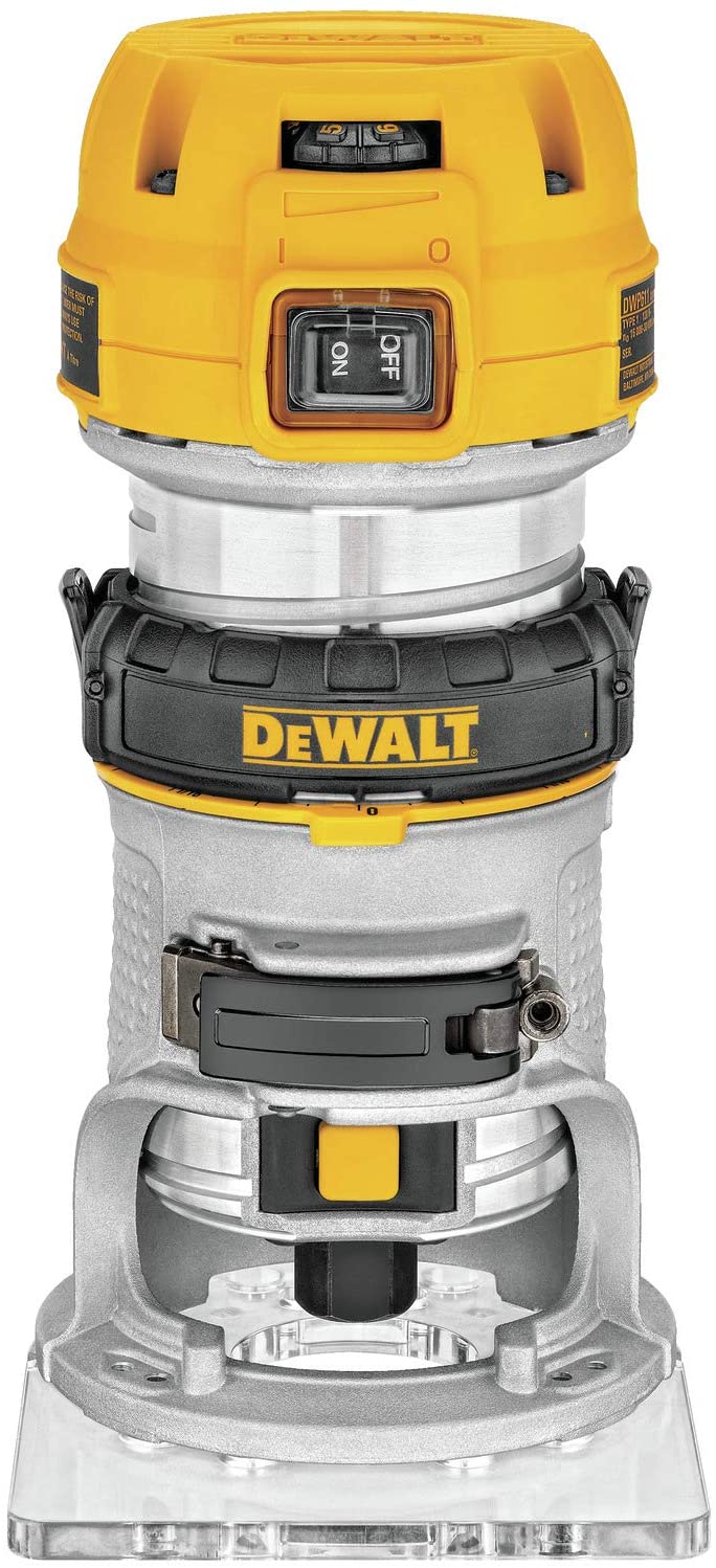

What about the (in the US preffered) DeWalt Router or a Kress/AMB 1050W Sprindle?
(You can even get a AMB 1050 FME-W DI with an integrated automatic tool changer)
DeWalt is in the “don’t want to re-purpose a hand router” category — I want software control of spindle speed, for instance.
