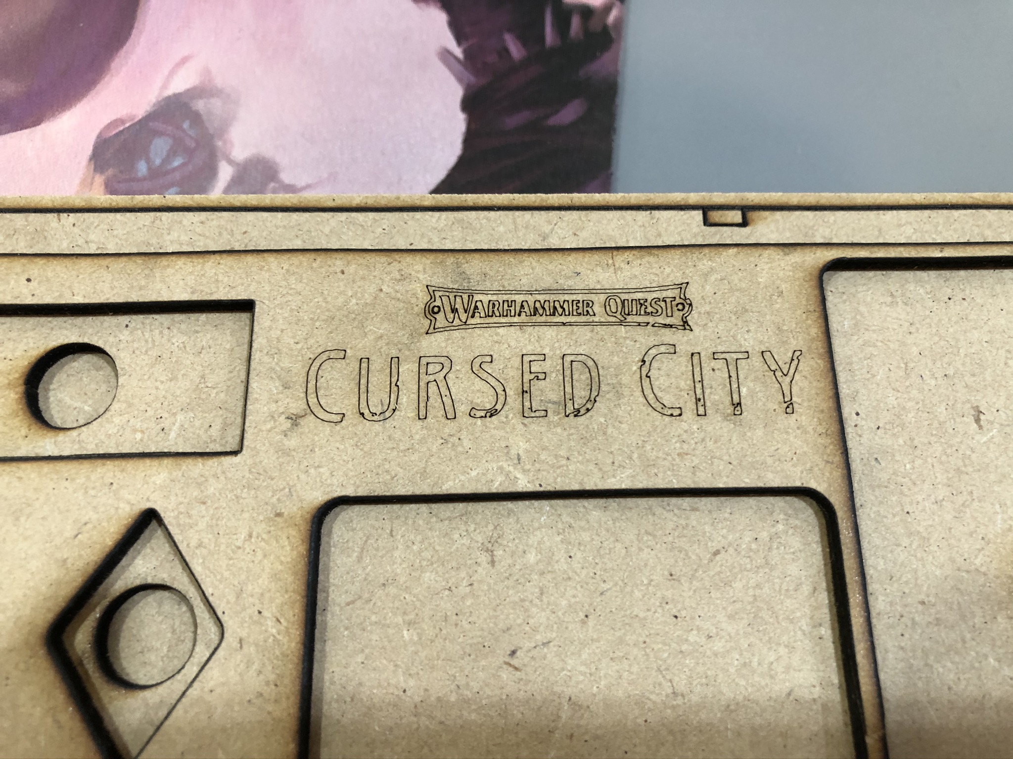

On my first test, engraving MDF 3mm, I did at 20 mm/s at 10% power.
But the Diode one was much nicer:
This the diode one.
And this the K40 one.
ANy idea how to improve it?
Thanks.
Was the one done on the K40 raster engraved or vector engraved?
The K40 will need a lot faster travel speed than your diode. It has a lot more power and therefore can engrave or cut faster than you’re used to.
It is vector engraved.
I changed to 5% power and 20mm/s speed and it has improved. But not as clear and fine as the diode onem, but enough for now.

Yeah because of the higher power of the CO2 laser it’s harder to get a lighter vector engraved. Do you have the work piece at the focal point of the laser?

Diode lasers can genrally be focussed to a much smaller point than CO2 lasers. This is caused by the wavelength. Therefore you will probably not get as sharp engravings with the CO2 as you can get from the diode laser, but still pretty good.
For engraving (using an 80 W tube), I generally use speeds in the 2000-5000 mm/min range (i.e. 33-83 mms/sec). Note that a CO2 laser (especially DC-excitation types) does not perform very well at very low power levels, so you should generally go for as high speed as possible.
