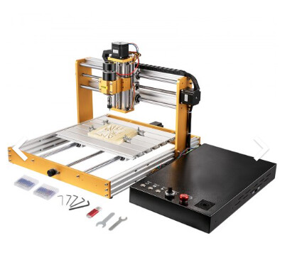

I purchased what was advertised as a 3040 cnc machine from Vevor. I’m getting a shock from my machine and controller box, so I disconnected all connections from the controller box, except for AC to the box itself and no longer get the shock from the machine but the box is still “live.” I contacted Vevor’s support and they suggested I look inside the box to check for a bare wire touching the case which I did and couldn’t find any wire(s) touching the box. They told me my machine was a “4030 Cnc Router Machine, Grbl Control Nema23 Motor” and offered me $190 (I paid $699 for the kit) refund but not a replacement controller box. I cannot locate a replacement box anywhere. A link to the machine I purchased is VEVOR CNC Router Machine, 3040 Engraver Milling Machine with Offline Controller Limit Switches Emergency-stop, DIY 3 Axes Cutting Kit for Wood Metal Acrylic MDF, 400 x 300 x 100 mm Large Working Area | VEVOR US

  4. the entire metal body of the machine gave the “tickle” as did the entire case of the control box
