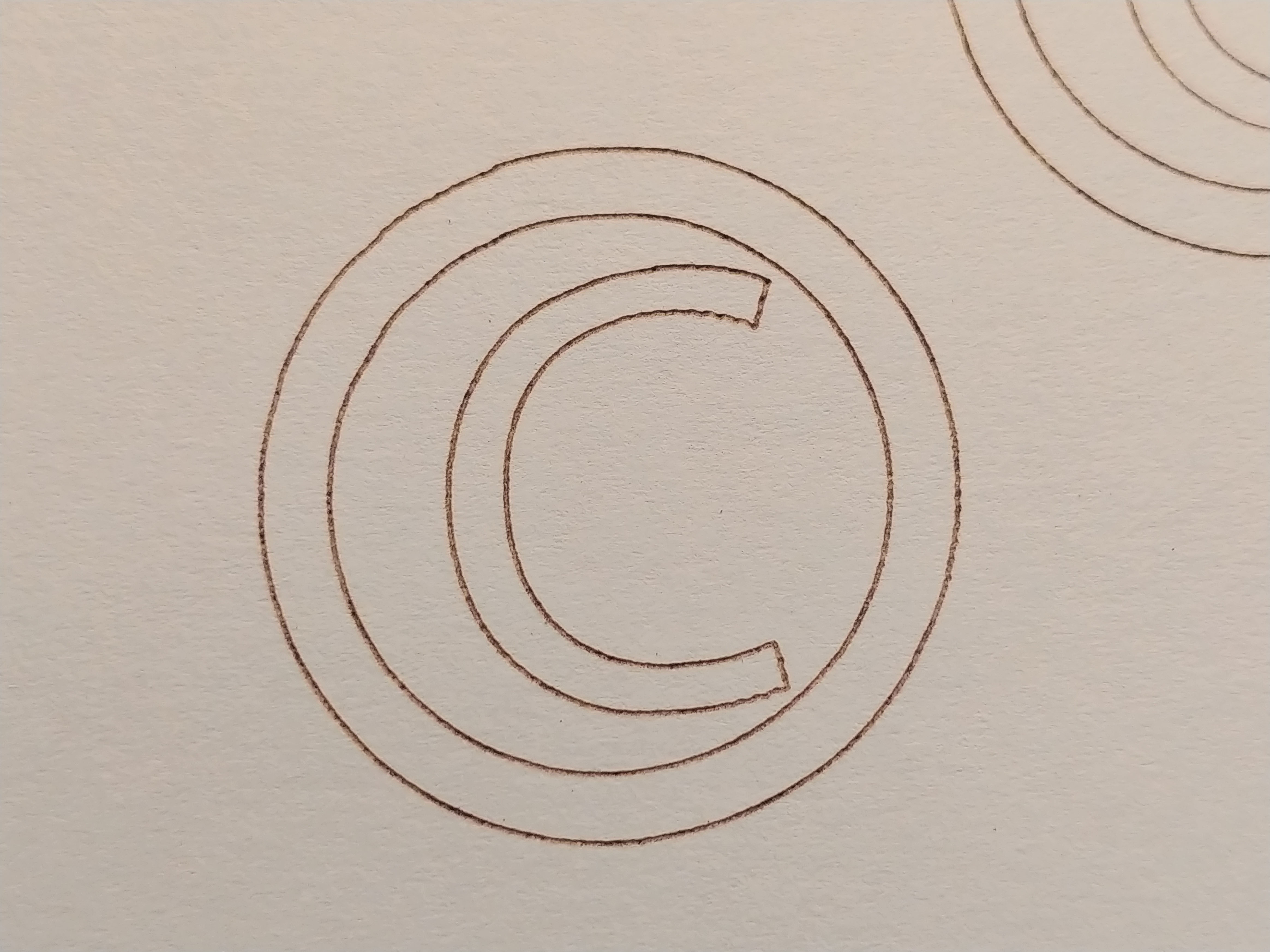

I’ve been calibrating it for a few days. I think it looked pretty good. There is less than a millimeter difference in the focal point of the four corners of the machine. The cut is quite good except when describing a curve up and to the right. When I cut a circle, between ten and eleven the cut presents small tremors.

Here I leave a print test on 80gr paper at a speed of 30 mms. In it you can see that the outside of the letter c is incorrect but inside it is fine. The difference is the cutting direction, I think.
The effect occur at all speed, yes.

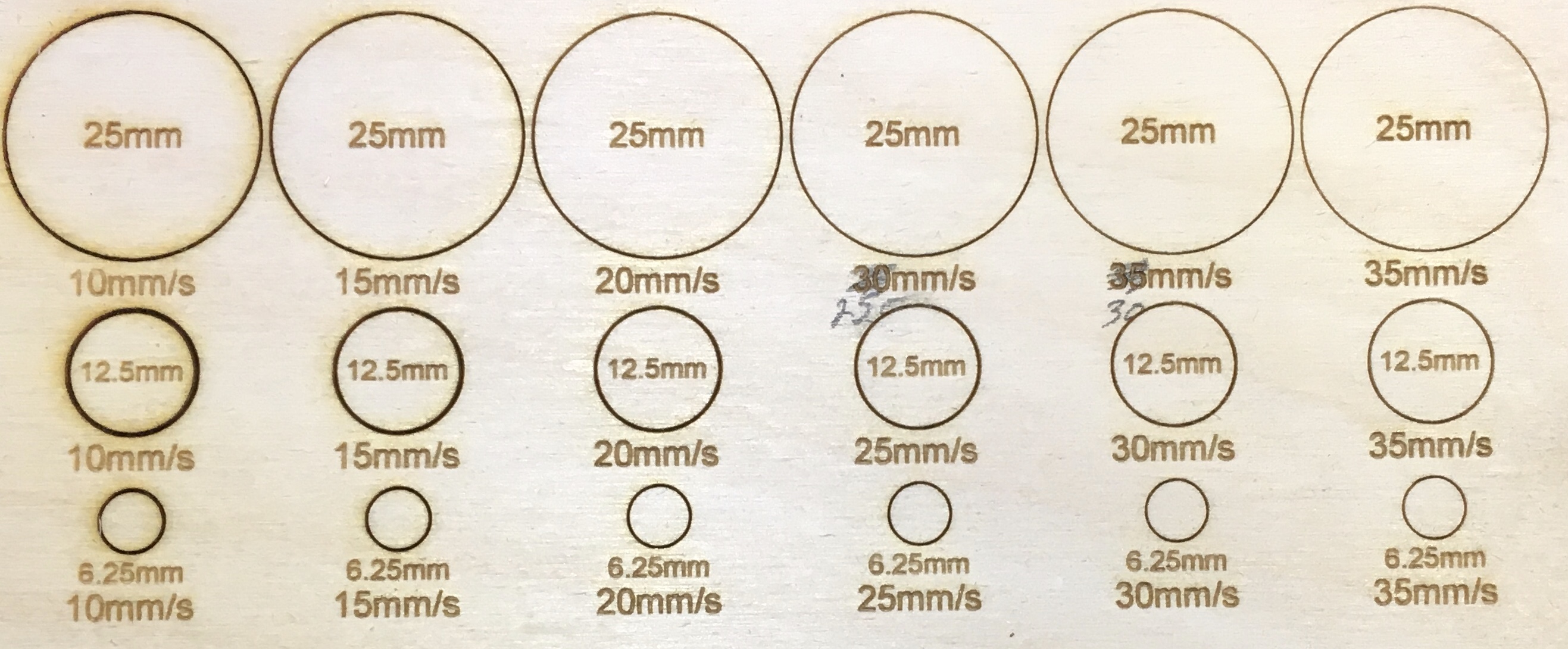

So I’ve decided to do a little investigation.
Did a series of circle vector engraves at different speeds and circle diameters.
Surprisingly I didn’t seen any artifacting up to 35mm/s at any curve radius. If you really magnify the 25mm circles at higher speed you can see a tiny amount. Seems to imply if there is a constant smooth acceleration of the laser head the artifact effect doesn’t really occur. Stock controller.

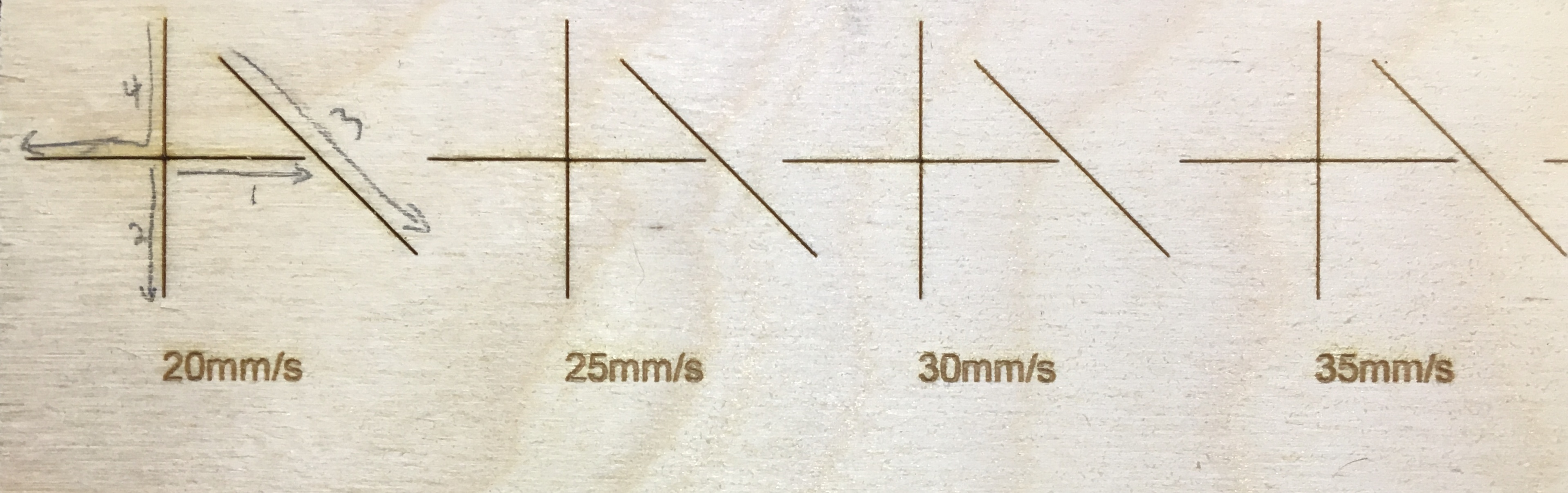

Indeed it seems to be acceleration and deceleration artifacts. Instead of a C can you repeat the test with horizontal and vertical lines ( maybe also 45 degree lines), so we can confirm or reject this hypothesis?

So I made a horizontal and a vertical line as a cross to save some space and then did a 45deg line on the side. I grouped them together thinking they would just engrave each line separately. Instead it parsed it strangely which gave some interesting results.
It started in the middle of the cross and did the right leg, then moved back to the center and did the bottom leg. Moved back to the top, retracting farther back, and did the 45deg. Then moved diagonally back up the line, retracted farther back, and did the top and left leg on the cross in one continuous movement.
Repeated the 75mm/s to make it show up better.
So if it starts from a momentary pause, or delay, it seems to be fine. We see the wiggles if it does not have a delay / pause between direction changes. Also the bottom leg has a longer vibration wiggle then the left leg. Seems to suggest that the vibration of the head is more pronounced along the x-axis direction?
So basically that tells me that it is acceleration artifacts, isn’t it?
That’s my take away.
It’s not realy accelleration artifacts, but direction change overswing. Every time the direction is changed by 90 degree, there is overswing that gets less and less over time (distance). If you would wait a second before changing the direction (which is hard for circles) it would probably go away.
The strength of the overswing is depending on the accelleration and stiffness of the system. Decreasing the accelleration should decrease this effect, but on firmware that does not compensate laser power to the accelleration / decelleration, you would get darker zones during acc/dec.
By the way: This effect is widely known for 3d printers, where the overswing is visible after carners.
Tightening the belts and reails could reduce this effect to a certain level.
Some firmwares (like marlin and repetier) have a jerk setting for that, which does a small rounding of corners to reduce the overswing.
