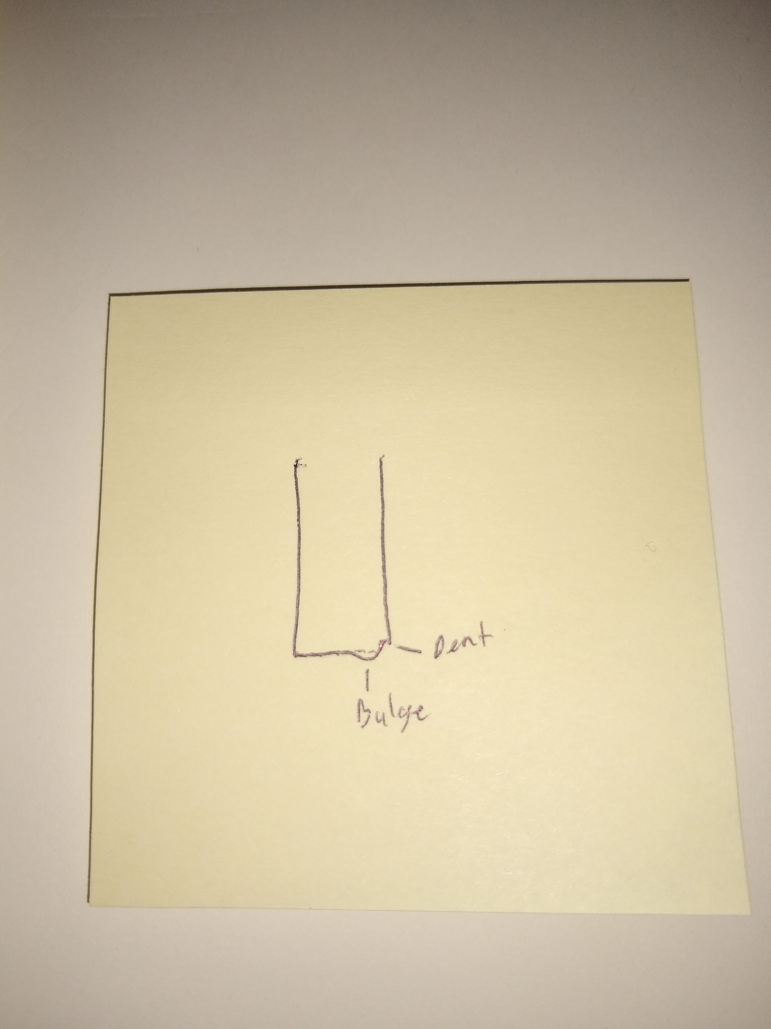

This morning I dropped my stainless steel thermos in the parking lot and it landed right on its bottom edge. It is still intact and functional, of course, but now there is a dent on the bottom edge that causes it to wobble.
Before I take a hammer to it I was wondering if any of you might have some suggestions or advice. I don’t expect to fully restore it, just want to level it out a bit so it doesn’t wobble as much and whatever I do I don’t want to breach the vacuum. Any thoughts or should I just pound away?
Edit: here is my crude drawing of the ding

I think see what you are saying, but I don’t think it will work in this particular case. The problem is that while the corner is dented in, the bottom is bulging out by the dent. I tried to take a picture but I is kinda difficult to capture.
I will bear that in mind if I need to fill in the corner to make it look nicer. Thanks!
Added a drawing of the problem to the original post since it is difficult to photograph.
that’s good news, creased dents are tough to work with so being able to work it back in, as opposed to pulling out, is the best scenario. I would hammer it.
