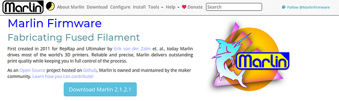

I would have thought the instructions would have asked you to copy the machine specific Configuration.h and Configuration_adv.h files OVER the existing ones in the Marlin/ directory. I don’t know what VSCode does about copying files or if you’re expected to do a full copy and paste of the contents of the files using 2 different editors. I just copied the files using my commandline and because of my commandline use I also had to edit platformio.ini file to generate the correct targets but your MarlinAutoBuild stuff should handle that.
Probably look back at the instructions on how to deal with the custom Configuration.h files, it probably hinted at how to get them into the VSCode environment.
You can’t just make some new random location for them.
You need to overwrite the existing copies in the Marlin/ subdirectory of the Marlin source code release.

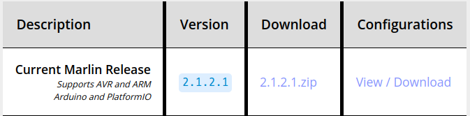

The “Marlin 2.x.x folder” is a release of Marlin.
Click that big button.
Download the 2.1.2.1.zip file.
When you unzip it, you will get a Marlin-2.1.2.1 directory.
Copy the Configuration.h and Configuration_adv.h examples into Marlin-2.1.2.1/Marlin
Then build in the Marlin-2.1.2.1 directory. It should pick up the platformio.ini file in that directory and do the right thing.
You’re almost there, I think, even though it probably doesn’t feel like it. :smiling_face:
