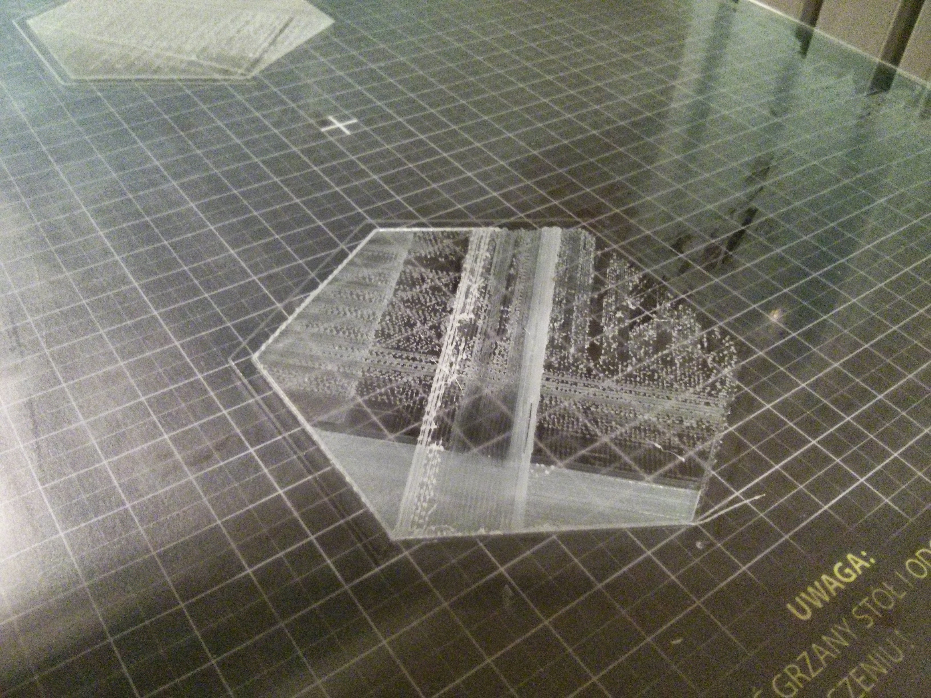

Flat Failed Print Day. Here are 3 pictures of 2 of the failed prints.
Here are 3 pictures of 2 of the failed prints. There were two earlier prints that looked very similar. I have modified the bed height. Changed the nozzle. Increased the flow rate.
Nothing helped.
I cancelled the prints as it just petered out at the 3rd layer. I can’t help but think after 5 months, that it’s the printer.

I think I have heat creep up the nozzle. I have lots of jams where the filament just blocks up. In these prints it just seemed to dry up
So you need to unjam between prints?
If I start printing above the bed the filament comes out. I can’t say if it’s smooth or not, it’s the way it’s always extruded and I’ve tried a variety of nozzles.
I need to un-jam during the print! I could never leave a multi-hour print to run I’d have to un-jam at least twice during it.
You should get a pile of constant size plastic , I expect it dries of as you suggested due to heat soak. Do you have a fan on the nozzel body to help prevent it?
If you print say a 15mm cube does it look ok till it stops feeding?

Rex, I have the same issue and still can’t seem to resolve it. I haven’t been able to touch my printer in a while cause I’ve been buried with work. But your output looks exactly like what I’ve seen where it looks like it’s under extruding or jammed. I’ve completely disassembled everything and checked extrusion rates, etc. And I still can’t get rid of it. My conclusion was just as you mentioned in that it looks like there’s this heat creep up the nozzle cause when taking everything apart, I’ve seen where it appears the filament balls up partially in the extruder, which causes the starving of the extruder. I ended up slowing the printer, increasing the temp, and increasing motor current. Everything that seems count-intuitive.

Initial impression is that the nozzle is too close to the bed and you may be over-extruding. When the filament stops feeding, stop the print and remove the filament. If the filament is straight, but has notches carved into it, your extruder is stripping filament from the back pressure. A quick way to see if this is the issue is to let the print continue for a layer or two (air printing as it goes) and then assist the feeding of filament by pushing more filament into the extruder – if printing resumes, let it run for a while.
