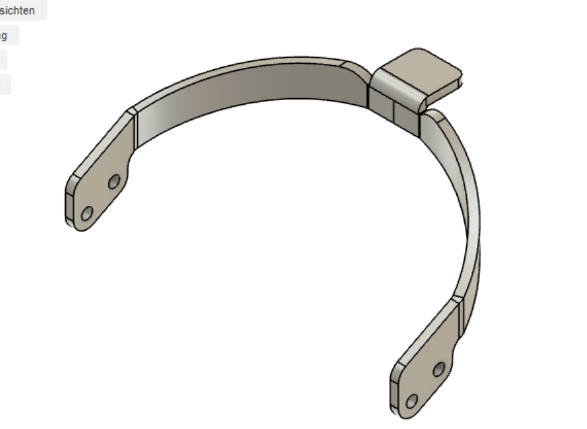

I’m searching for a flattening tool for objects like this:
By now I did this with a Fusion 360 plugin (ExactFlat). That worked pretty good but the licence is way beyond:
ExactFlat for SOLIDWORKS can either be purchased as a perpetual license at a cost of $13,690 USD or it can be leased for a cost of $4,995 USD per year.
With ExactFlat I have to select the inner surface. After that it gets flattened with a couple of clicks.
Is there another way of doing this? I think all the caracter designer do such things on a daily basis.

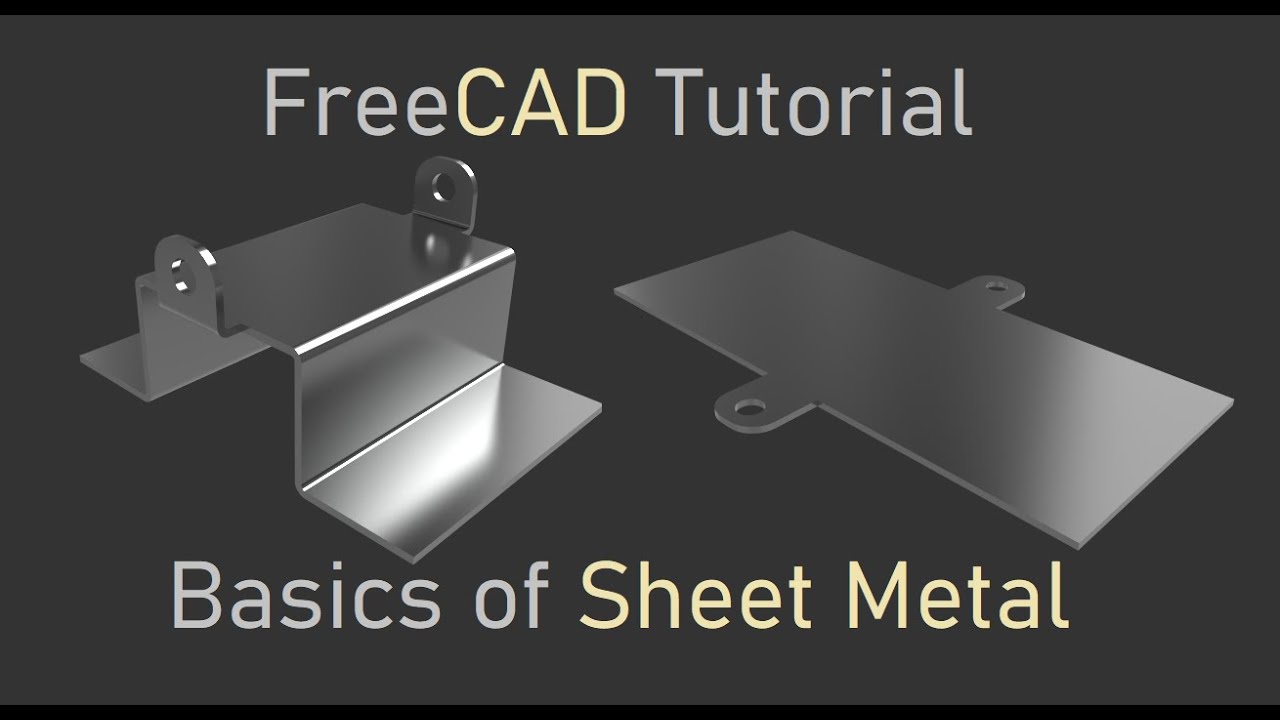

Here’s the beginning of a multi-part series:
Joko’s is a bit older but 0.18 isn’t that old yet.

This part was designed with Fusion 360. No big deal: Just two bends and that’s it (for prototyping I often use acrylic and do the bends with a hot wire bender). And no, I did not use the sheet metal functions. Why? I don’t really know… :wink:
Today I exported the part as a step file and loaded it into FreeCAD. The flatten function worked just perfect and the sketch itself is nicely structured (outlines, cutouts and bend lines). Wow! :slight_smile:
So let’s get back to my initial job:
Unfortunately, this part can not be flattened (it’s not a regular bend). Then I tried to unfold it like this: https://www.reddit.com/r/Fusion360/comments/mle7lc/how_to_flatten_3d_objects_to_2d_for_cutting_and/gtkwnol/?utm_source=reddit&utm_medium=web2x&context=3
But somehow the function “Unwrap mesh” is not available. Hm, I got stuck…

Huh. Is it because the curve is a spline, or because the thickness varies?
Wow, nice find! Glad that worked for you!
Correct, It’s a spline. The thickness is equal.
