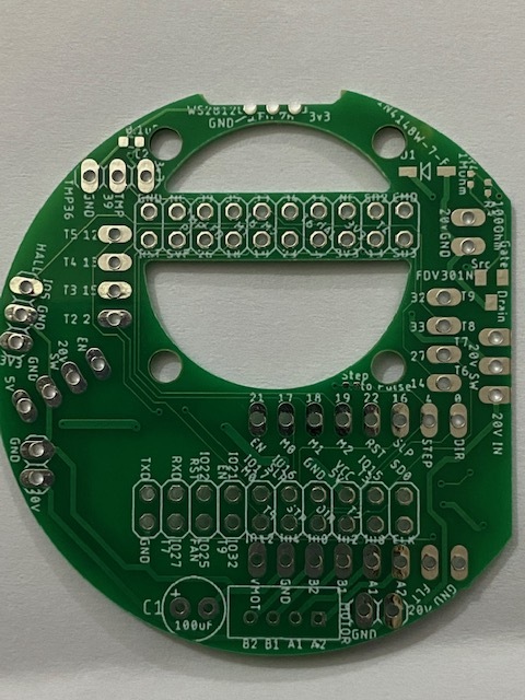

Do I need to get a 0.0 ohm surface mount resistor? If yes where it should be mounted exactly? Thank you.
No, you do not need the 0 ohm resister. The copper is connected there already. It’s only if you cut it, that you would need the 0 ohm resistor to reconnect. It’s the loopback signal to count steps while you’re jogging via pwm signals. The loopback should eventually be possible via software settings of the esp32 to do internal loopback, but i’ve never been able to figure out how to do that confi yet, so just doing a hard coded loopback to do step counting.

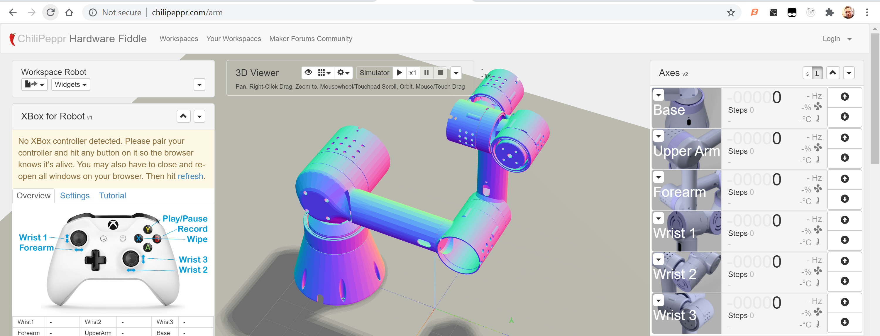

The way to access the workspace is at http://chilipeppr.com/arm and a screenshot is below, however, this is still quite the work in progress and I would say it’s not there yet. The concept I still love and I think this could work, but I’m getting really busy with work and thus have not had good progress in a while.
What would be awesome is if others wanted to run with it. I am staying very involved in any feedback and trying to reply quickly, so in that respect I’m highly engaged. And, the code for the actuator is at a spot where it does connect to the ChiliPeppr workspace and you can send/receive commands in the Axes widget to control the actuators.
The next step was to let you hit record to store the actuator positions as a line of Gcode. Then once you’ve recorded all of your positions let you play them back in order. The key, though, would be to let you pause at the correct moments, or delay movements, or add speed elements. The thought was to let you write macros, since there’s already a really nice macro widget, to control the logic. Macros are just Javascript so they could even make Ajax calls to the web, etc.
Indeed the goal was to bypass ROS because I, too, found ROS so cryptic I couldn’t get anywhere with it. I think being able to control a robot arm from a browser, visually see it, and write Javascript to control it would be game changer. I’d love the help.
