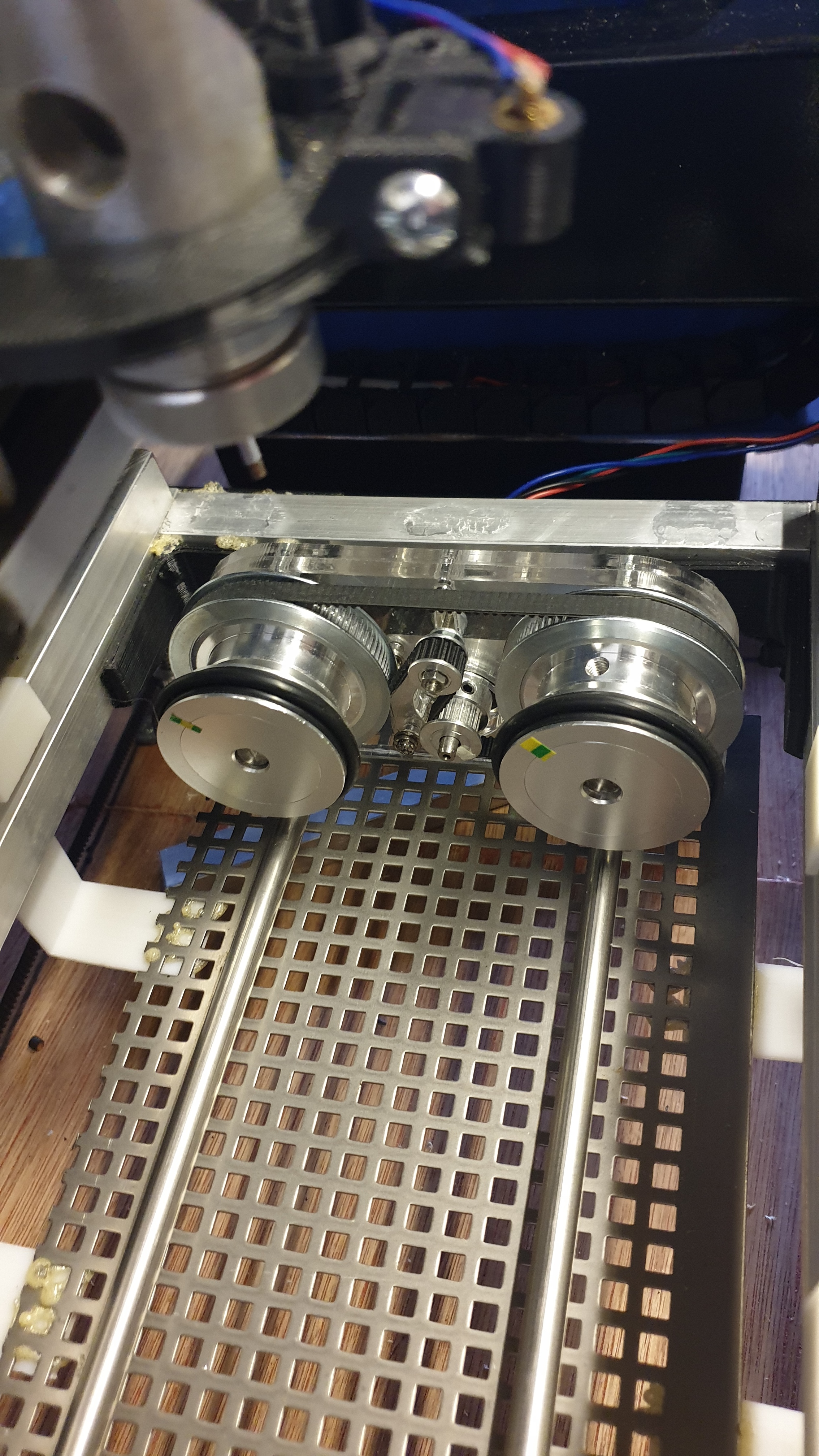

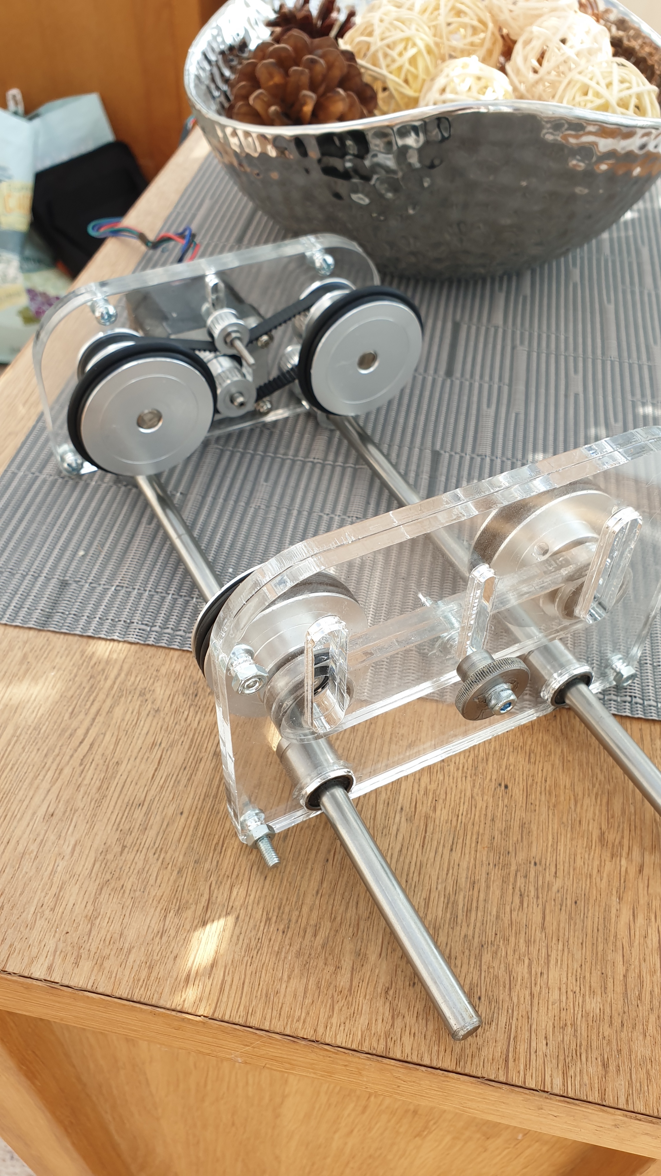

I’ve just built a rotary for my K40 :

So - I’ve been playing some more - and realized something important.
When I built the rotary, I didn’t consider the gear ratio’s at all. My engravings came out with quite obvious gaps in the Y axis :
The T2 timing wheel on the stepper and the drive wheels were the same size, but the wheels the glass rested on were bigger. So I was losing resolution in the Y.
I kept the stepper timing wheel the same, and added 50 teeth T2 to the drive wheels and things improved slightly, but still not as good as I think it can get.

My 400 step nema 17 hasn’t turned up, but my 60 teeth t2 timing wheels did :
So I installed them on my rotary and made a new timing belt. It takes just over 5 revolutions of the stepper to rotate the 60 tooth wheel once.

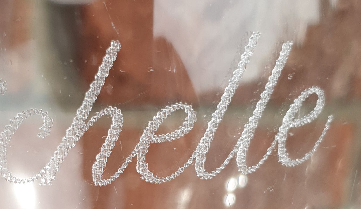

I’ve just made a set of glasses (I’m showing off, but hey), look at the detail here :
This SVG is 20x20mm
