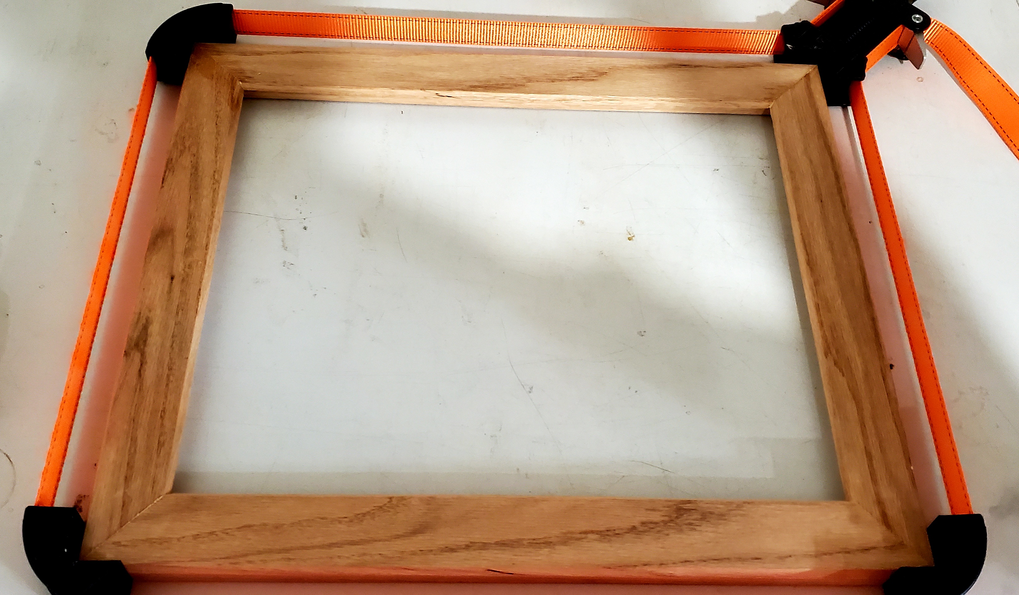

Here is progress photo one (cut, glued):

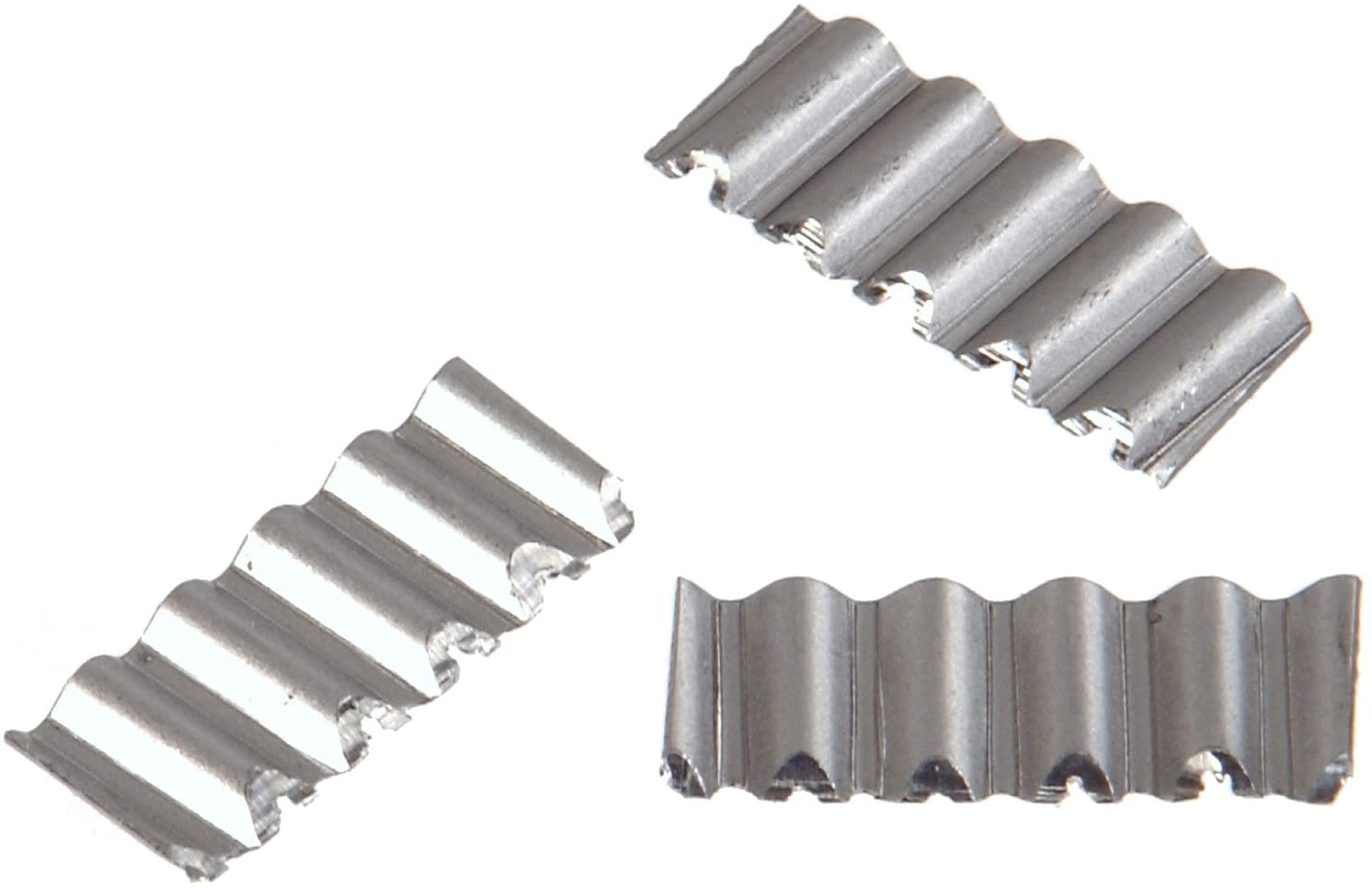

You can use corrugated joint fasteners like these to strength the joint. Just hammer them in on the backside.
How well do those work with oak? I can’t imagine them working with white oak, but even red oak I’d be skeptical until I saw it proven… :slight_smile:
True, haven’t tried them with oak before. Personally I’m a big fan of splines usually.
Corregated fastner… Not!
Glue won’t hold on end grain.
Go with splines. Any of those woods will look ok if you change grain directions. I would do cherry.

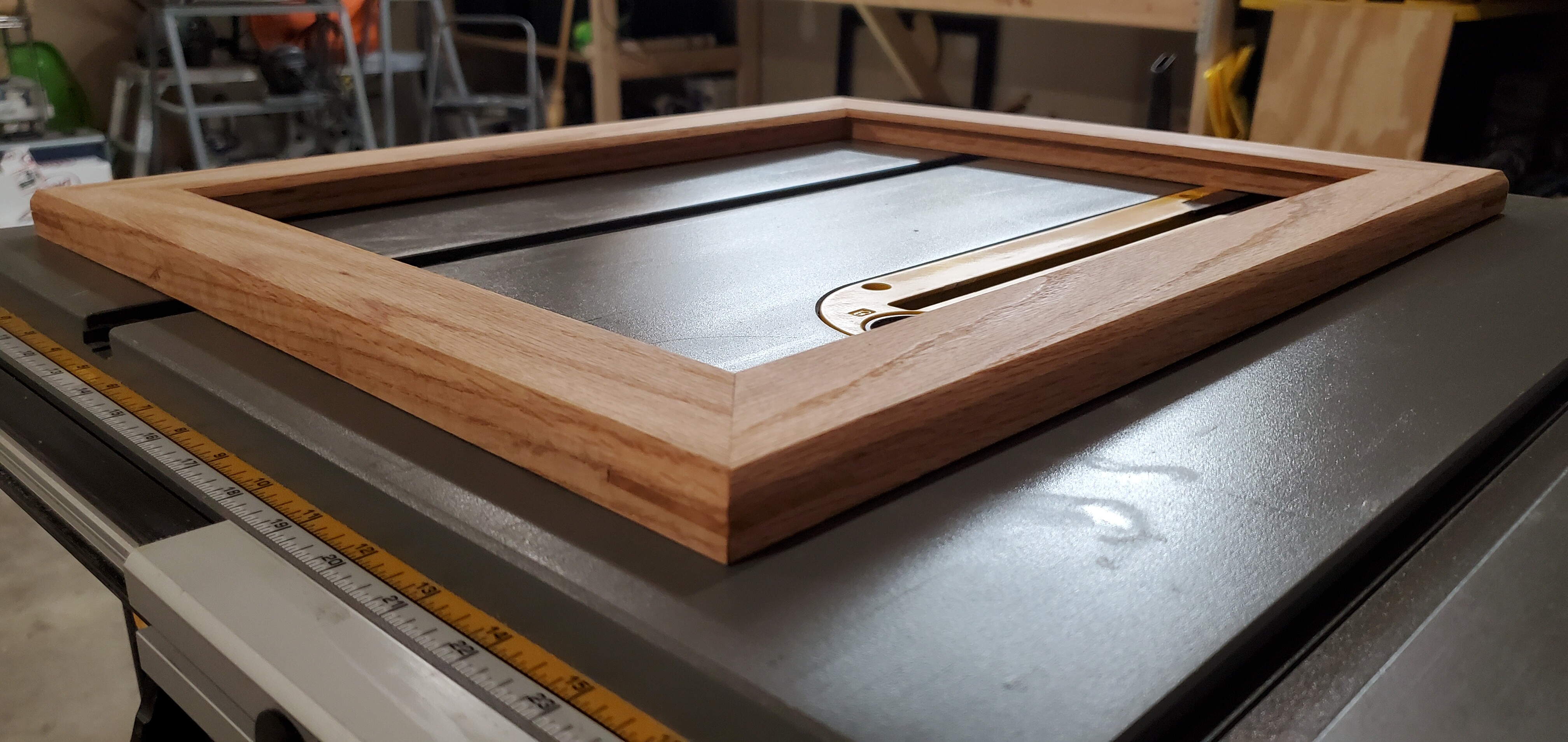

Clamp removed, splines glued into place, sanded, cleaned with mineral spirits, finished with BLO.
Photos before BLO:
Looking good!

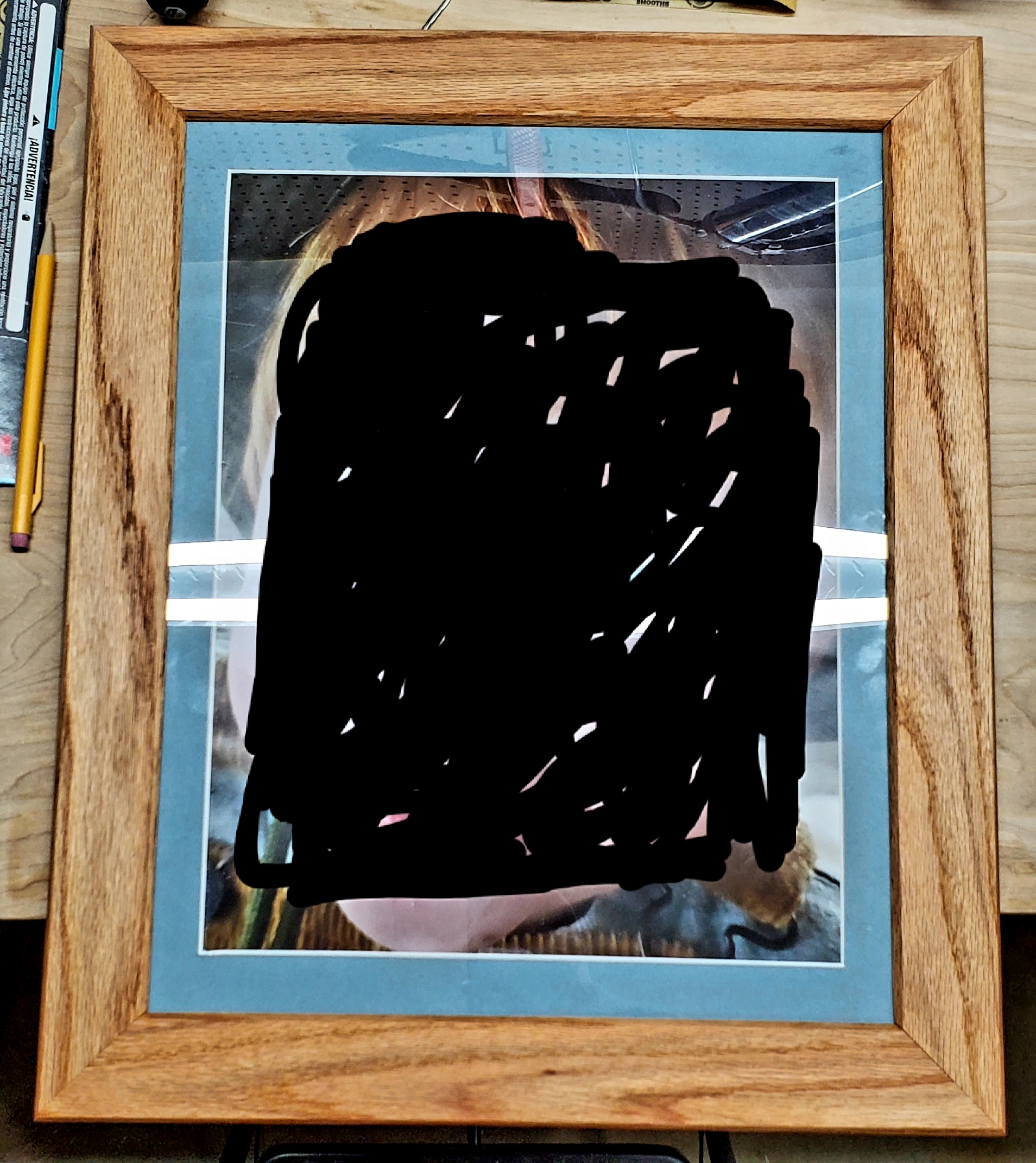

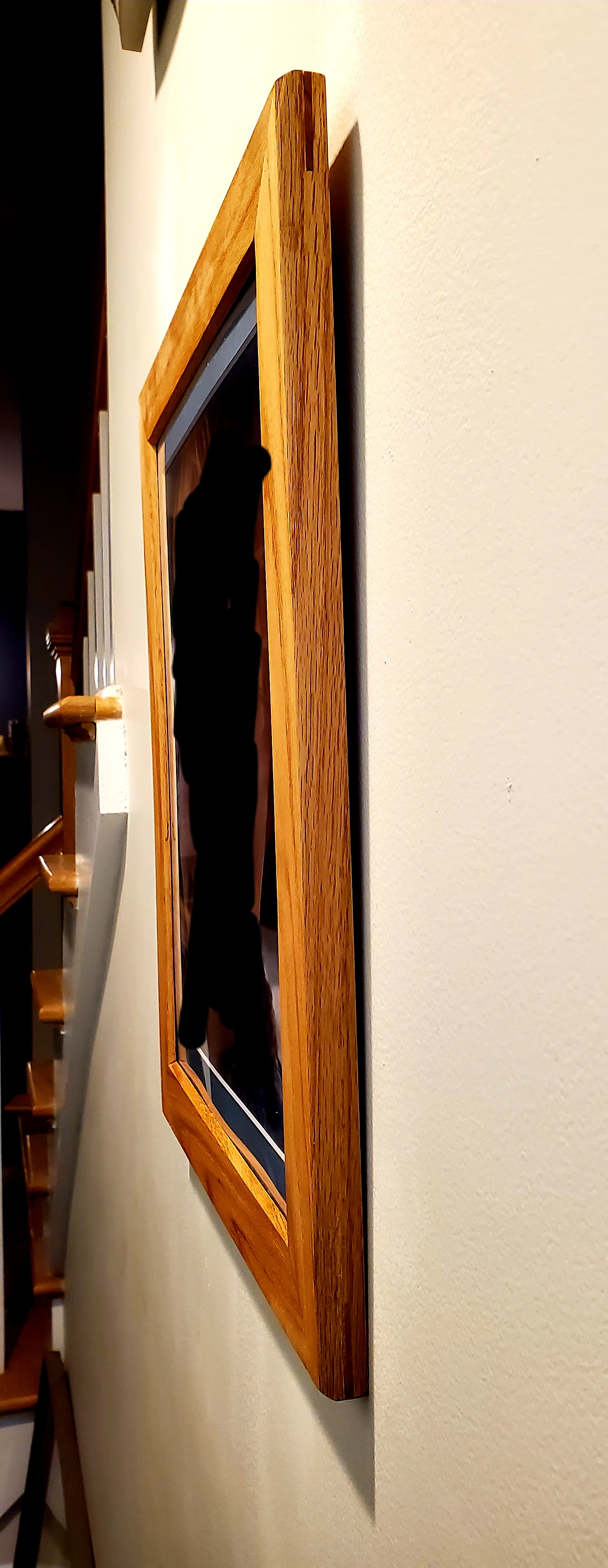

It is done. Matted the photo and got everything in the frame.
Chrisp, clean joints looks amazing.
What wood species did you use for the spline?
Thanks, Don.
The splines are cherry. I bought two thin boards from Ocooch a couple of months ago and they have just been sitting around since then.
