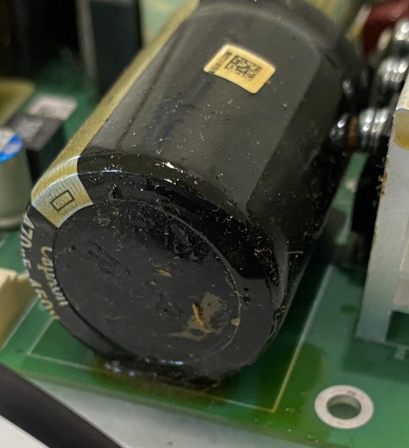

Thanks for the input. I think this capacitor might be leaking fluid. Any thoughts on this?
Perhaps but I would think that a leaking cap would not stop the machine from turning on.

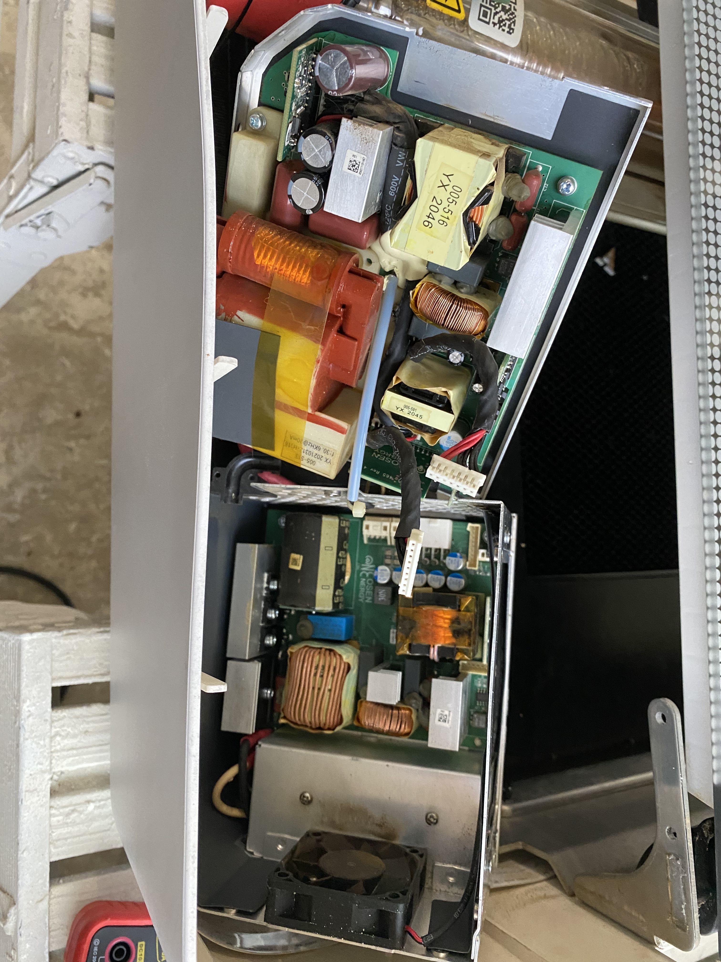

Can you provide a picture of the supply zoomed back?
How do you know the supply is bad did you test its output and input?
I am reading AC voltage into the power supply but no DC voltage output to the motherboard
That looks like conformal coating and I can see some also on the heatsink corner next to it.
Vendors conformal coat PCAs to protect everything from environmental contaminates since often cooling air is unfiltered and in consumer spaces can contain all kinds of ‘stuff’.
The capacitor looks fine to me.
$0.02 - that top section looks like the high voltage section which drives the tube since it looks to have a flyback xformer on it. The bottom section is probably the low voltage section. Hard to know what kind of feedback or controls the HV section might have on the LV section. ie if HV dies does it shut down/disable the LV section. If anyone else has looked at a working system and seen the LV section still powering up with the HV section disconnected(as you have it) then that would tell you if you can find voltages on the LV section when turned on.
Are the connectors hanging out of the HVPS connected to the LVPS??

Not sure why the LV section would be interlocked with the HV supply unless:
  • The lv supply is used to power some of the HV logic control functions.
  • The LV supply retrieves interlock states
I would pull out the LVPS and see if model #'s and such can be seen anywhere.
We could also get a closer view of the interconnects and components.
The LV supply looks like a standard switcher design.

Yes the “HV” has an input and an output back to “LV”.
And the “HV” has an output to the “motherboard” at the very top of the picture but it appears the motherboard is not getting power. That is why I believe it is a power supply issue. Even the fan on the power supply does not run. Nothing happens when it is plugged in but a buzzing. I will take more pictures when I get home.
