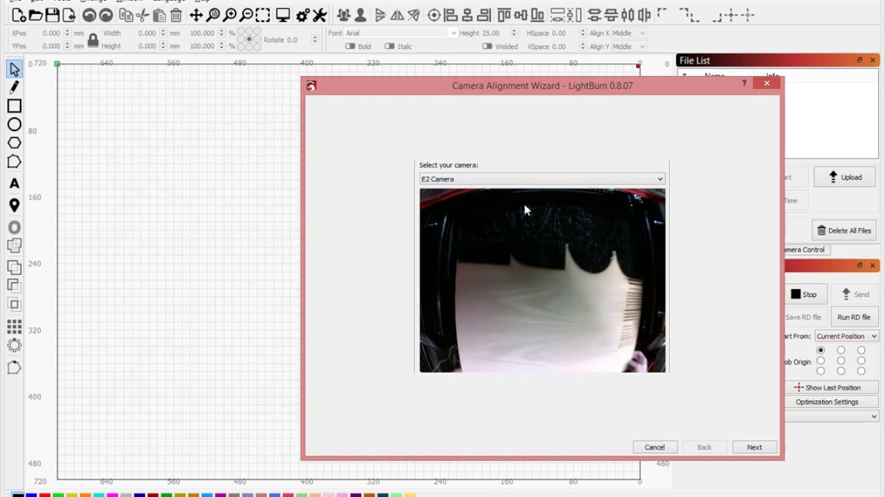

If you do use LightBurn software, they have an option to use a camera for positioning. It is very accurate and easy to use. It attaches to the lid of the laser, not on the head.
If you go to about the 16:20 mark, you can see what a camera is good for. :wink:

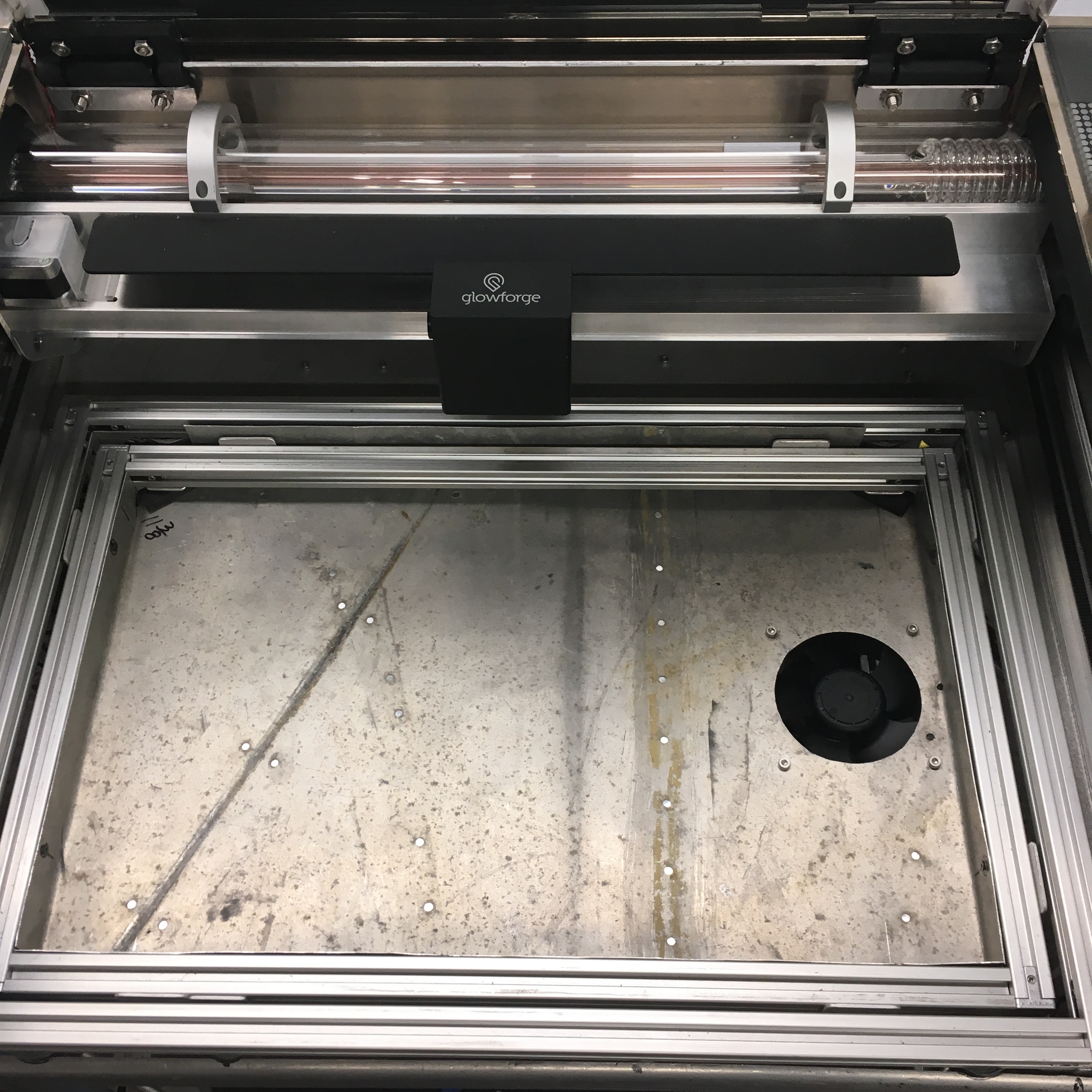

With a crumb tray / fume extraction finally designed and in place the machine can be tested more robustly.
The standard Glowforge fan has great suction and pulls a warped piece of cardboard down to the honeycomb very well but the 13,000 RPM - 74dB is more noise then I care for.
Changing to a whisper quiet bathroom fan is on the update list.
Material for the crumb tray is .025" aluminum recycled from a streamlined bicycle project.
Notice the fan is offset to the right in the picture and centered in the .pdf.
Of course I learned straight away that centered is the preferred position :slightly_frowning_face:
crumb tray.PDF (20.7 KB)
