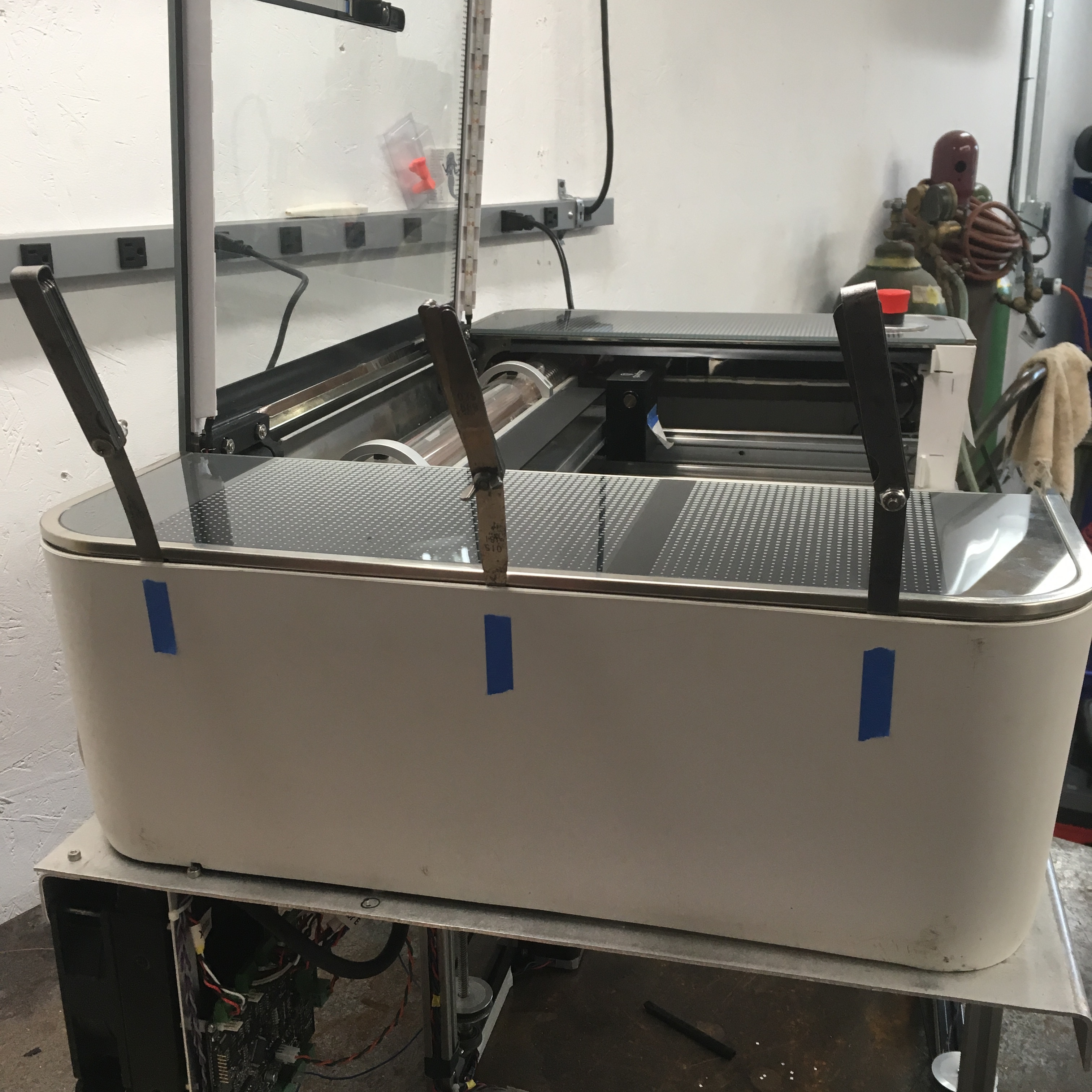

A tip for removing the top panels.
They are held in place with a “blind” latch hook.
Undoubtedly there is a special designed tool to reach in thru the open lid to release the latches.
Pushing thin feeler gauges into the gap between the top and side works fine too.
Blue tape in the picture shows the approximate location of the latches.
To facilitate easy removal during the build process the “hook” part of the latch was sanded off.
An edit to mention … double sided tape is used in many places on the machine.
Examples are cabling to chassis and outside enclosure to chassis.
Have a heat gun at the ready to warm a tape area which eases the removal process.

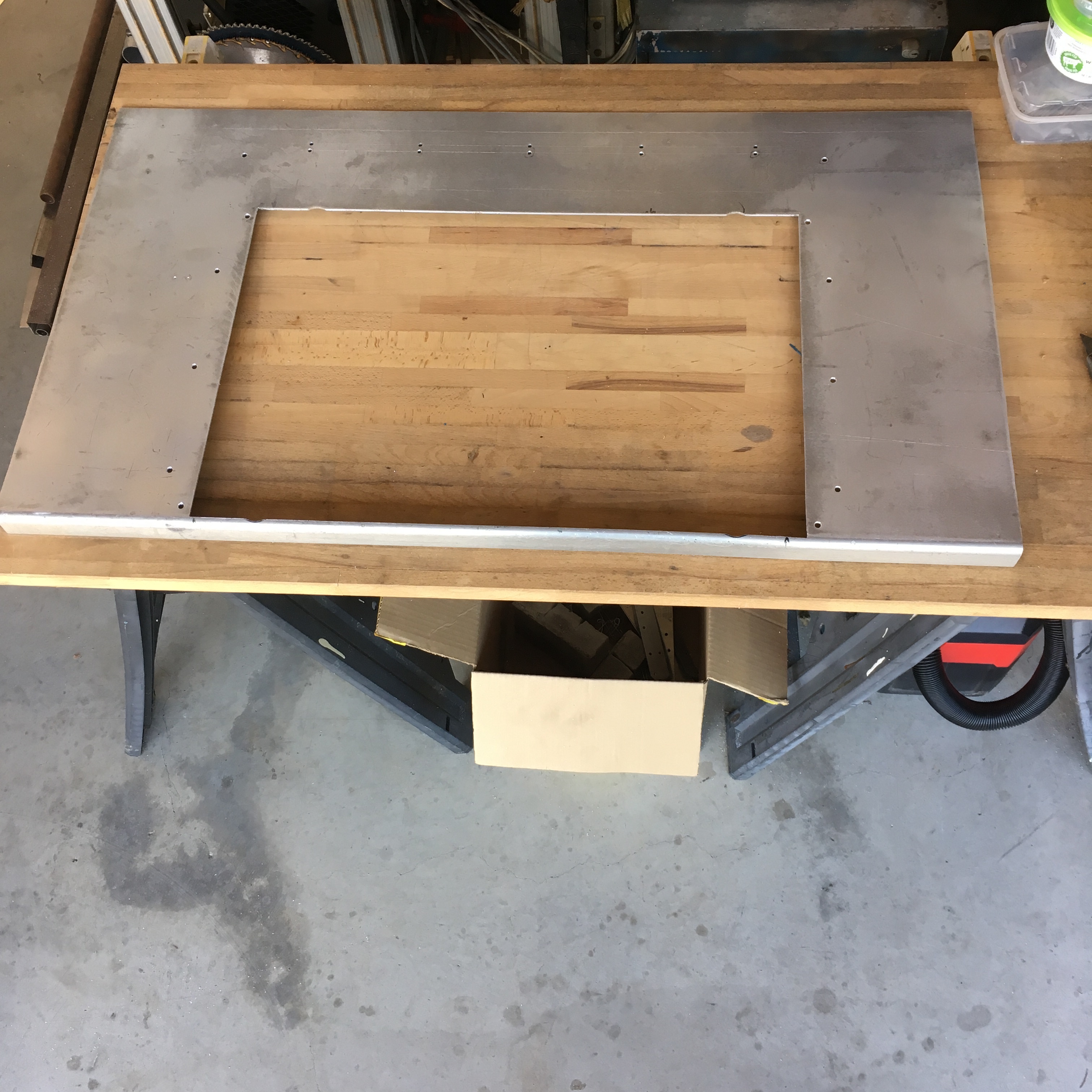

Once the original chassis was removed from the plastic case it was mounted to an aluminum sheet.
This sheet was salvaged from a Grumman box truck project.
A plywood sheet could be alternative material choice.
The attached .pdf drawing shows the cut dimensions in mm.
93mm dotted line to internal opening sets the distance to the rear bolt holes of the chassis.
The original plastic case was laid on top of the aluminum sheet and used as a template to mark the holes.
I drilled the holes first and then made the internal cut second.

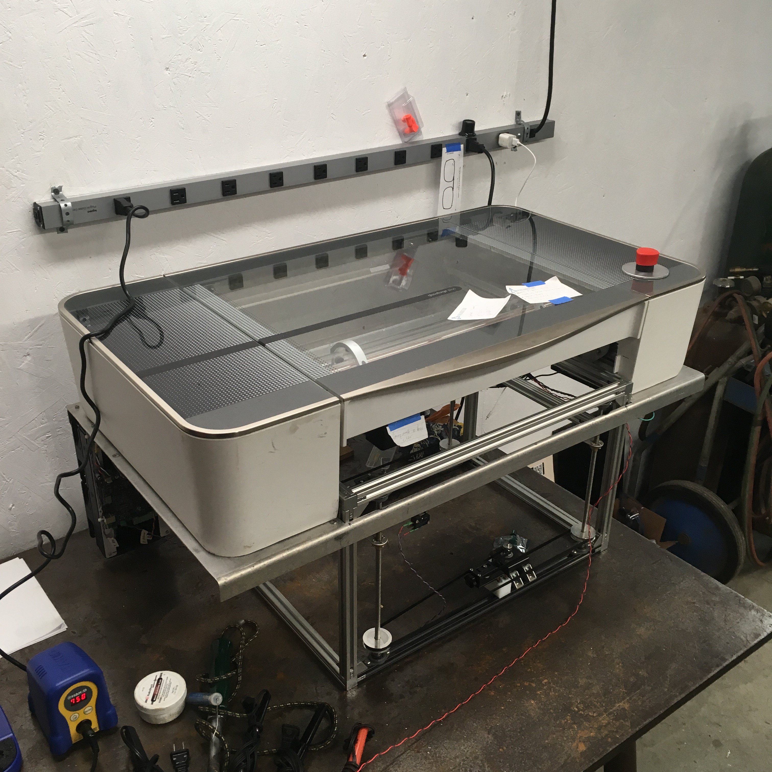

BTW … FrankenForge is running.
There will be some questions for the forum towards the end of this build log. (final tune questions)
Starting the build log now before the cabinet is built so I have open access for pics and measures.

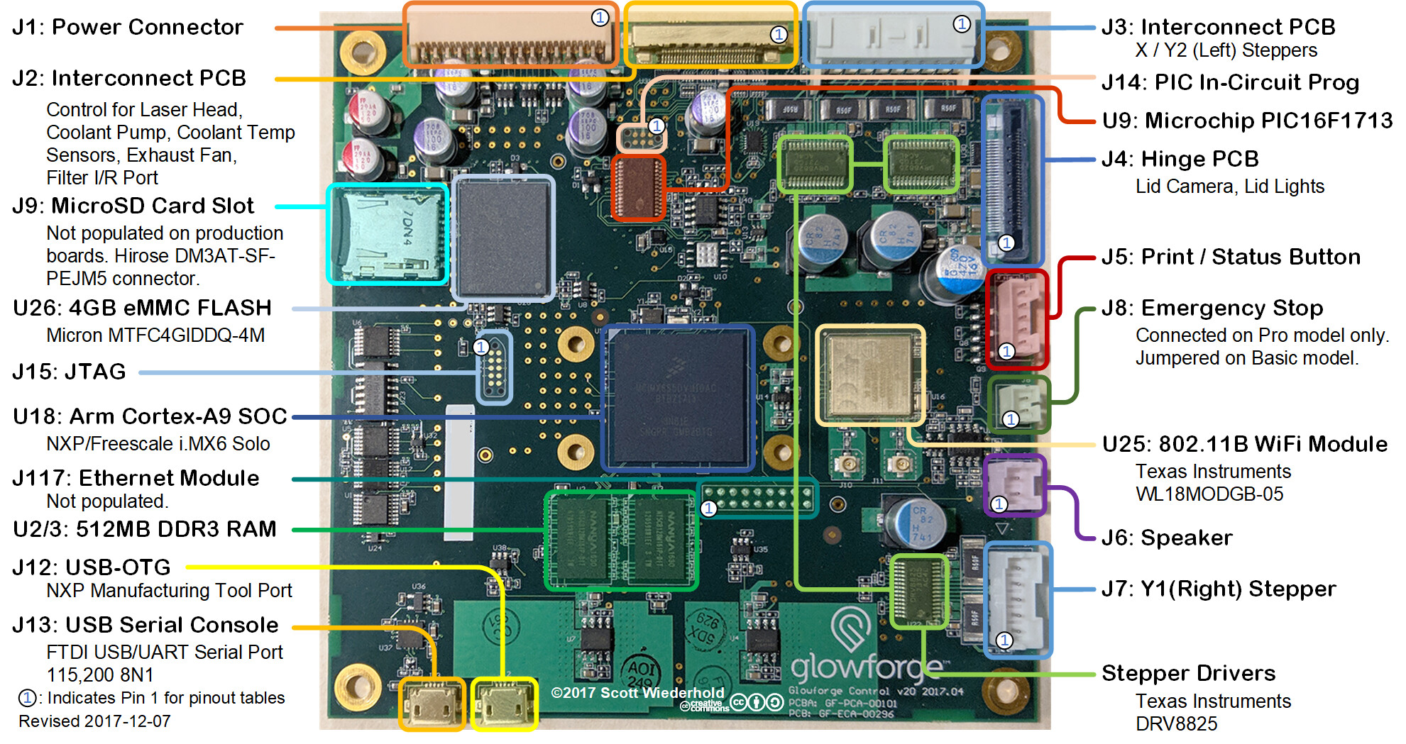

An edit to add this Glowforge control board overview.
Note connector J1 in the top left of the picture.
The ribbon connector that feeds to the LPU.
This is what makes the power supply proprietary.

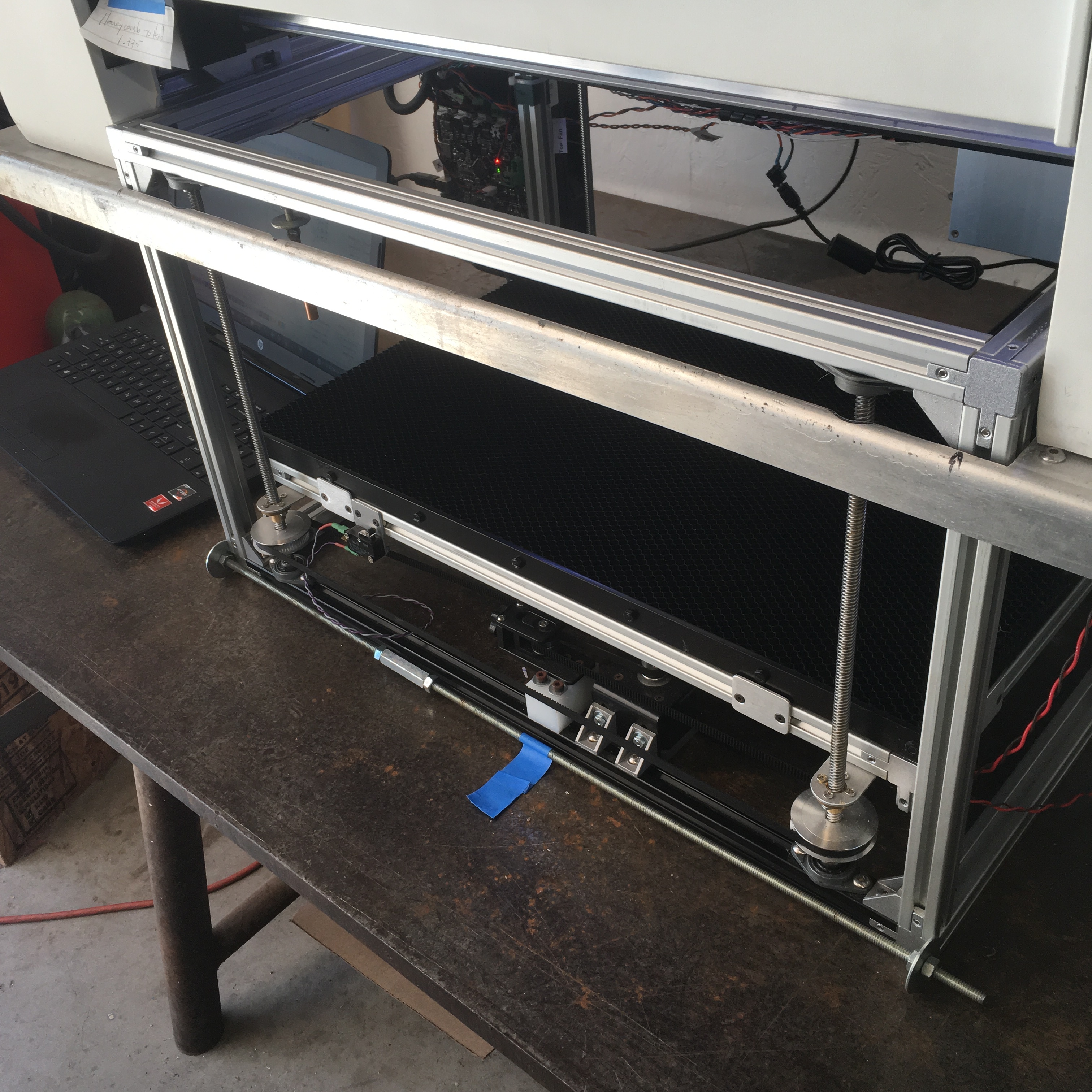

Attached .pdf shows the bed tray dimensions.
Document includes the outside dimensions and material cut dimensions with appropriate subtractions for the end connectors.
Honeycomb bed is salvaged in it’s original size so the bed tray is built to fit with a little extra gap.
Total “Z” axis movement is 250mm.
Note the threaded rod with blue tape attached.
This is a helpful simple tool used to keep the sides / dimensions parallel.
Once the tool length is locked the extrusion couplers can be held against the tool’s washers and then tightened.

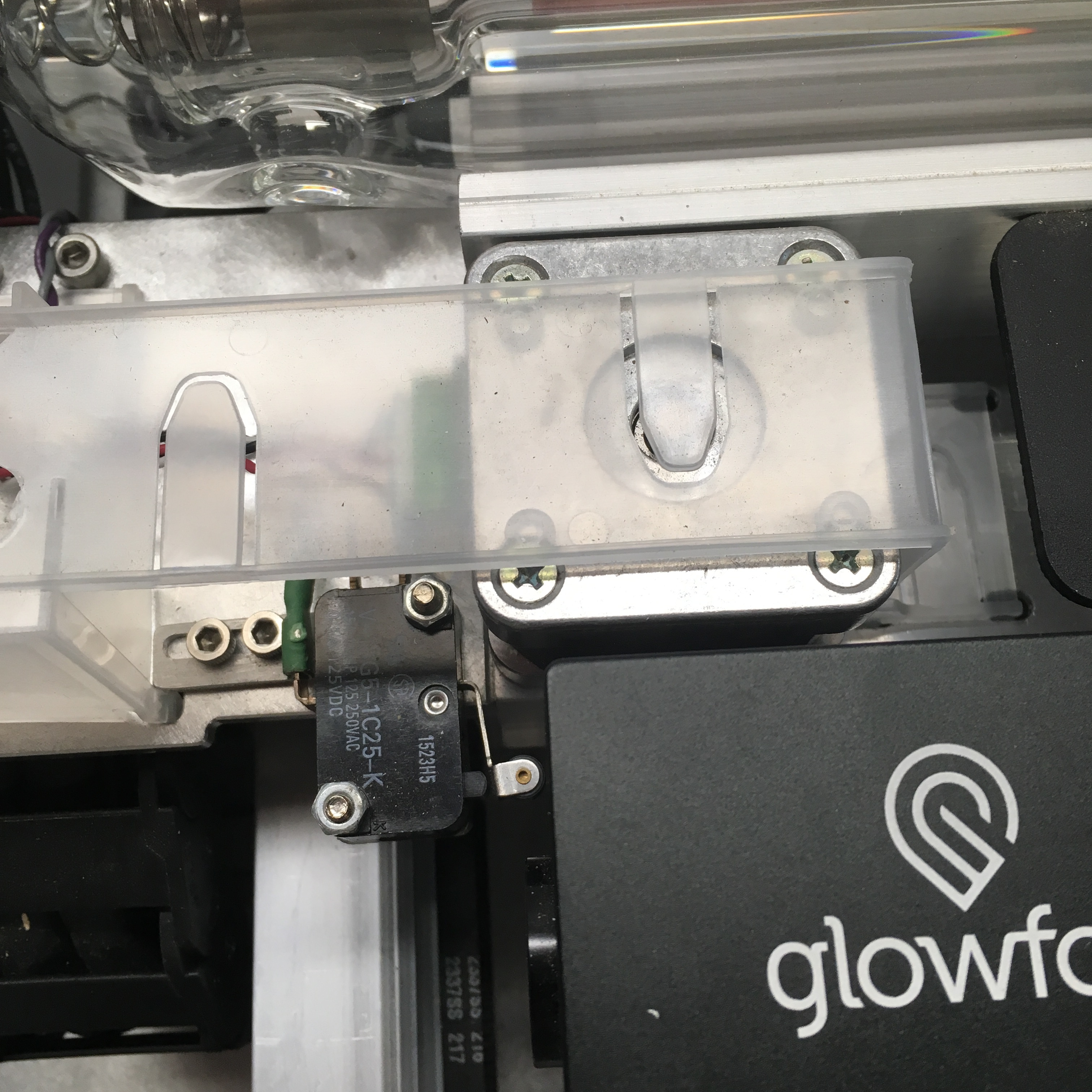

Today’s post shows the limit switch locations on the machine.
The “X” axis switch is mounted on the left side of the gantry where it can be activated with the cutting head.
Maybe not the most ideal as when the head is removed for cleaning there is nothing to strike the switch. So don’t home with the head removed.
The “Y” axis switch is mounted on the front right side “Y” axis rail where it is activated by the pulley wheel bolt.

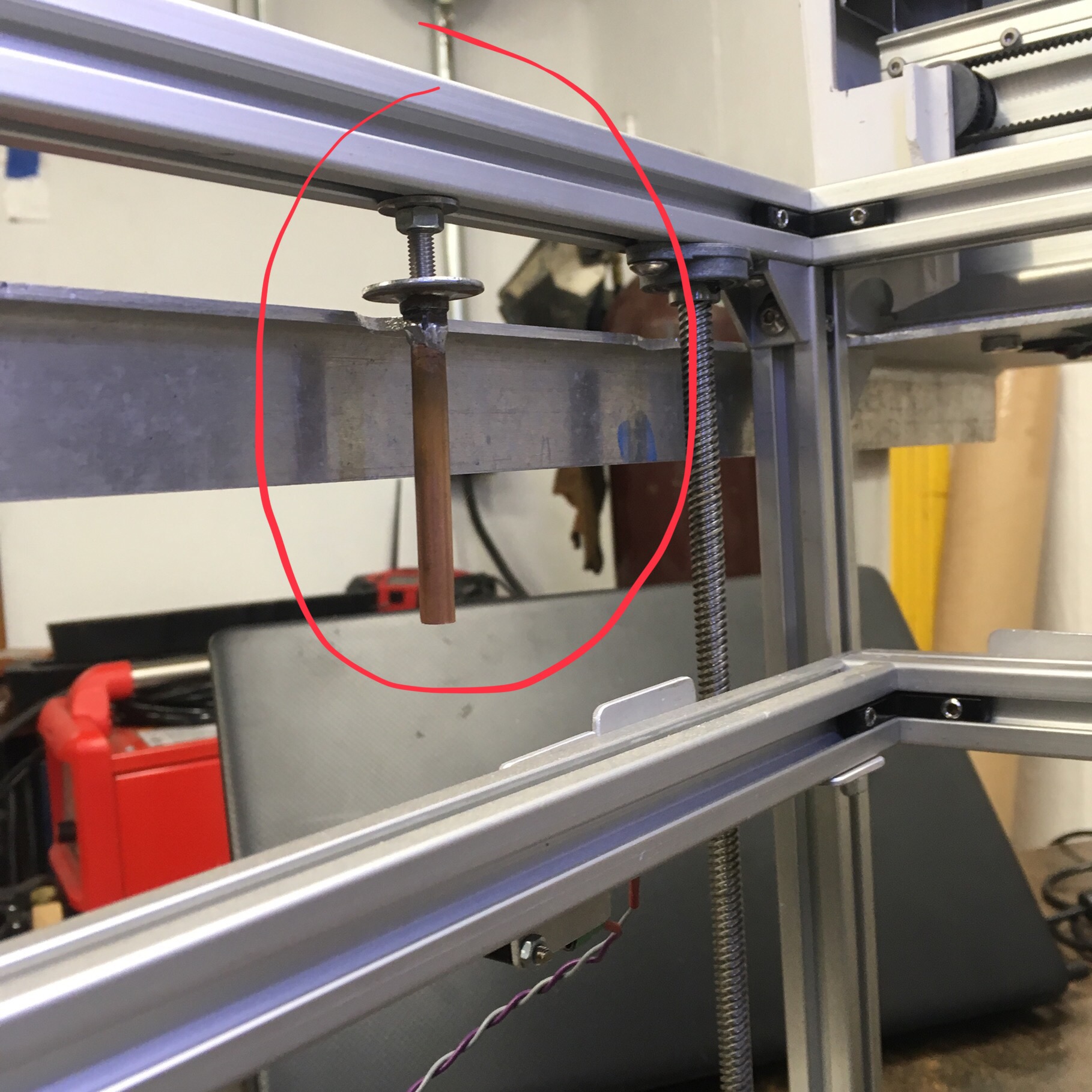

With the “Z” axis being the major change to the design I thought it best for it to have an adjustable height switch.
It is mounted to the front but due to the adapter plate is a bit hidden and harder to show clearly in pictures.
The bed is moved down and honeycomb removed in an effort to be more understandable.
The switch strikes a fender washer soldered to a nut and copper tube.
Adding the copper tube allows easy access to adjustments.

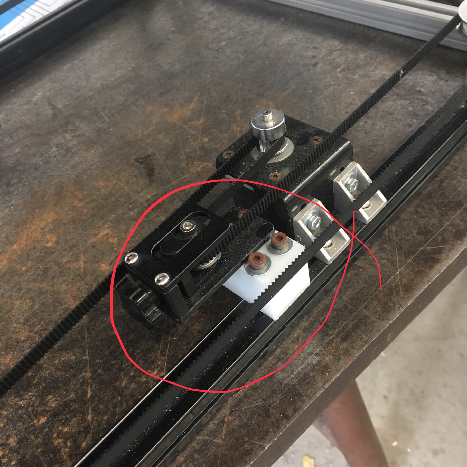

This post is wrapping up the chassis details before moving on to the electronics.
The belt tension / idler assembly needed a riser block to match the height of the motor pulley.
These are made from white UMHW plastic although any other material will work.
See attached .pdf for dimensions.
Idler Riser Block.PDF (14.9 KB)

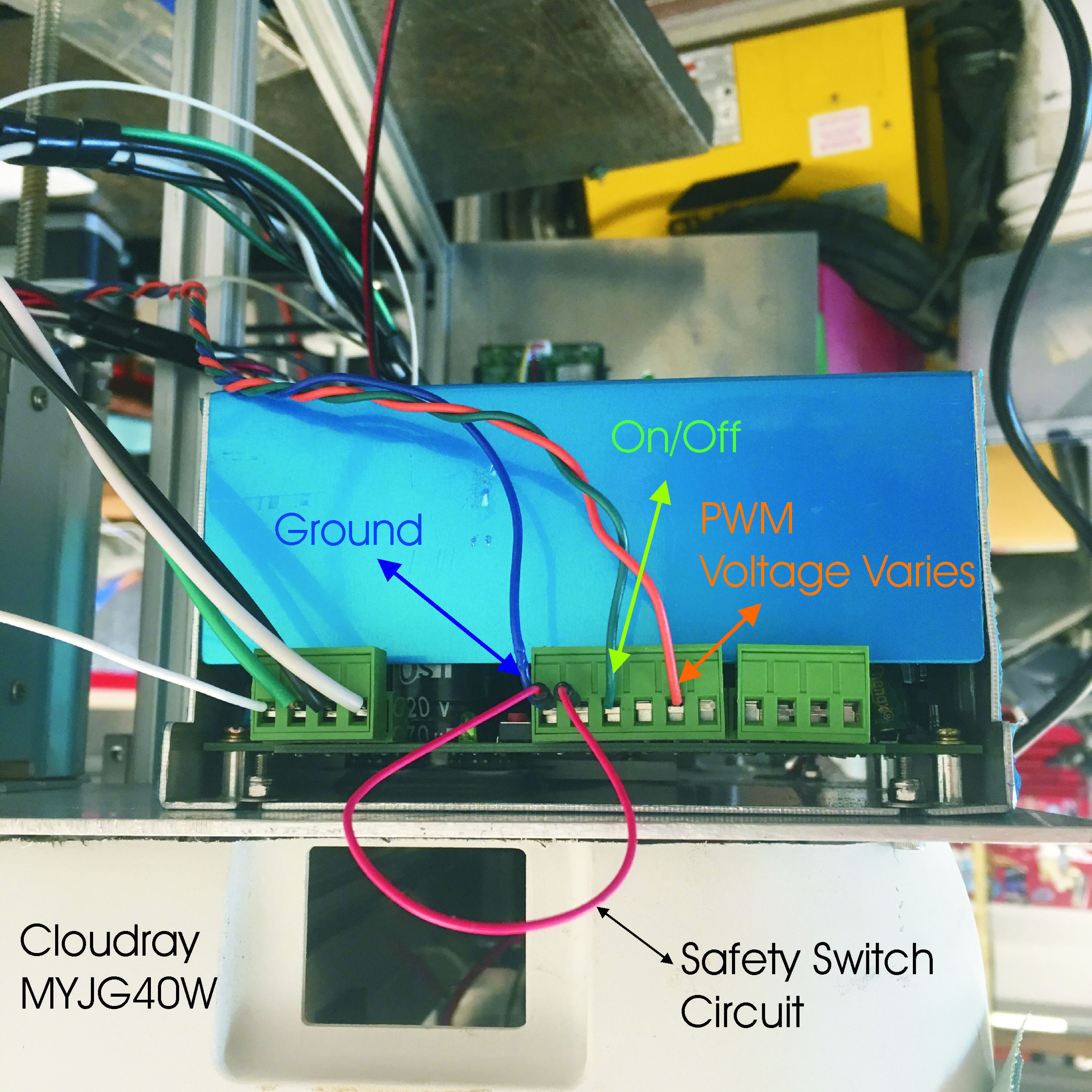

Pin configuration for the laser
smooth-laser-hook-up.pdf (743.0 KB)
