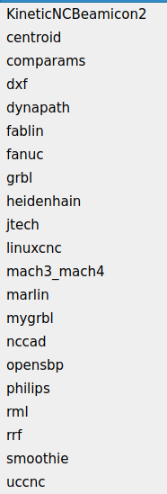

Here as the posts available in Path in FreeCAD 0.20 — except for “mygrbl” which is my own local hacked copy of the grbl post.

Or did you modify the LinuxCNC post to take g2 / tinyg options? I don’t see anything in FreeCAD/linuxcnc_post.py at master · FreeCAD/FreeCAD · GitHub — does the linuxcnc post just work, maybe with some general arguments?
I don’t know about laser diode support in post.
I use UGS and Candle as senders.
